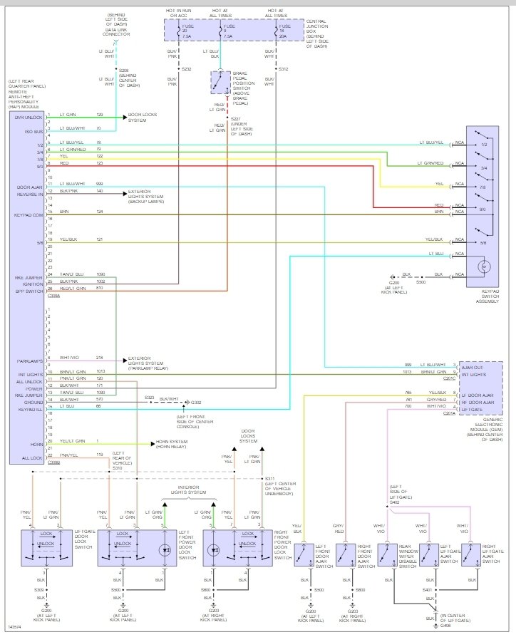

When I push on keyless door lock or unlock the door locks turn on off over and over won't stop till I pull fuse out
Apr 22, 2016 at 11:48 AM
  • 54,832 POSTS
Hi CARRIE EASON,

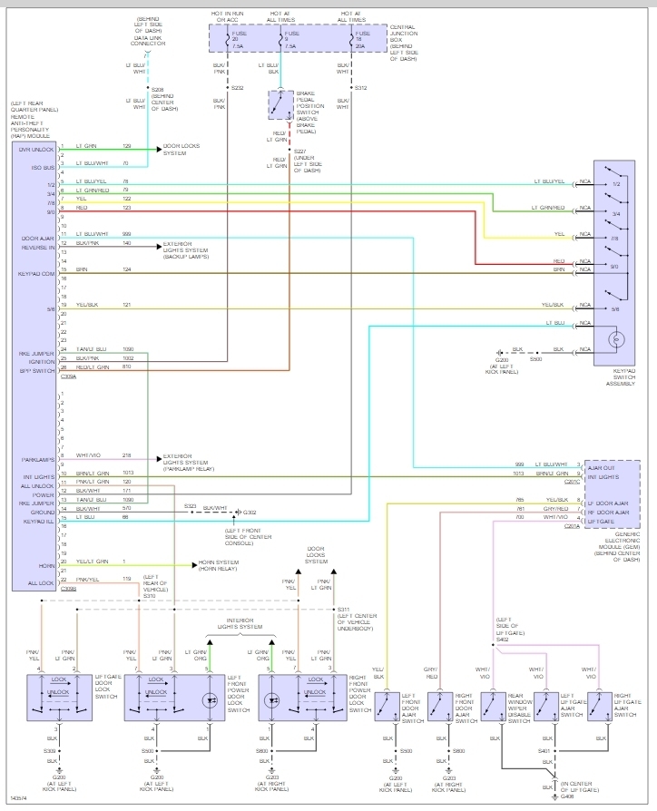

This is a anti theft computer module problem which is common with these vehicles, here is the location and wiring diagram to help, please let me know what you find out
