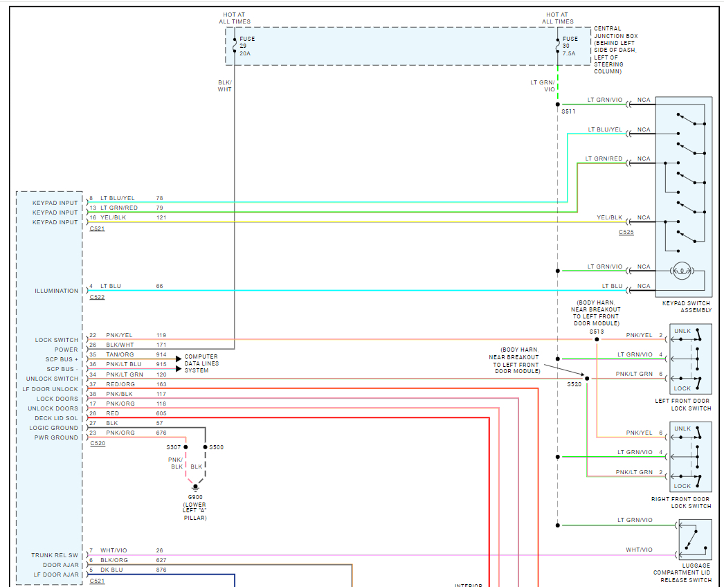

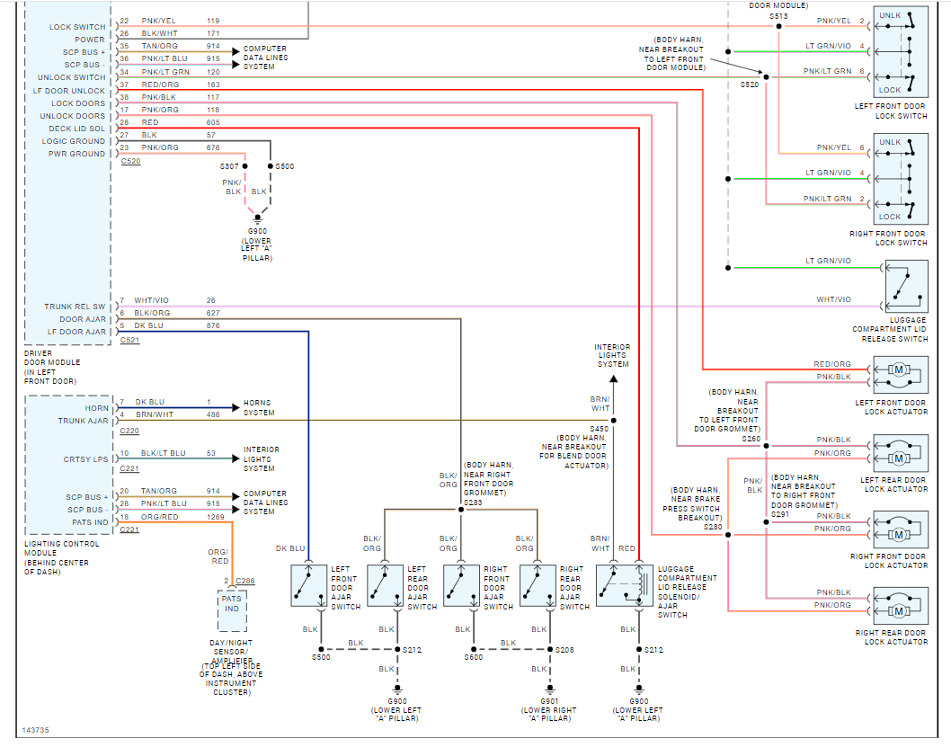

Doors will not unlock with door switch but will with key fob. Also, the keyless entry does not work, switch has voltage and check good.

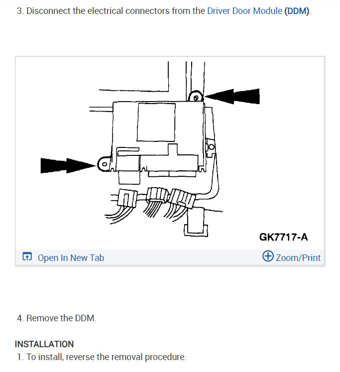

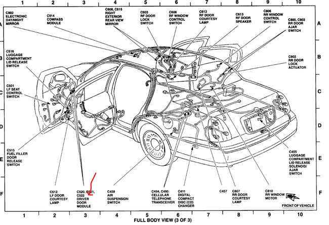

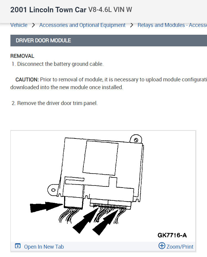

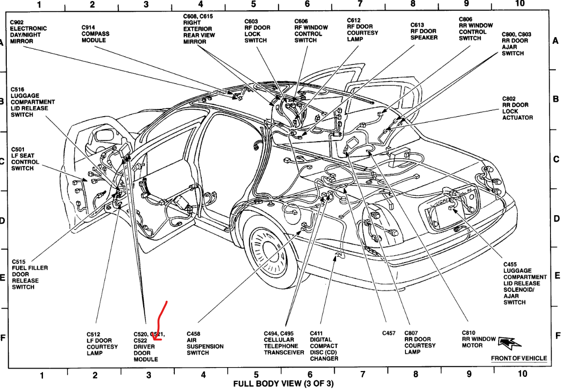

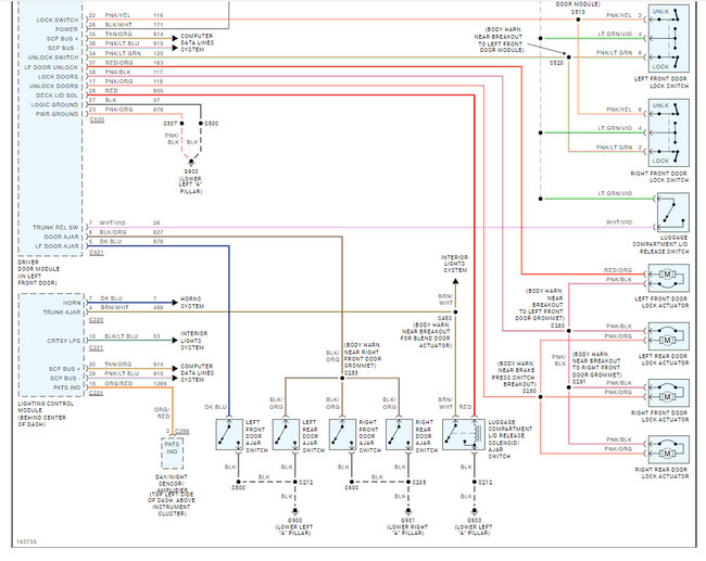

It sounds like the door's door module has gone out. But we should check the power and grounds. here is a guide to help and the door lock wiring diagrams so you can see how the system works. Please check fuse # 29 and #30 in the fuse panel on the left side of the dash.
Check out the images (below). Please upload pictures or videos in your response to the problem so we can see what's going on.
