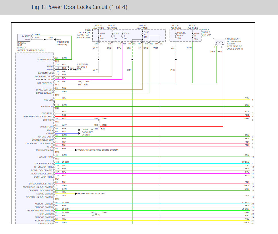

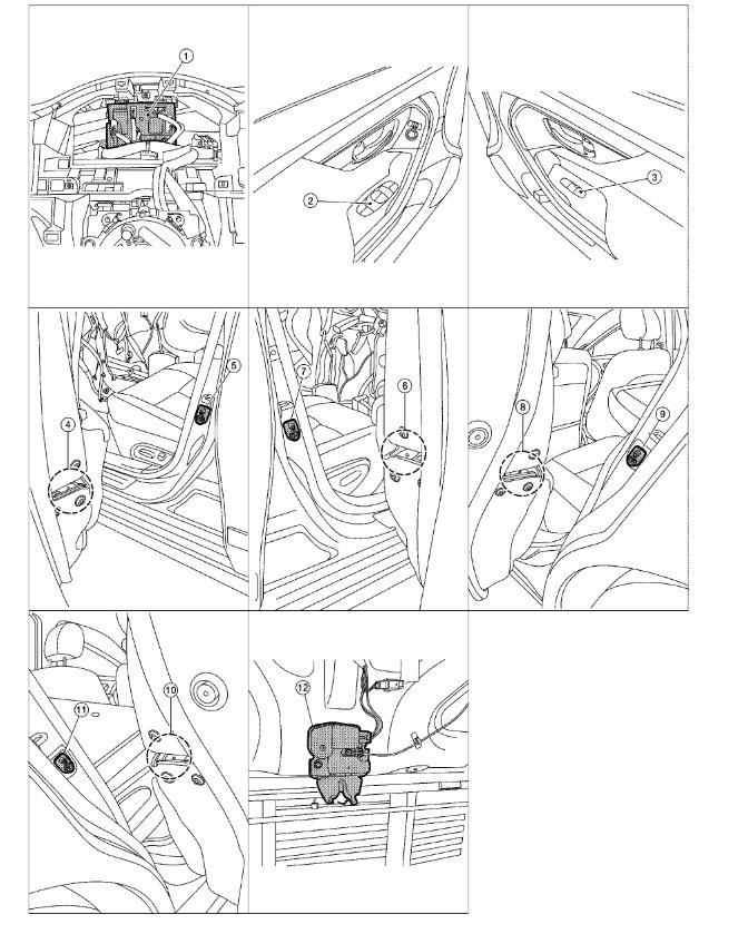

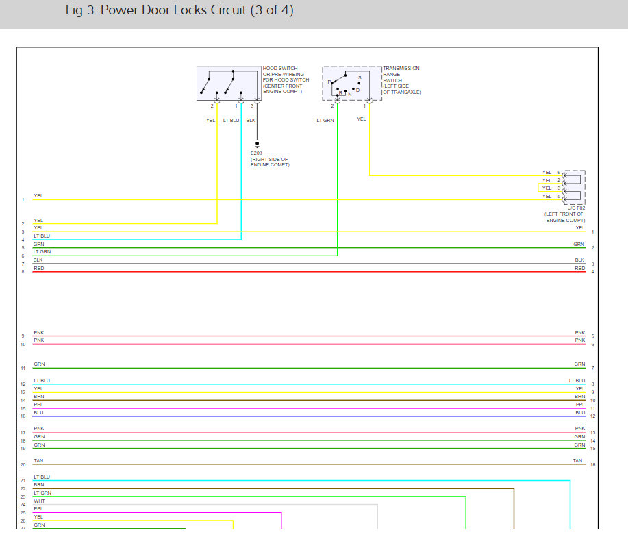

Every time i try to even put a fuse in it burns it out. wont even let me finish putting in. i think it’s a short to grown, but where? I am not sure. what do you guys think?
Oct 29, 2019 at 8:21 AM
  • 55,694 POSTS

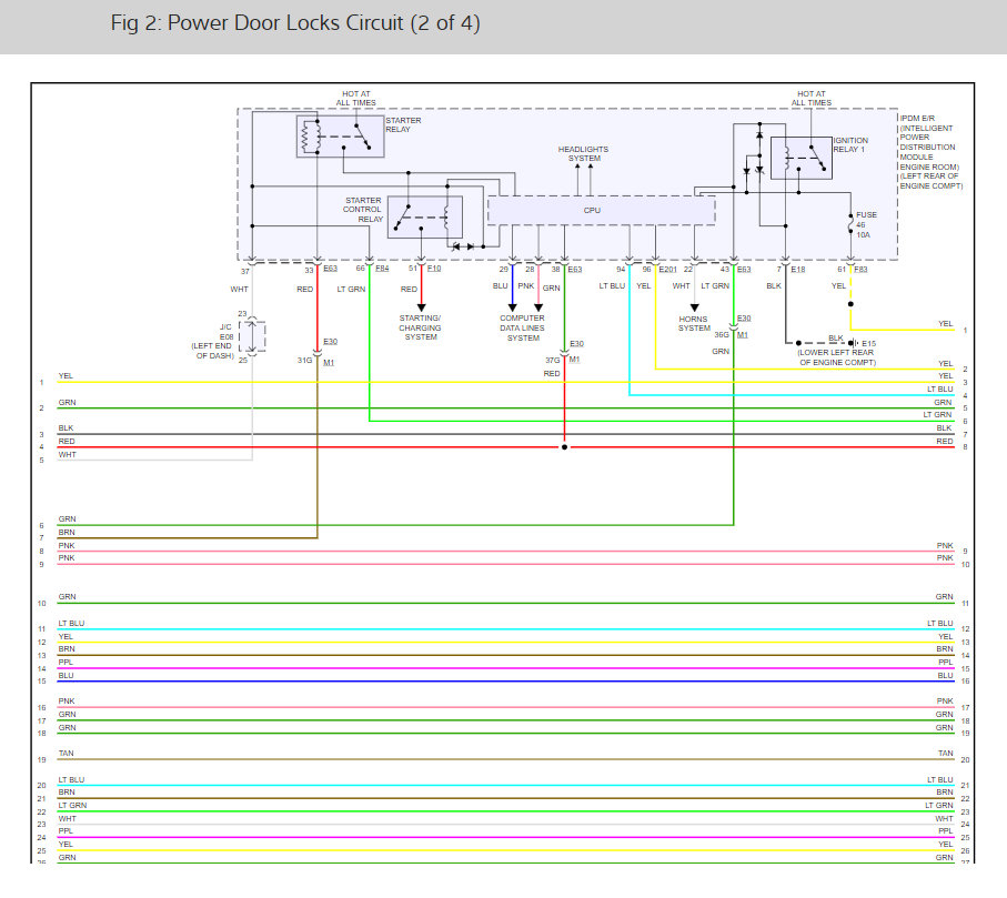

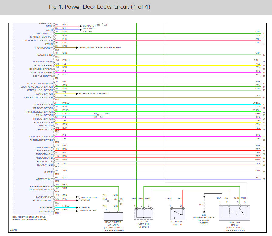

There are 8 fuses that run the door lock system. can you tell me which fuse number it is? Here are the door lock wiring diagrams so you can see how the system works and which fuses are used. Check out the diagrams (below). Please get back to us.
Oct 30, 2019 at 10:06 AM
LEO713
Yes its fuse #4 15A
Oct 30, 2019 at 10:31 AM
  • 55,694 POSTS
Okay, that is for the power to the BCM and the rear doors. can you unplug the rear door lock actuators and replace the fuse to see if it still blows? Check out the diagrams (below). Please let us know what happens.
Oct 31, 2019 at 3:50 AM
LEO713
Yes, i found the problem. the rear door actuator. thank you very much. now would a 2013 Nissan actuator fit my 2014 Altima ?
Nov 4, 2019 at 7:21 AM
  • 55,694 POSTS
Good job, if the part numbers are the same it will work. Please let us know if you need anything else to fix the car.
