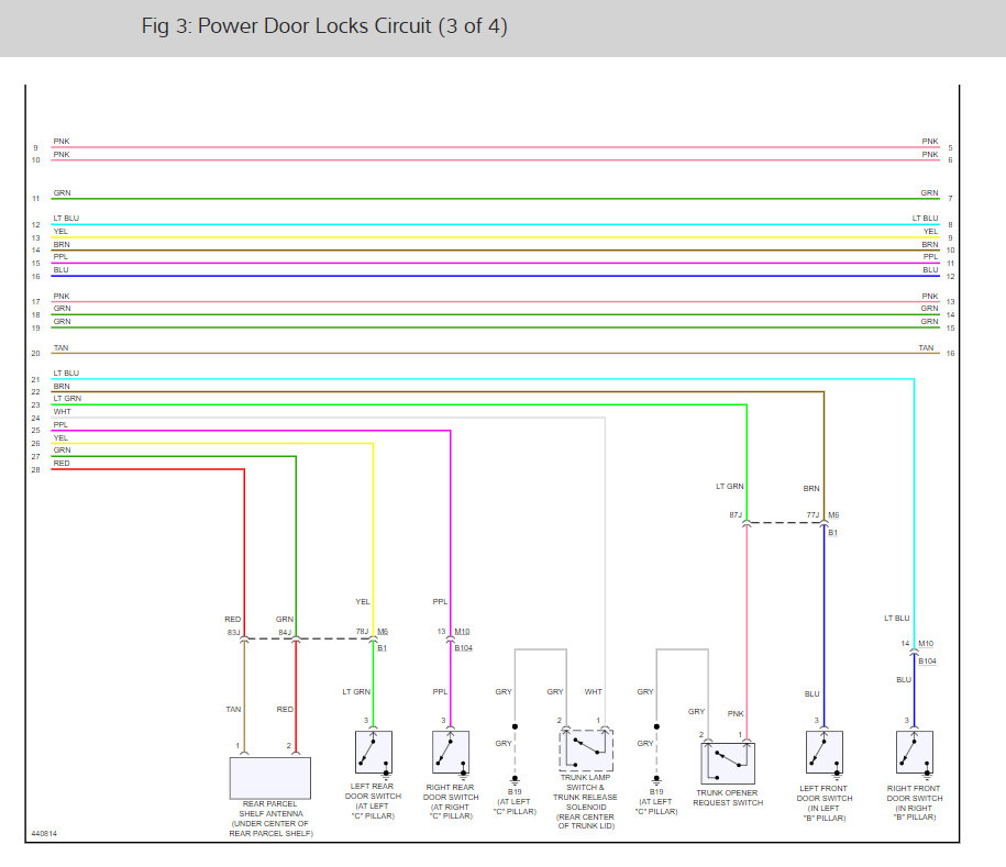

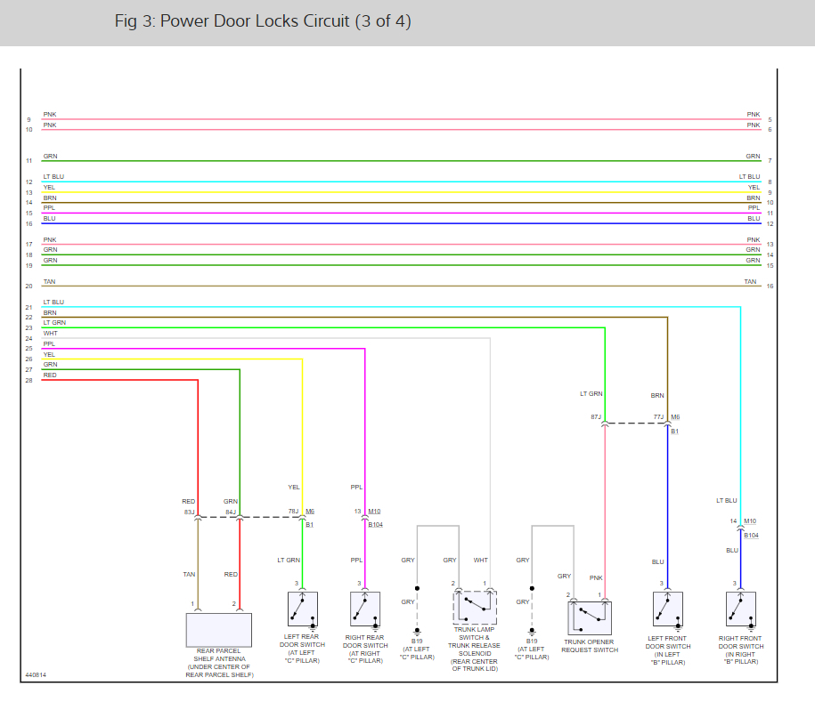

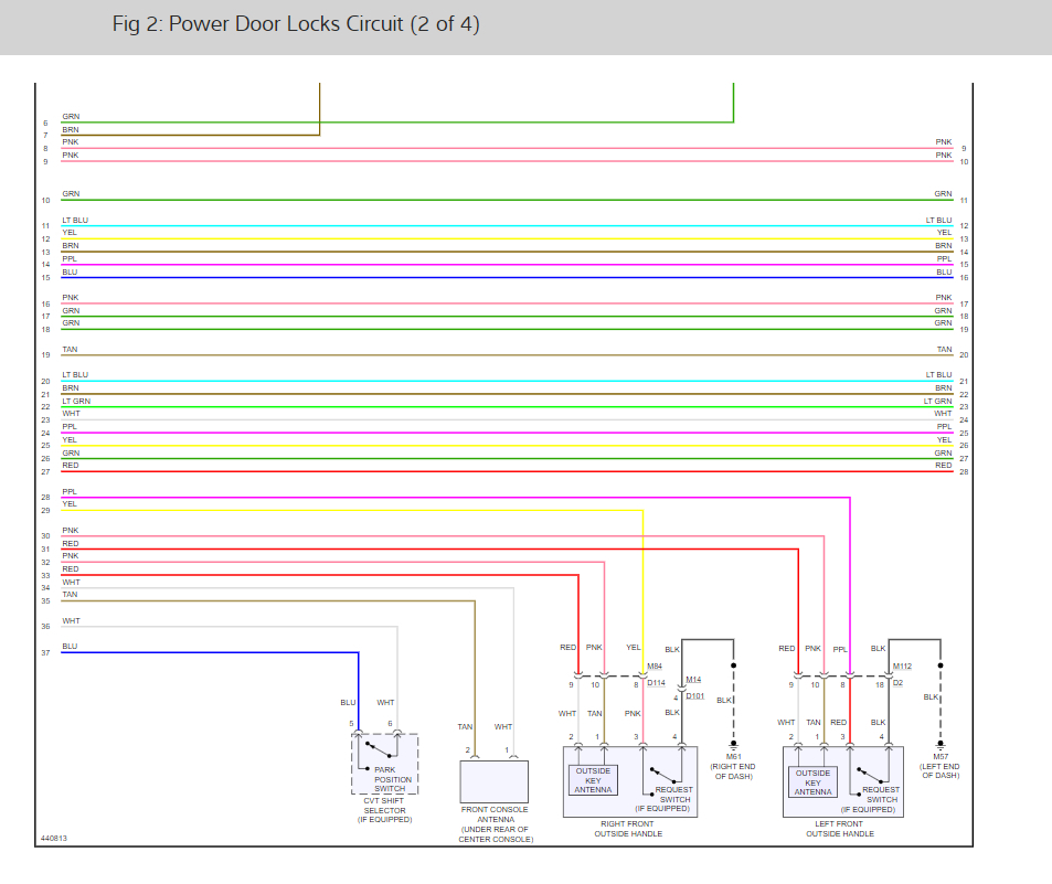

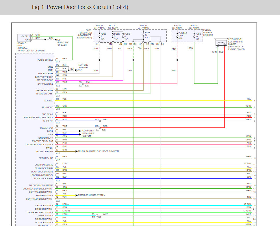

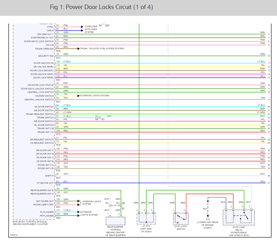

Every time i try to even put a fuse in it burns it out. wont even let me finish putting in. i think it’s a short to grown, but where? I am not sure. what do you guys think?
Oct 29, 2019 at 8:21 AM
  • 55,224 POSTS

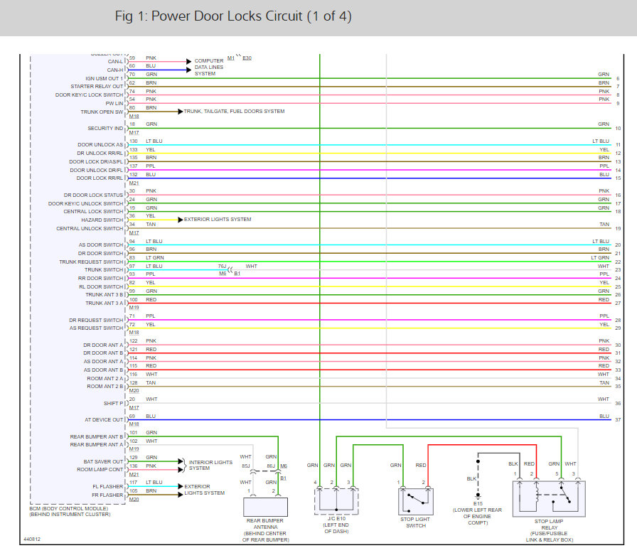

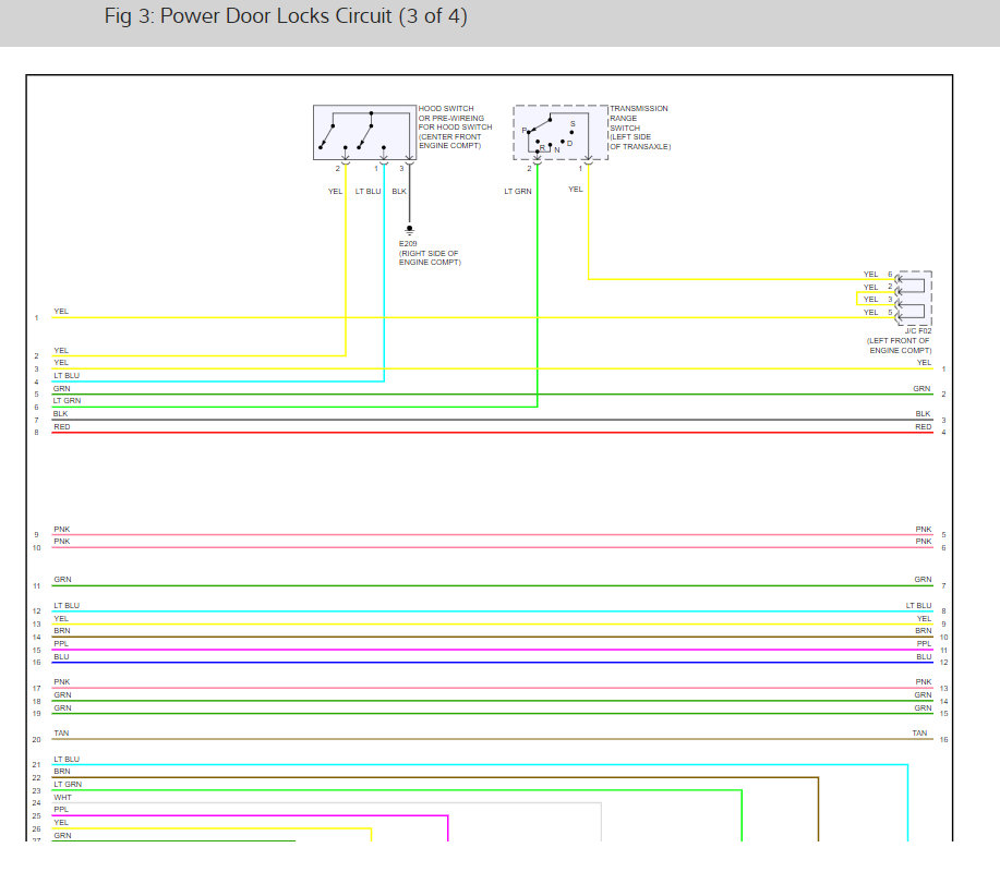

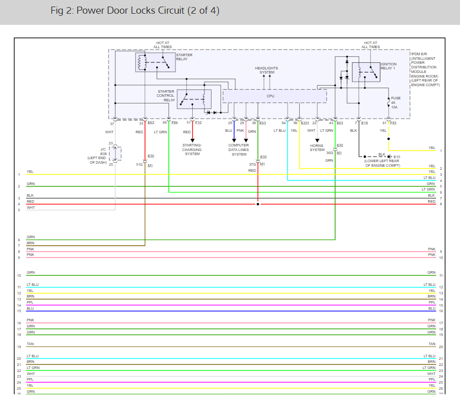

There are 8 fuses that run the door lock system. can you tell me which fuse number it is? Here are the door lock wiring diagrams so you can see how the system works and which fuses are used. Check out the diagrams (below). Please get back to us.
Oct 30, 2019 at 10:06 AM
LEO713
Yes its fuse #4 15A
Oct 30, 2019 at 10:31 AM
  • 55,224 POSTS

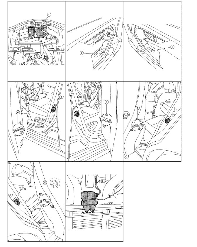

Okay, that is for the power to the BCM and the rear doors. can you unplug the rear door lock actuators and replace the fuse to see if it still blows? Check out the diagrams (below). Please let us know what happens.
Oct 31, 2019 at 3:50 AM
LEO713
Yes, i found the problem. the rear door actuator. thank you very much. now would a 2013 Nissan actuator fit my 2014 Altima ?
Nov 4, 2019 at 7:21 AM
  • 55,224 POSTS
Good job, if the part numbers are the same it will work. Please let us know if you need anything else to fix the car.

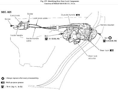

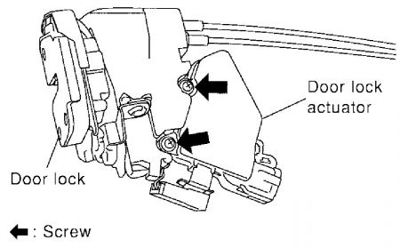

JIM SURACE
We just purchased an Altima sedan and the rear drivers side door lock wont open. The switch seems to activate since I can hear the ckick but the door wont open. This is the only door that this happens. Even if I manually move the lock lever it wont unlock.
Any ideas??
Thanks
Nov 5, 2019 at 1:53 AM (Merged)
SERVICE WRITER
  • 9,123 POSTS
IF you hear the actuator like you say, then , you need to pull the panal off and get a look. Linkage may be disconnected or in need to lubing and working it.
JIM SURACE
Does the panel just pop off with panel clips??
SERVICE WRITER

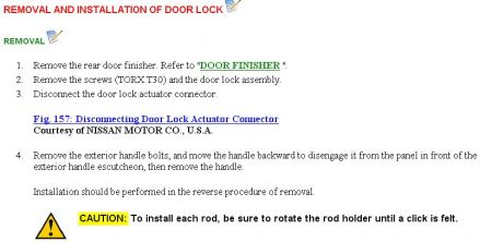

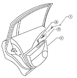

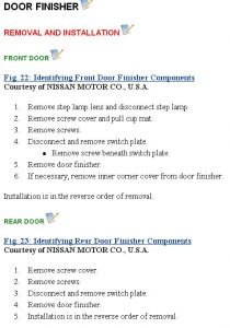

  • 9,123 POSTS
Not sure off hand. These pics might help.
https://images.2carpros.com/forum/automotive_pictures/30961_n1_1.jpg
https://images.2carpros.com/forum/automotive_pictures/30961_n2_1.jpg
https://images.2carpros.com/forum/automotive_pictures/30961_n3_1.jpg
https://images.2carpros.com/forum/automotive_pictures/30961_n4_1.jpg
https://images.2carpros.com/forum/automotive_pictures/30961_n5_1.jpg

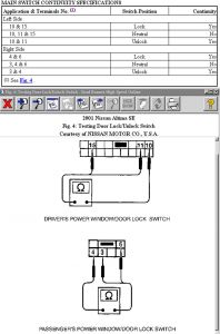

VEREEN123
hi guys, my 2001 nissan altima 94570, the power windows and power door locks are not working. the doors will lock from the inside if i use the switch on the passanger doors but not from the master driver side switch. as for the windows none of them are working at all and both the windows and the door locks stopped working at the same time. can i get some adive on this.
p.s. the doors locks will work if i use the key switch
thanks much ,ken
SERVICE WRITER
  • 9,123 POSTS
https://images.2carpros.com/forum/automotive_pictures/30961_alt1_1.jpg
Check for power to the switch for the drivers door, then check for continuity in the switch. Check fuses for the power windows. specifics test procedures are available here: https://www.2carpros.com/kpages/auto_repair_manuals.htm
