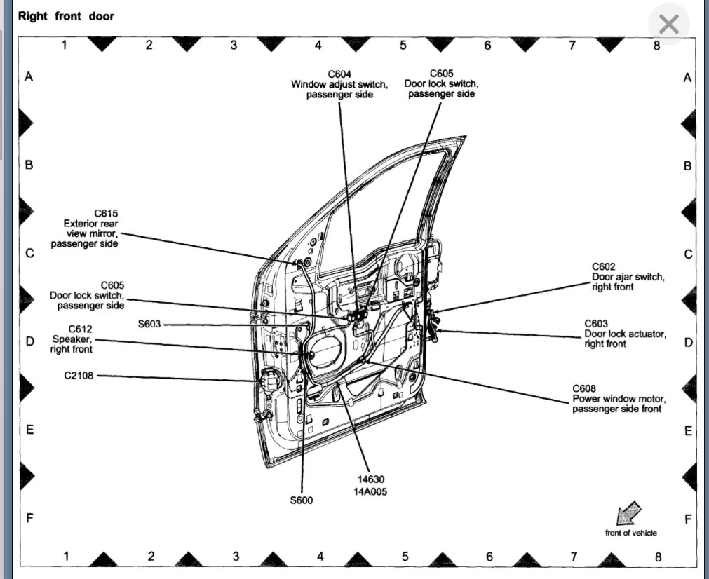

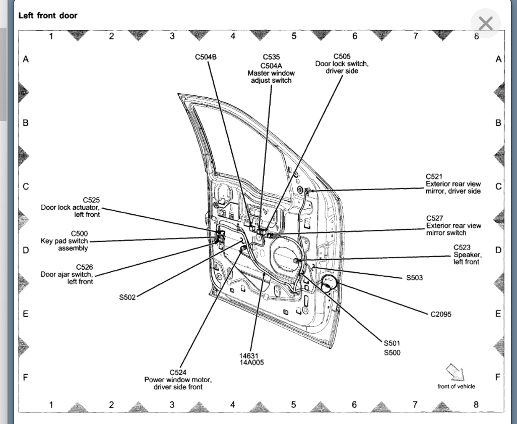

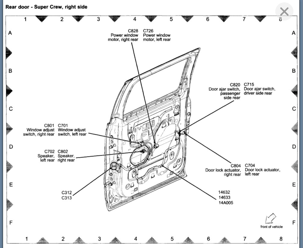

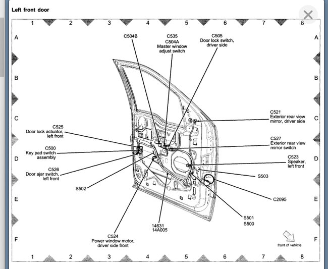

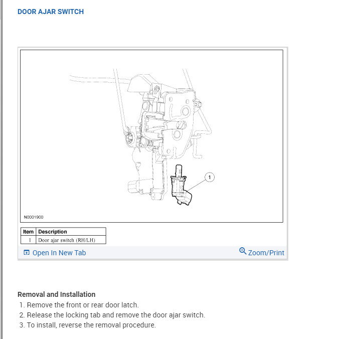

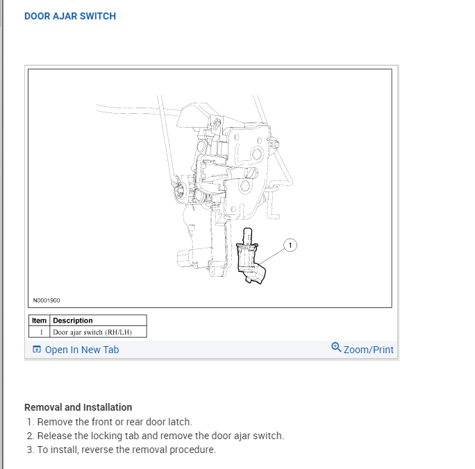

Where is the door button for the cab lighting of the 2004-2008 Ford F150, which illuminates when the door is open and goes out when the door is closed?
Nov 28, 2021 at 2:47 PM
The door switches on these vehicles is in the latch, so I am attaching the info for these latches.
Clearly you will need to remove the door panel, so this guide will help with that:
https://www.2carpros.com/articles/door-panel-removal
Please find the info attached below for the front and rear doors.
