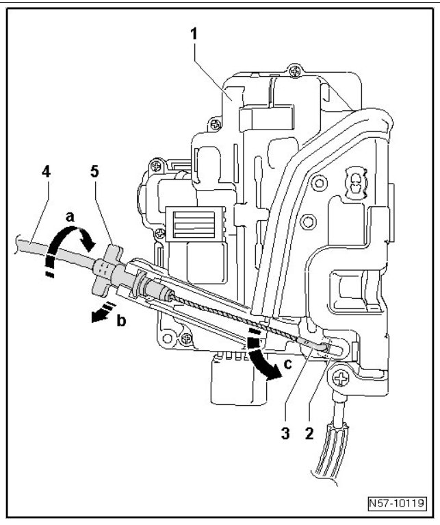

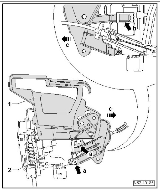

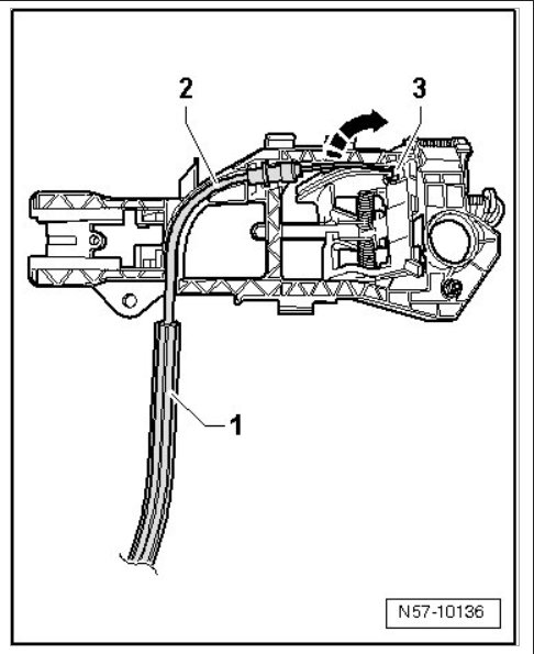

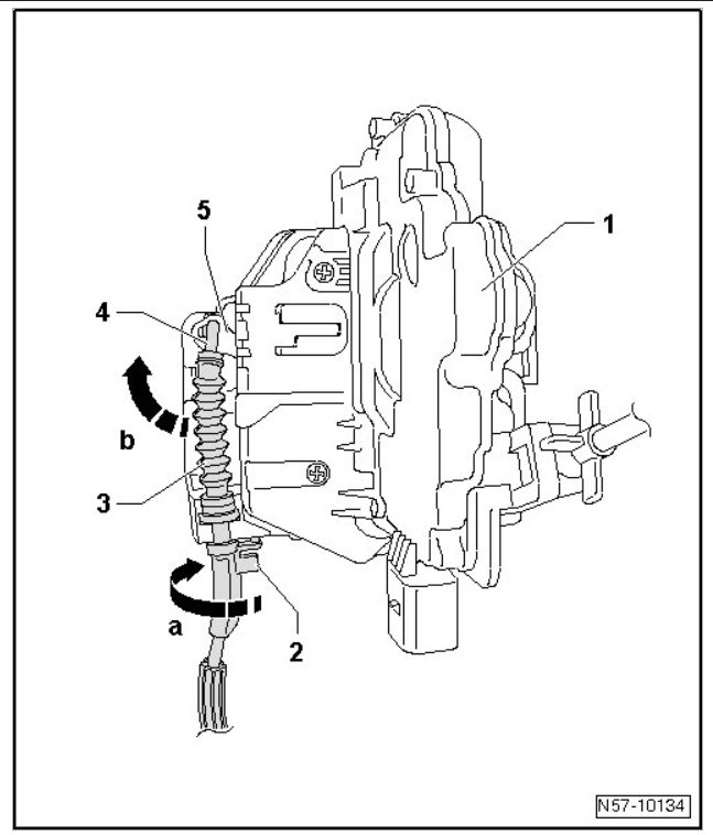

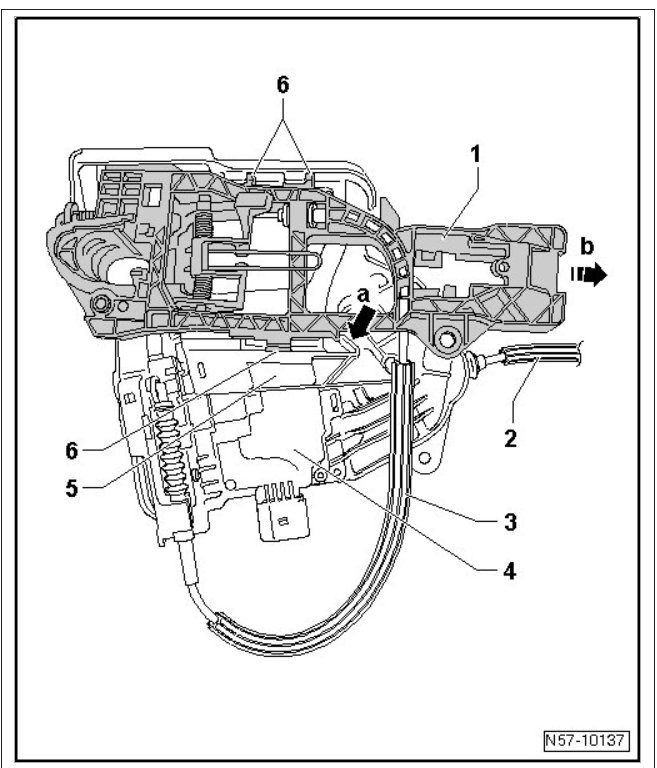

Driver's door latch has just been replaced, but door still will not close when it is really cold. When it has half way warmed up it will close but it will not open from the outside. When it has completely warmed up it will open and close. Car was in an accident and exterior of the door was from another car. I have had this problem ever since. I had read something about a cable on the inside of the door being short when it is cold. Is this possible?
Dec 14, 2017 at 10:09 AM
  • 55,214 POSTS

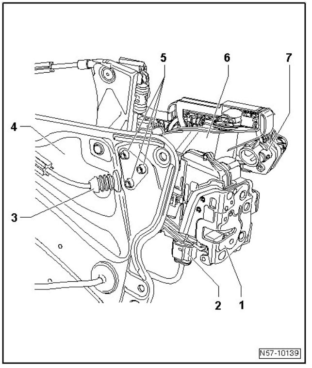

Yes, the adjustments can cause the latch not to work when it is hot or cold but it can be a defective latch as well.
Here are some diagrams for the mechanism so you can check it out:
Rotate lock - 1 - around.
Engage retainer - 2 - by rotating in - direction of arrow a -.
Remove retainer - 2 - from mount.
Swivel cable - 3 - in - direction of arrow b - and remove cable nipple - 4 - from eyelet - 5.

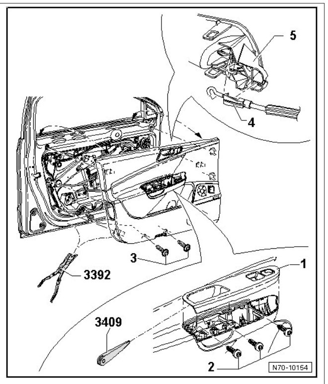

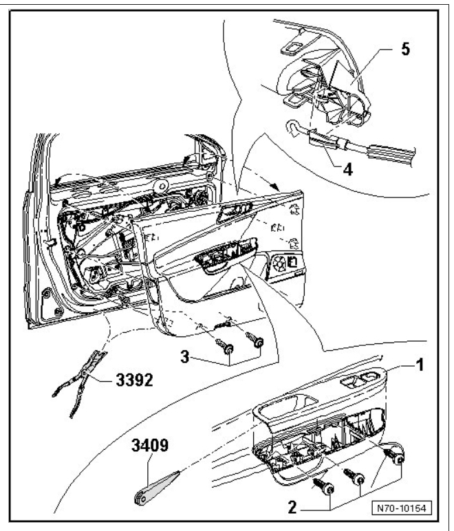

You will need to remove the door panel here is a guide that will give you an idea on how to do it.
https://www.2carpros.com/articles/door-panel-removal
