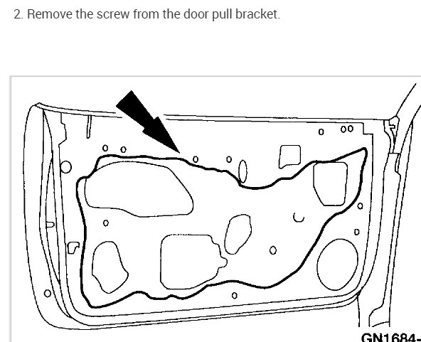

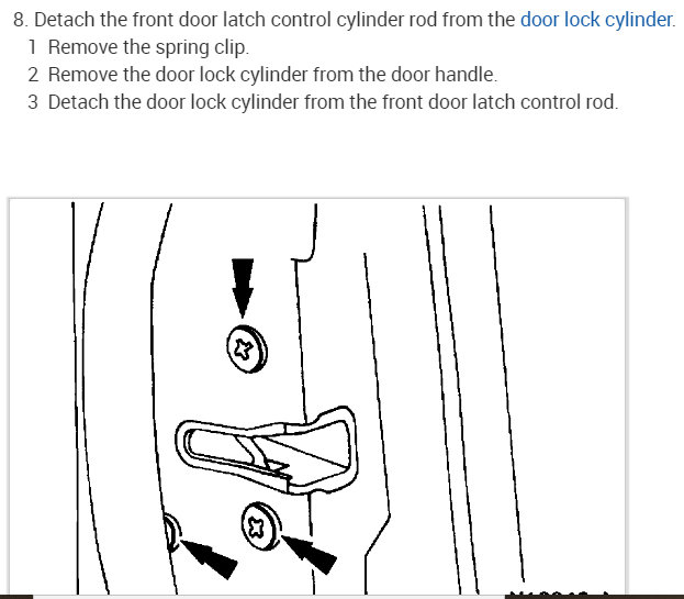

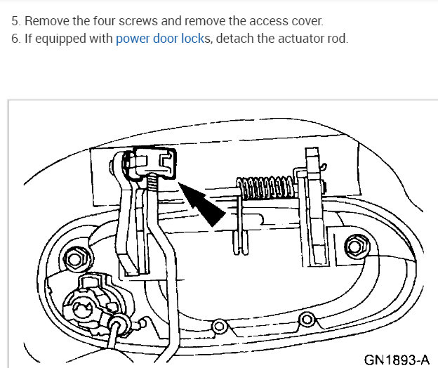

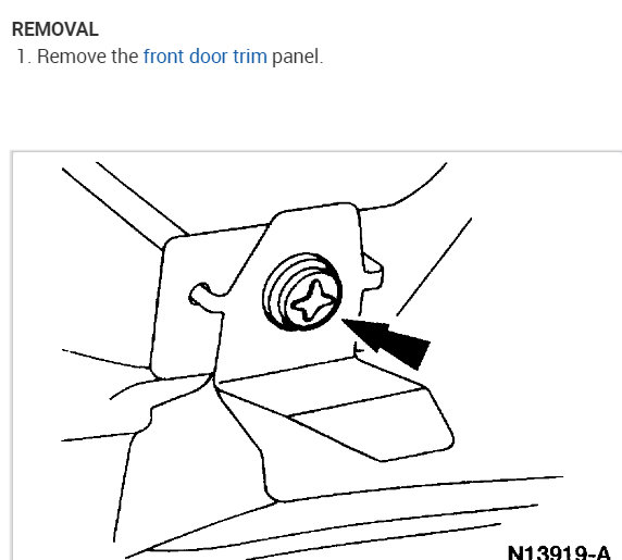

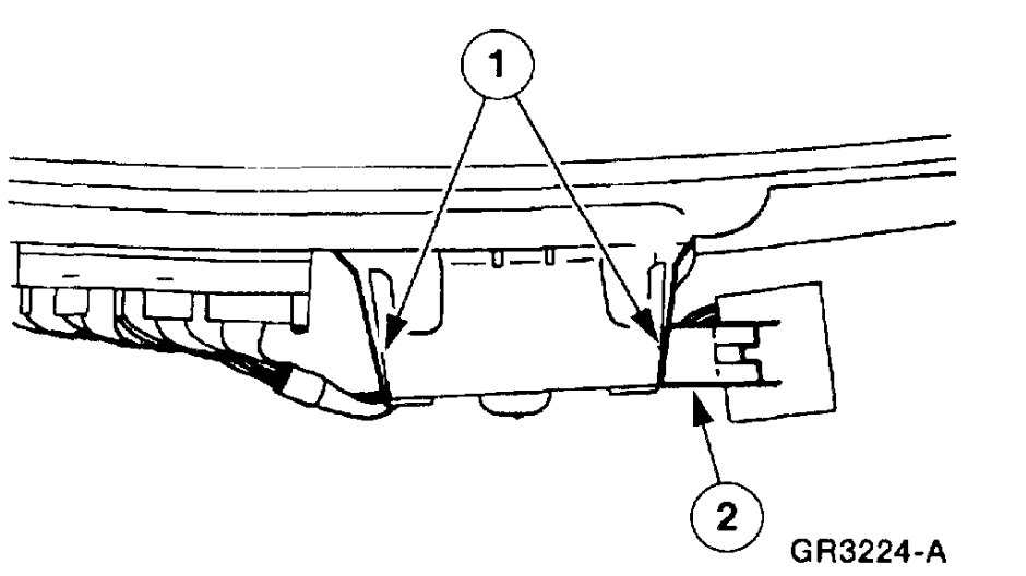

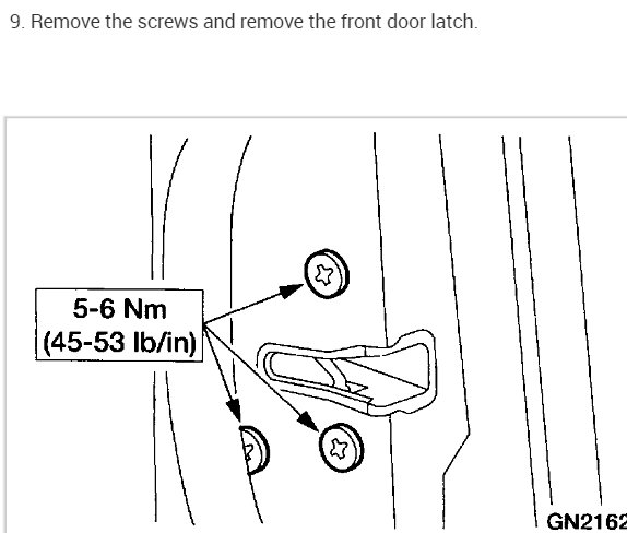

Hello, I’m replacing the front driver side door latch assembly in the door with one that I got from the salvage yard. I’d like to know what is the best way to clean it up, and what lubricant should I use to lubricate it before I install it back into the door?
Jun 5, 2020 at 5:19 PM
DANNY L
  • 5,648 POSTS
Hello , I'm Danny.

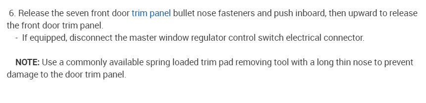

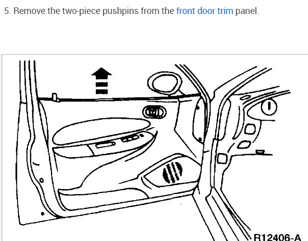

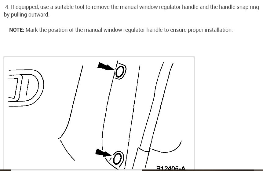

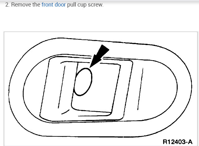

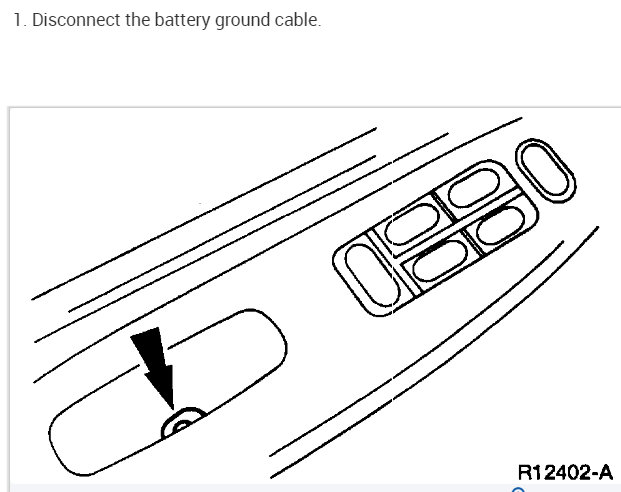

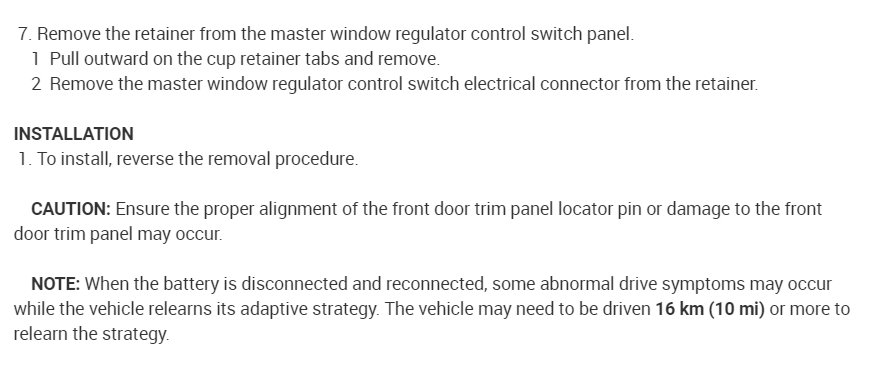

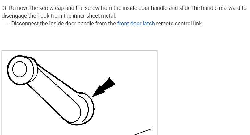

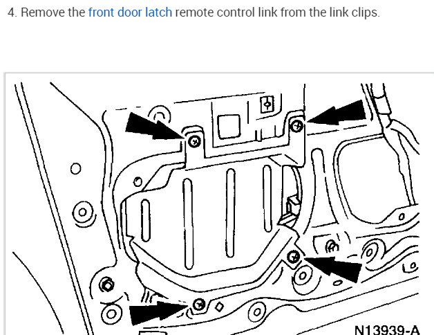

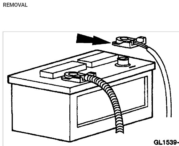

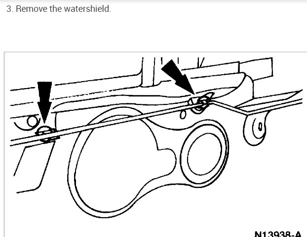

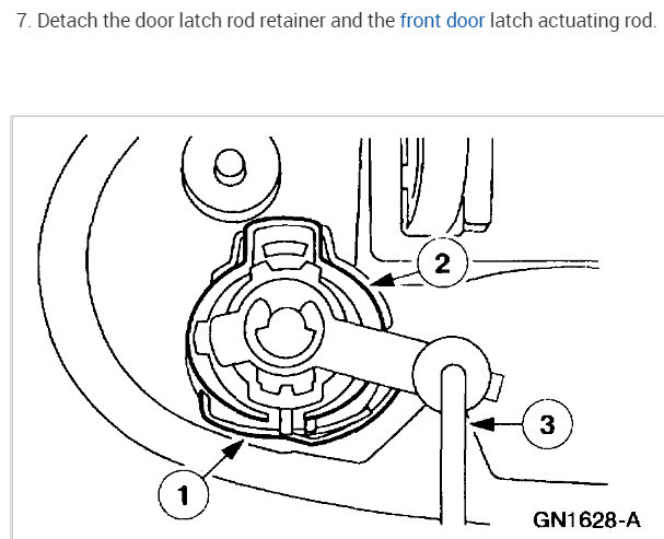

Just about any household cleaner like 409 or Simple Green will work good as a cleaner. Just be sure to get any debris,old grease, etc. off so that the linkage and all parts move freely. I've attached a tutorial showing how to remove a door panel.
https://www.2carpros.com/articles/door-panel-removal
I've attached picture steps below on how to remove and replace the door panel and door latch assembly for your car. Hope this helps and thanks for using 2CarPros.
