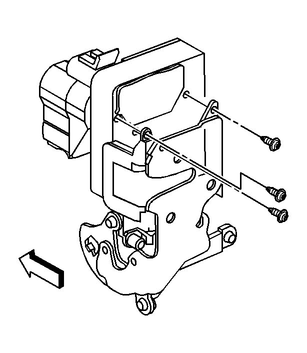

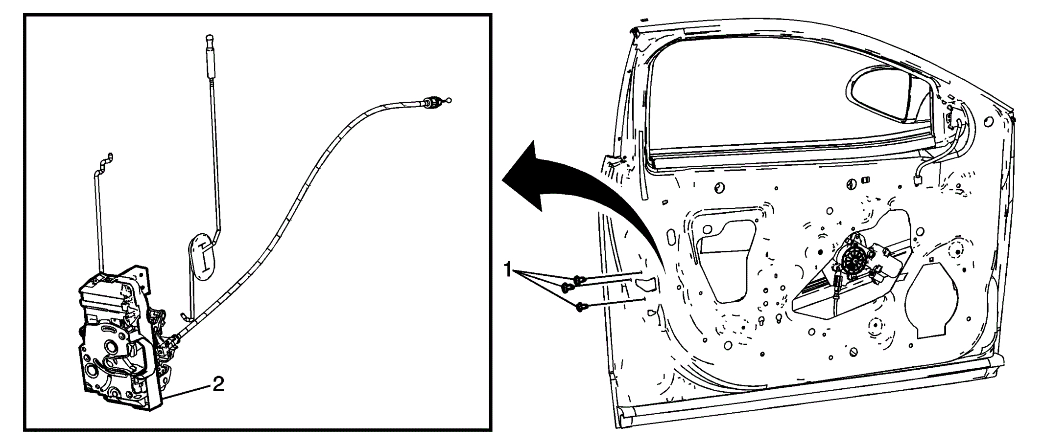

My front door will not latch. I looked to see if the latch was down (latched) and it was not. it is ready to latch, but it does not.
Feb 25, 2017 at 7:12 PM
STEVE W.
  • 15,349 POSTS
If you close it and it just does not latch the most likely cause is a failure inside the latch. There is a spring inside that pushes a pawl in place that catches on the back of the rotating part of the latch. That spring either fails and the rotating part of the latch does not latch, or dirt and rust build up on the sides of the locking pawl and it cannot move. The best repair is a new latch. It involves taking off the door panel, removing the vapor barrier, removing the outer door handle, and then replacing the latch. below you can see images of the latch and its location.
Oh if you go looking for parts GM calls the entire unit the door lock actuator.
