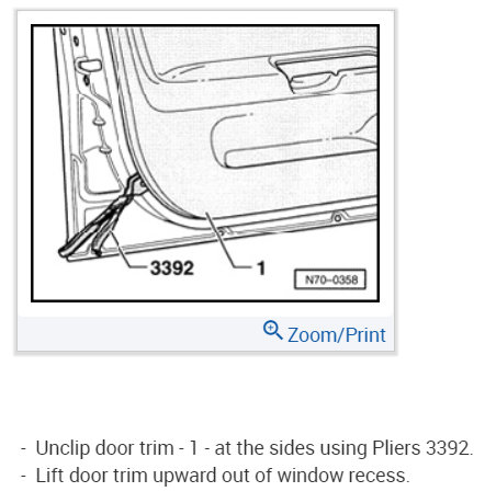

How do I get my drivers side door open?
Jul 17, 2018 at 7:42 AM
  • 55,433 POSTS

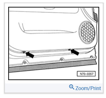

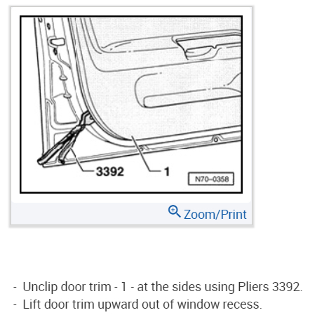

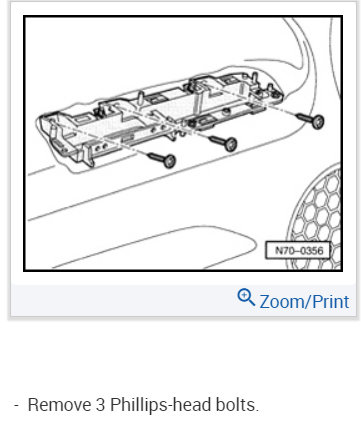

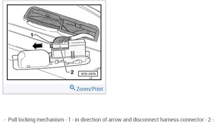

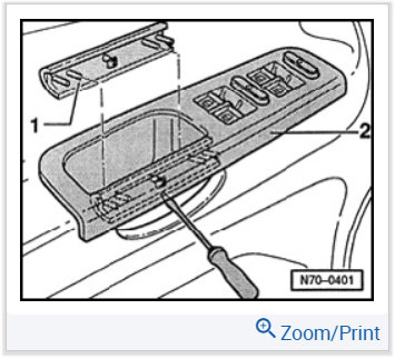

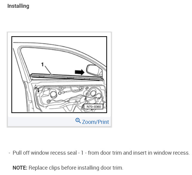

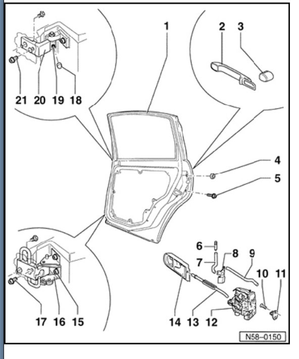

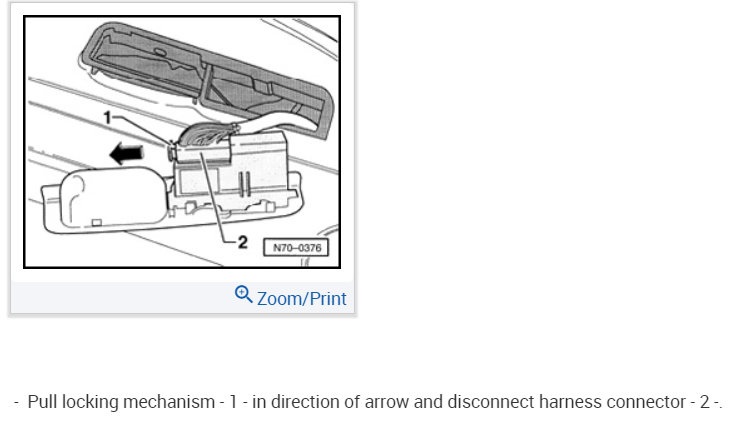

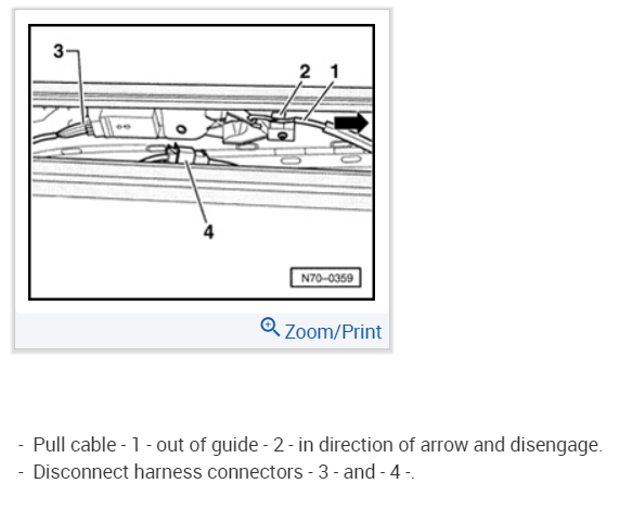

It sounds like the latch is stuck which you will need to remove the door panel to get at which means removing both drivers and passengers seats. Here is a guide that will give you an idea of what you are in for when removing the door panel with diagrams of the repair below:
https://www.2carpros.com/articles/door-panel-removal
Check out the diagrams (below). Please let us know what you find.
