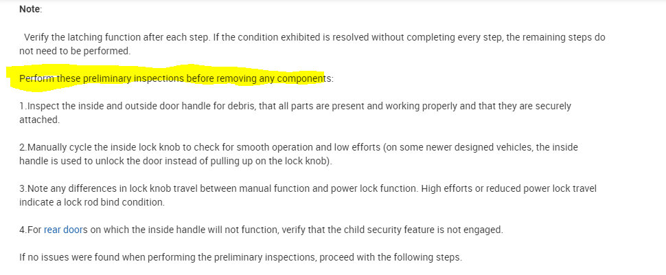

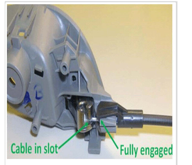

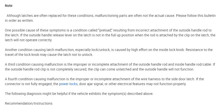

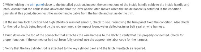

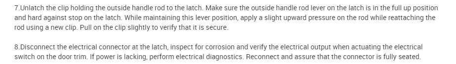

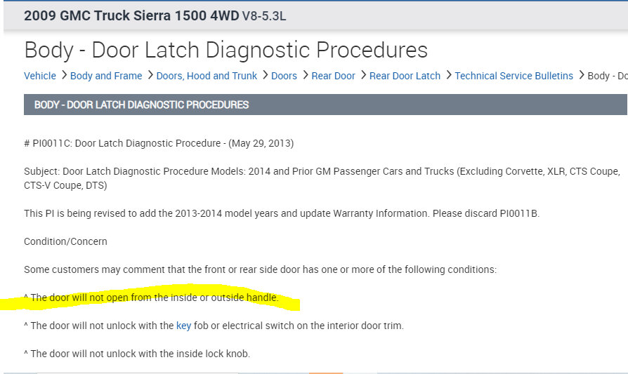

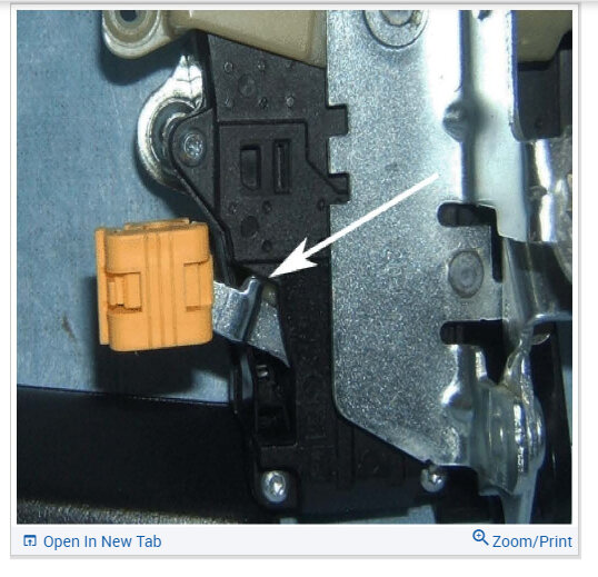

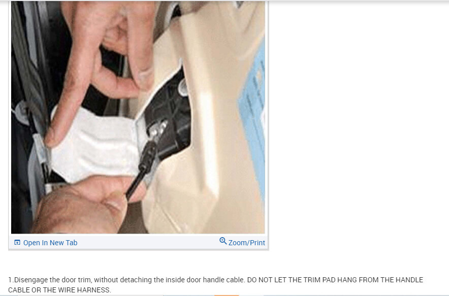

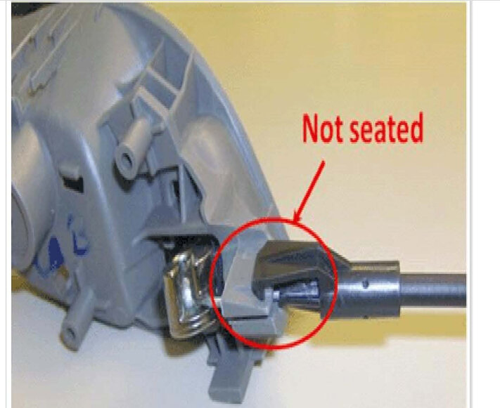

I attached a technical service bulletin related to this issue, take a look through it and let me know if anything listed helps.
