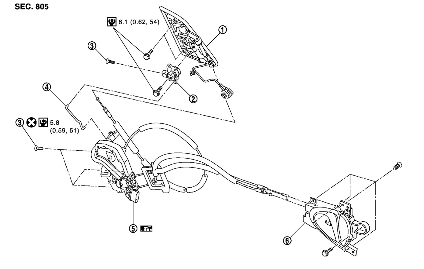

Hey gentlemen, I got a good one here.
Driver's side door won't open. Both inner and outer door handles went out. Now I need to open the door panel up, but I need to open the door first. Any info on how to get the door open would be great. Thank you

First lock and unlock it a few times from inside the car and see if maybe you get lucky and it's just a sticking latch preventing the outside handle from working. They both use cables, but the interior is directly connected to the latch the exterior has a lever that the lock moves that disconnects the outer lever when the doors are locked, they can stick, or rust can make them bind up. Repeatedly snapping the interior lock has a few times made them work one last time. If no luck, then I would find a replacement outer handle. Then use it to determine where to drill the retaining bolts that go through the door away. Then you should be able to get into the door cavity and get to the latch and get it open. I don't believe you can get into that area through the window to move the latch release. The other method would require you to strip the interior enough that you can force the interior panel to come off, but then you still need access to the latch.

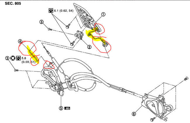

  • 110,244 POSTS

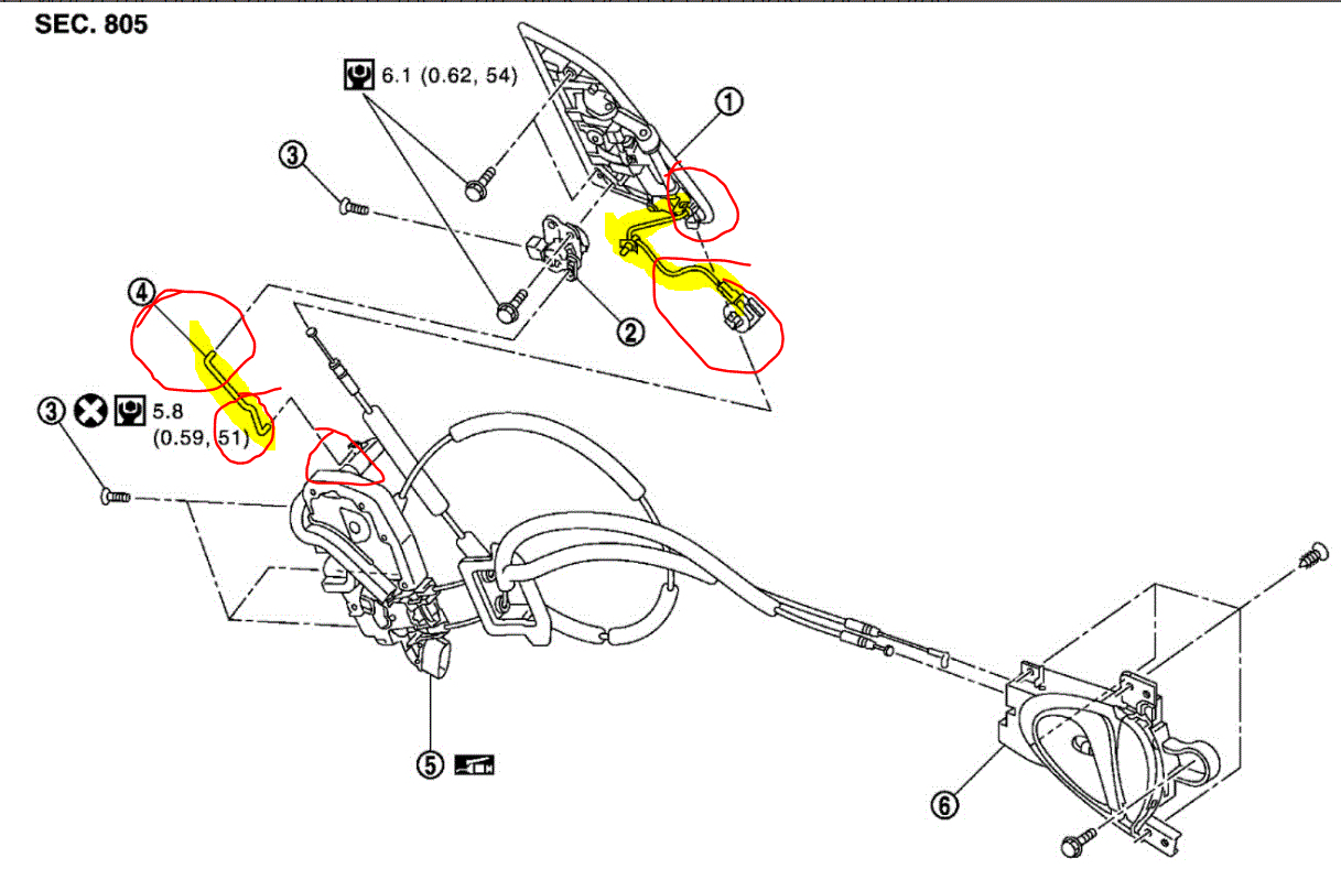

If the outside handle isn't working, chances are either the linkage has come disconnected or the lever on the handle has broken. However, you would feel that when pulling on the handle.
Take a look at the pic below. I circled the connection points of the exterior door linkage. With the panel off, have a helper actuate the exterior handle while you check to see if everything is moving.
Let me know what you find. Also, no problem whatsoever with the timing of the response. We just like to make sure things are taken care of. I hope you understand.
Take care and let me know what you find.
See pic below.
Dec 1, 2021 at 9:41 AM

  • 110,244 POSTS
Let me know what you find. Also, looking at the pic, it appears there are steel rid linkages. Make sure they are attached. (Specifically, numbers 1 and 4 in the above pic)

STEVE W.
  • 15,345 POSTS
The solid links are for the door locks, the cables are the actuator links to the handles. As the inside handle was working and then both stopped, I would look at the lever the locking pieces attach to. Usually, it's just a small lever that moves and when in the "locked" position it physically moves so that neither of the handle linkages will actuate the actual latch. Those levers like to rust and fall off or they get bent just enough that they don't go into place to make the latch work. It looks like this one is on the end of the latch. the lever you see at the lower right and the plastic piece on the far left.

TOYPACIFIC
  • 159 POSTS

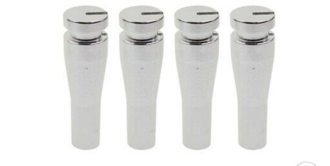

Hi guys, just an update. I don't know how I missed this but these cable pins. This was out at the other end of the door and had to replace them. Door is working fine. Thank you all for your advice and info. I'll be back with more.
