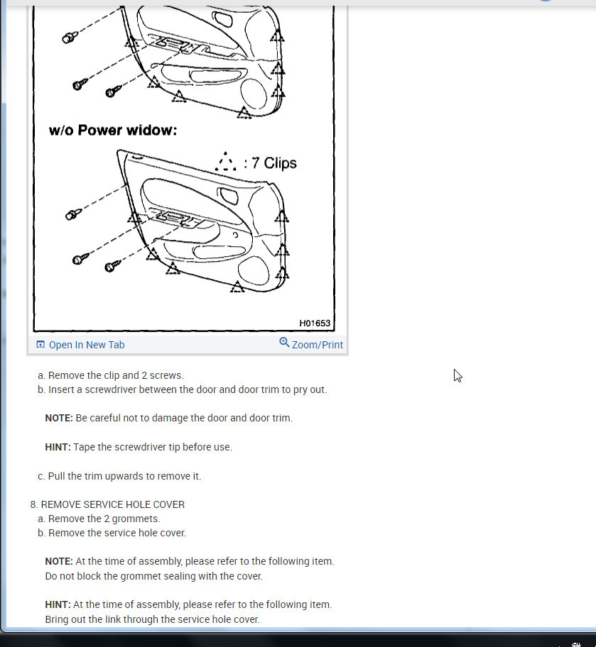

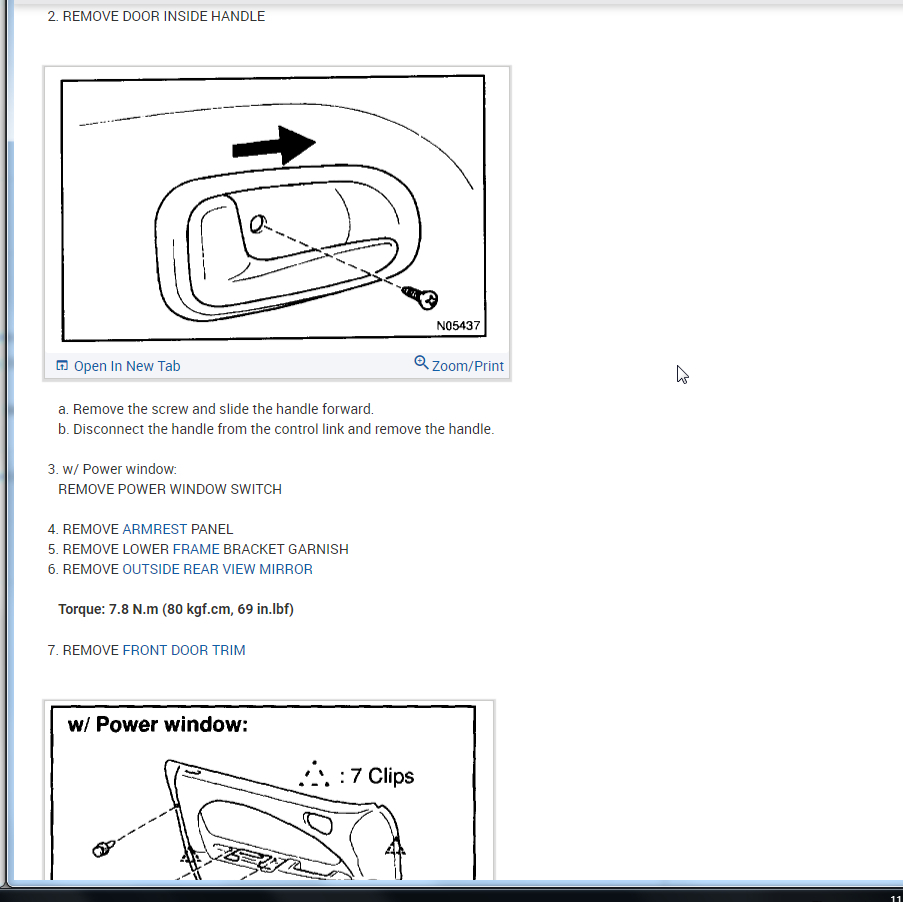

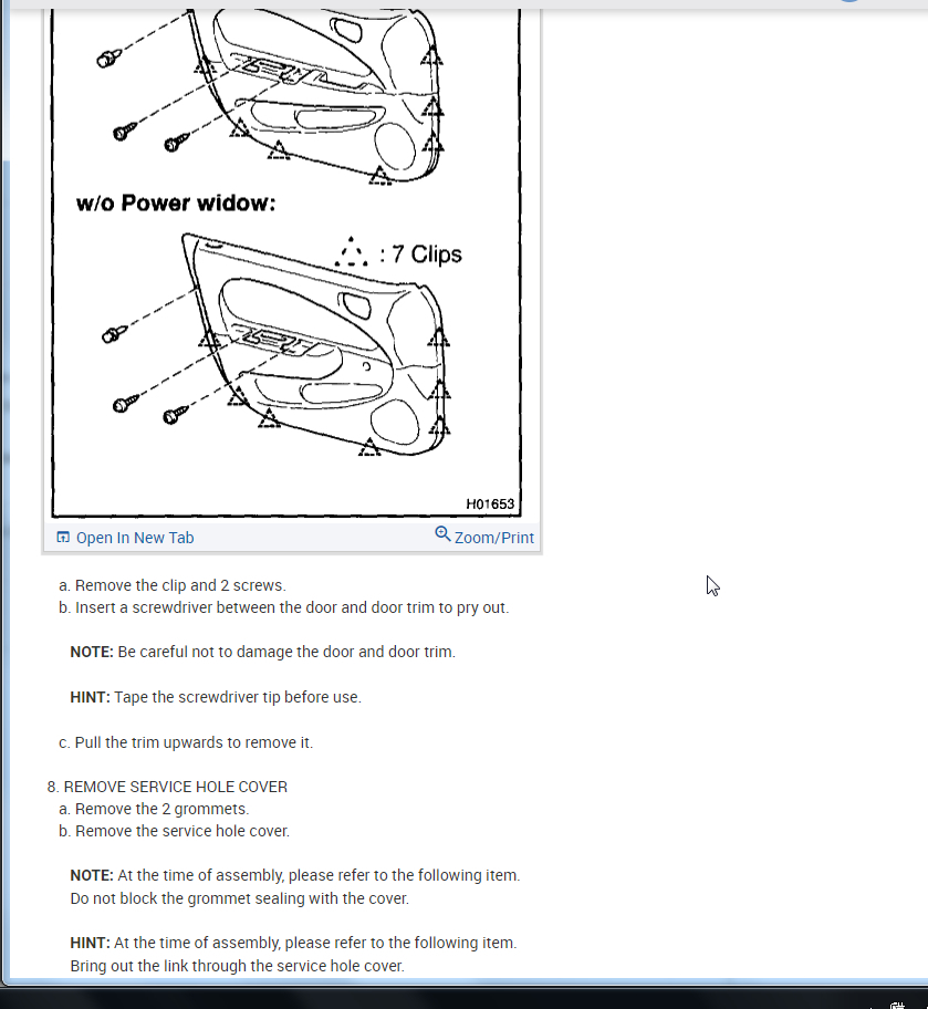

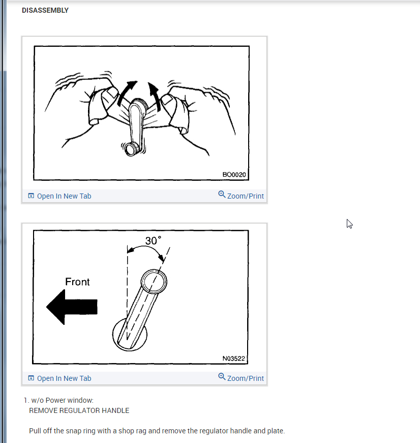

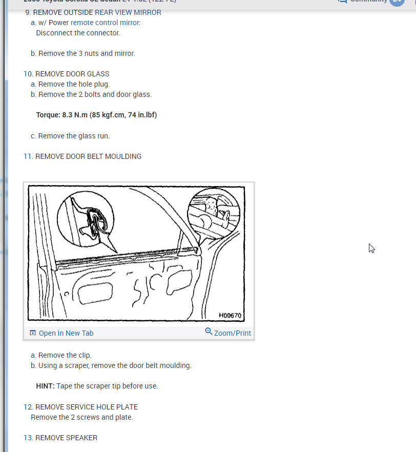

Looks like this body style was consistent from 1995-2000 so you should be able to use any handle from one of these. It is not clear what other body styles would work so I would stick with your vehicle in these model years just to be sure.
Here is a guide that will help removing the door if you need this:
https://www.2carpros.com/articles/door-panel-removal
We don't have a manual on this vehicle as it is not offered here in the USA but here is the process to take the door apart on a similar vehicle.
