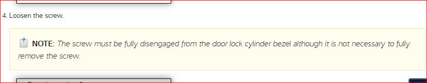

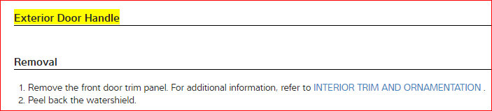

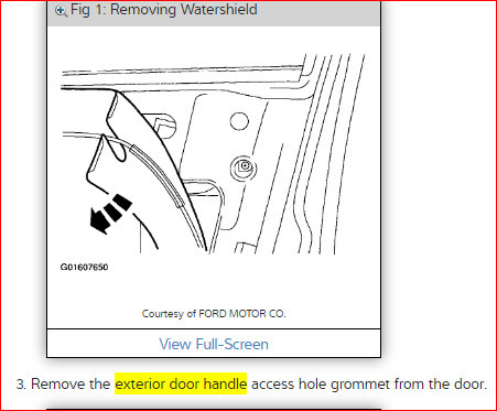

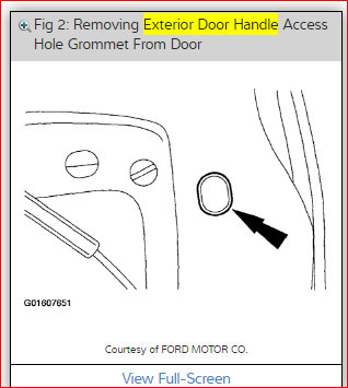

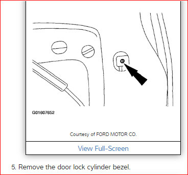

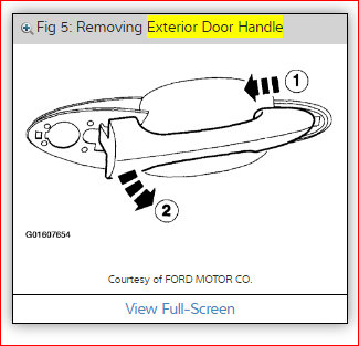

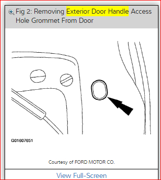

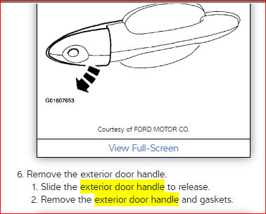

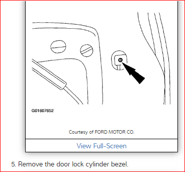

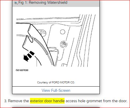

Hi, my car's exterior handle is not opening the door. The handle is not broken. I took off the interior door, but I do not know what to do now.
Aug 15, 2018 at 11:55 PM
DANNY L
  • 5,648 POSTS
Hello, I am Danny.
I have attached as bunch of step-by-step instructions on removing the outer door handle. Once removed you can see what piece is broken/loose/defective. Install in reverse order. Hope this helps and feel free to ask any questions if needed.Thanks for using 2CarPros.
