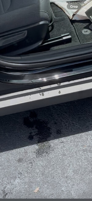

Brand new car had it 2 weeks. Noticed when opening the door water dripped out. It has been raining every day and since it last rained this was the first time I had opened my car door and water dripped out. Interior dry just droplets dripped on sill and ground. Only noticed this after the car has sat after a heavy rain. Is this normal?

Those would be the door drains, and they should actually drain out faster. Normally they would be more open. If you get down and look up under the door you will see the drain slots in the panel. I would take a small nylon brush and clean them out to improve how it drains.

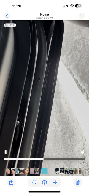

Here’s a better close up. Also, the car is brand new so I’m not sure if it’s a design thing. I haven’t been in my car for a few days, so it was sitting and when I went out, I opened the door, and a few droplets came out and that was it wasn’t continuous.

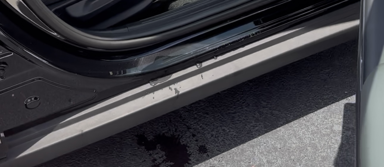

Here’sa picture of one of the weeping holes.

The outer door seals around the glass on the doors leak a bit by design, if they were very tight it would scratch the glass so they use a felt type material that does let some water through. When it rains some water can get into the door shell and then it drips out the lower door drains. Completely normal. Really nothing to worry about, but if you take it back to the dealer they will likely run a brush through the drains and send you home. As long as the water drains to the outside like that it's fine and after a few months of you using the car and the seals and doors getting better seated and all the build chemicals and sealers getting settled it will likely stop. Now if you were in heavy rain or wind whipped rain that can make it worse because it forces the water in. Then it might take a couple days for it all to get out. When you would worry would be if it rained hard and when you moved the door you heard water slosh in it, then the drains are completely blocked. Have seen a couple cars that way. The one had 4" of water inside it! Cleared the drains and it never had an issue after that.

Really discourages you to buy new. As for yours, totally normal for them to leak after a rain, even a heavy dew can make them drip. When you get a big rain and they don't leak, then worry. Where you might see that is if you drive a lot of dirt roads or have a lot of trees that have the fuzzy pollen that blows around and sticks, but normally if you wash it at least once a year or so it will clean out the drains.

There will always be water dripping out. That is how all cars are built. The window felts will always leak some, plus you get condensation in there as well and it drains out, if it didn't drain out it would cause major problems with mold growth and rot inside the doors. So they put a way for it to drain out. 100 percent normal. Heavy rains you will see more water, no rain no water. The seals and hinges will not even start to be worn until the car hits 6-7 years old and they don't let water into the doors if they fail, it would be leaking into the interior of the car. Sort of like those movies of the folks going through a car wash and getting sprayed inside the car. That usually is a sign the seals got damaged, like something drug across them and tore a chunk out of the rubber. The common cause for that is the folks who put roof top carriers on and don't look at where they put the straps.

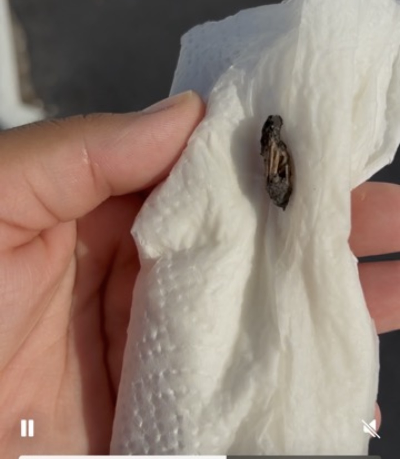

Found this on my car it’s paper thin and brownish black what is it?
Aug 2, 2025 at 12:50 AM
STEVE W.
  • 15,345 POSTS
Looks like a discarded cocoon, look in the trees around where you drive for a bagworm nest, they leave ones like that when they hatch. Questions are handled on a first come first serve basis. If a new one pops up someone grabs it.

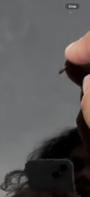

Here’s another picture
Aug 3, 2025 at 1:28 AM
ALYLAROSA485
  • 179 POSTS
It’s the little dot I’m pointing to
ALYLAROSA485
  • 179 POSTS
Also I don’t know if this is helpful in any way but I have been having a mourning dove constantly resting on the car so wasn’t sure if that was something from a dove like maybe their poo or something.
Aug 3, 2025 at 1:33 AM
STEVE W.
  • 15,345 POSTS
Probably blew in from the work around you. Just give it a good bath and a nice coat of wax and that would help with anything sticking to it. Just don't use my vehicles as an example, I haven't wash or waxed a vehicle I own in a very, very long time. Usually they rot away underneath long before the paint fades around here. Poo would be solid, not just a husk.
