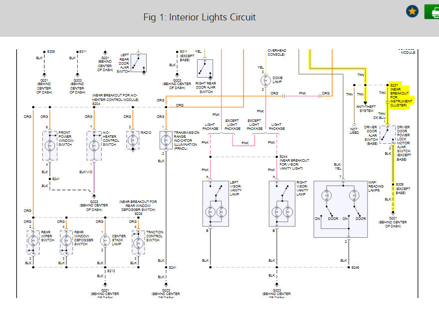

All doors are shut the plunger is not on the inner door nut the handle. how can i fix this without replacing the handle and lock? cluster lights also stay on because it says door. well, i pulled the interior fuse and it is a quick fix but the cluster still draws power because it shows mileage and "door".
Aug 16, 2019 at 5:09 AM
SCGRANTURISMO
  • 4,897 POSTS

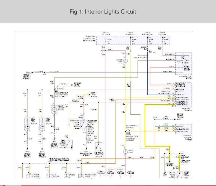

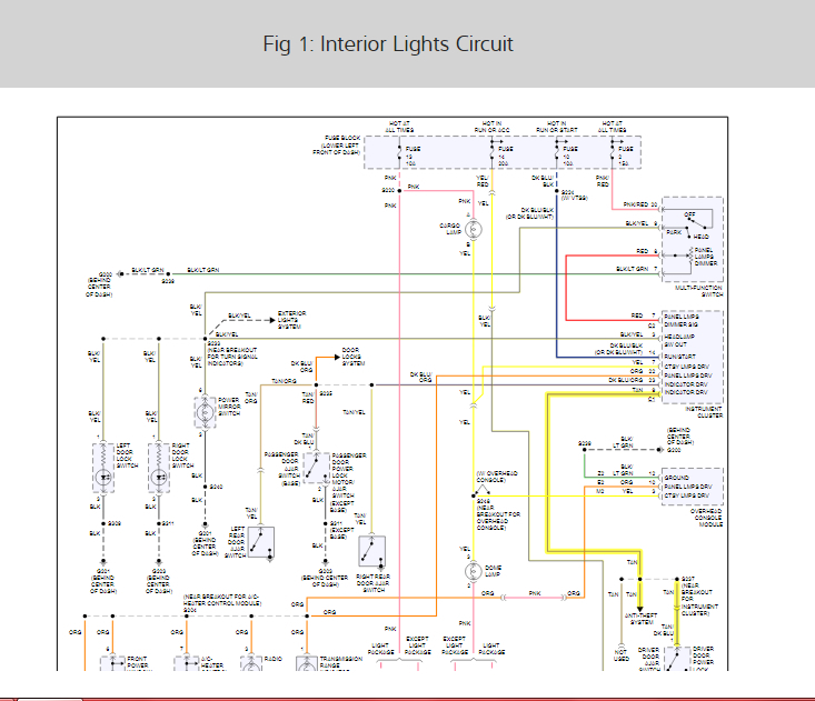

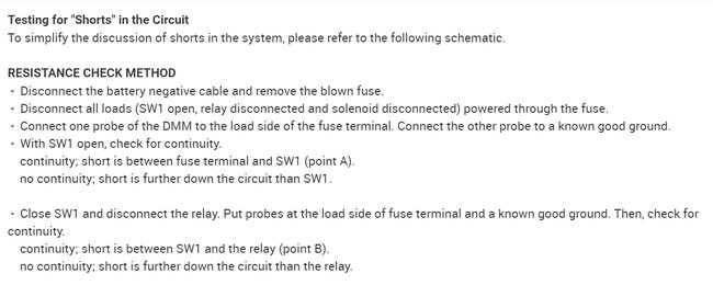

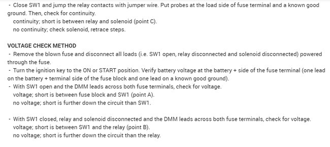

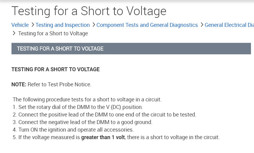

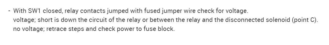

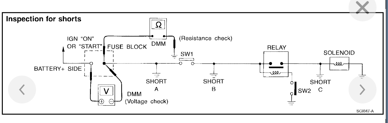

This sounds like you might have a short to ground before the Door Ajar Switch in your vehicle. In the diagrams down below I have included an interior lights wiring diagram with the wires and splice in question highlighted and a guide on how to find a short to power in an automotive electrical circuit. I have also included a guide for how to find a short to ground as well. Please use this guide as a reference but you are going to be looking for a short to power, somewhere the circuit is shorting to a power supply like a wire that is hot at all times. You will need to us a digital multi-meter (DMM) for this so I have included a link below for you to go to if you are unfamiliar with how to use one.
Please go through this guide and get back to us with what you are able to find out.
