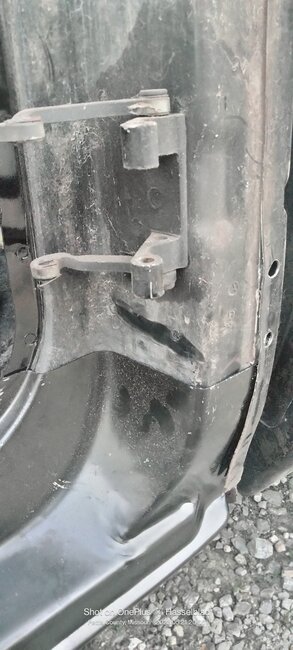

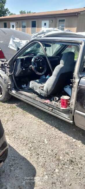

I have the vehicle listed above LS model. I took off driver door and third door off to replace the rocker panel now I am putting it back together now I am having a hard time to get the bushings for the third door. Does anybody know where to get them?

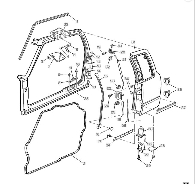

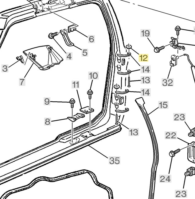

Looks like GM has them available. Part number I found is 15990275. List price is $0.74 each. They are calling it a "Hinge Pin Retainer."
The entire hinge kit is available as well from GM, but the price is ridiculous. In case you need it here is the information on that. Part number 15025788. List price $201.38 each.
I have added some images for you.
