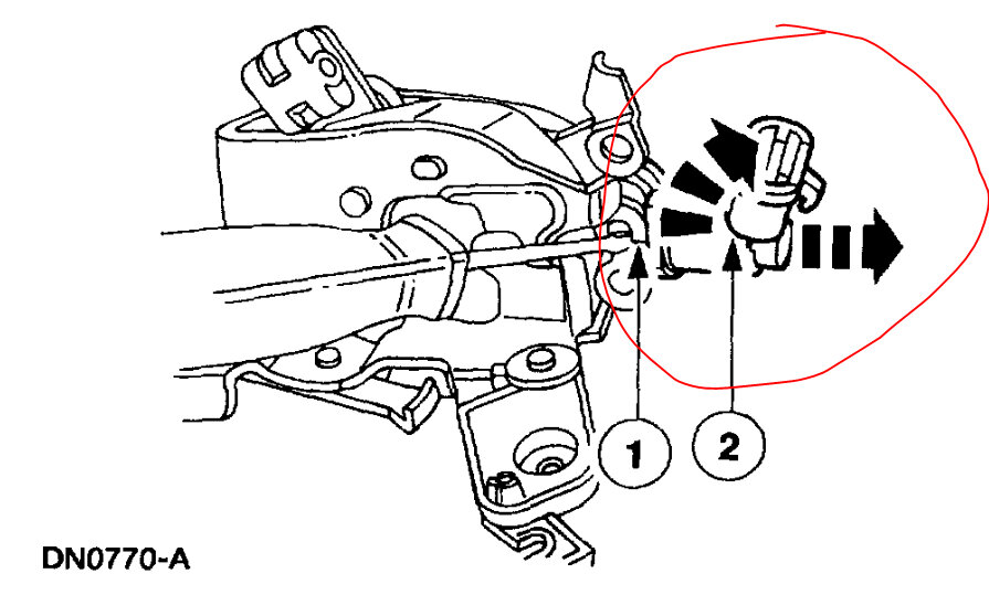

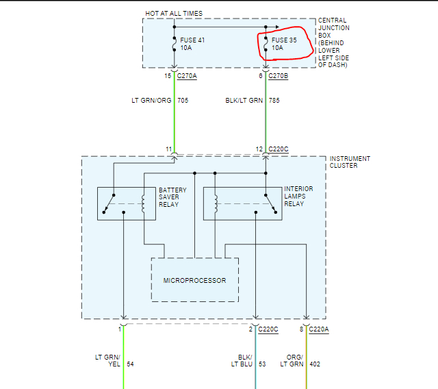

I suspect one of the door ajar switches are bad. If you want to eliminate disconnecting the battery each night until we resolve this, remove fuse 35 in the central junction box under the dash. That should shut the dome lights down.
Next, at each door latch is a switch that is used to turn the lights on inside and indicate a door is open. If you look below at pic 2, I circled what to look for at each door. If you disconnect the connector, one at a time, it should open the circuit and turn the lights off. If you do one at a time, it should lead you to the problem switch/door.
Let me know if this is something you are comfortable performing.

I really appreciate this, Joe. I'll take the fuse out for one and check each door and disconnect each one until I find the problem. Do I have to remove the door panels in order to disconnect this switch?
Regards,
Sep 18, 2024 at 9:05 PM
FRANKN209
I took the door panel off the passenger side and when I wiggled the door ajar switch, the light would turn off on the dash. I was able to push the switch enough to turn it off completely until I'm able to change it. Thanks for the help.
