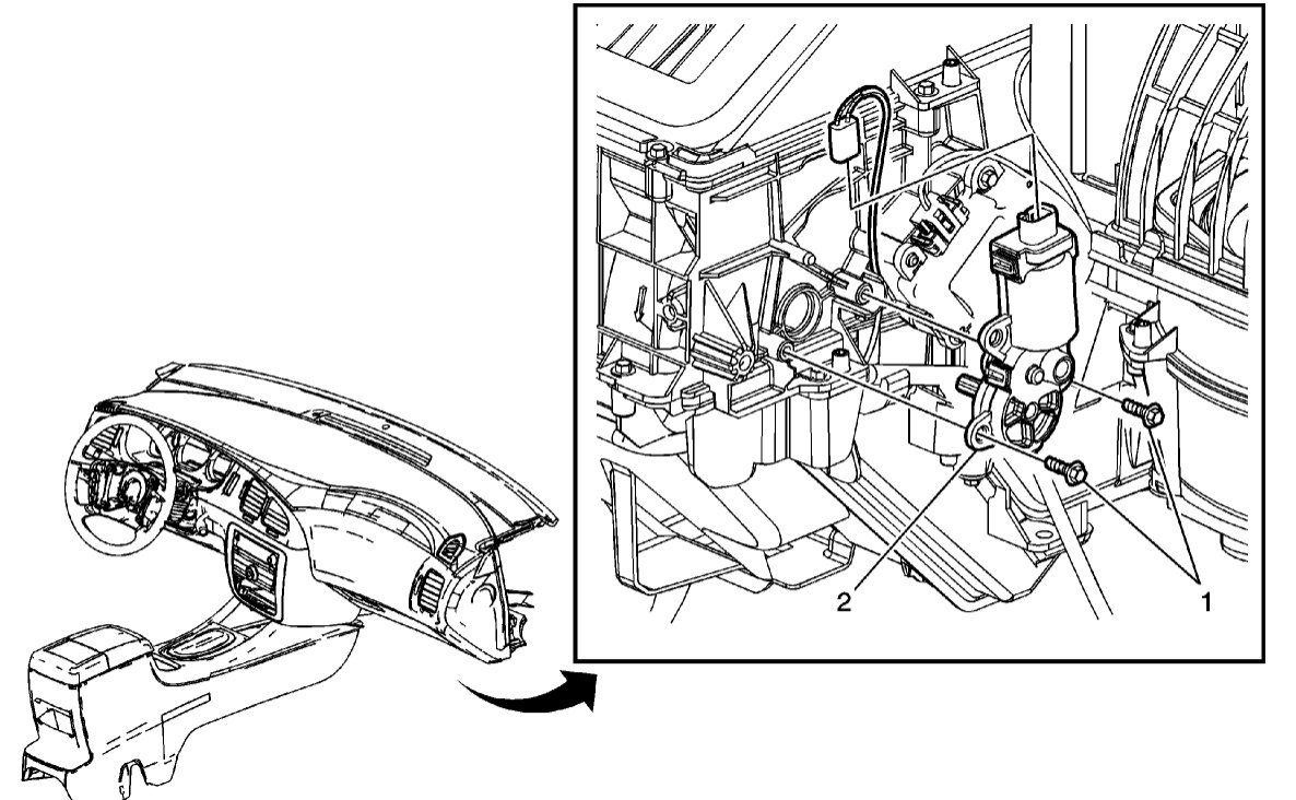

knocking noise coming from glove compartment.
Jul 7, 2017 at 2:58 AM
  • 55,421 POSTS

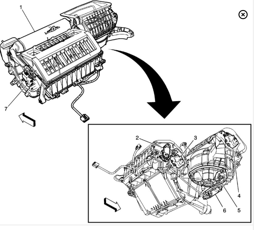

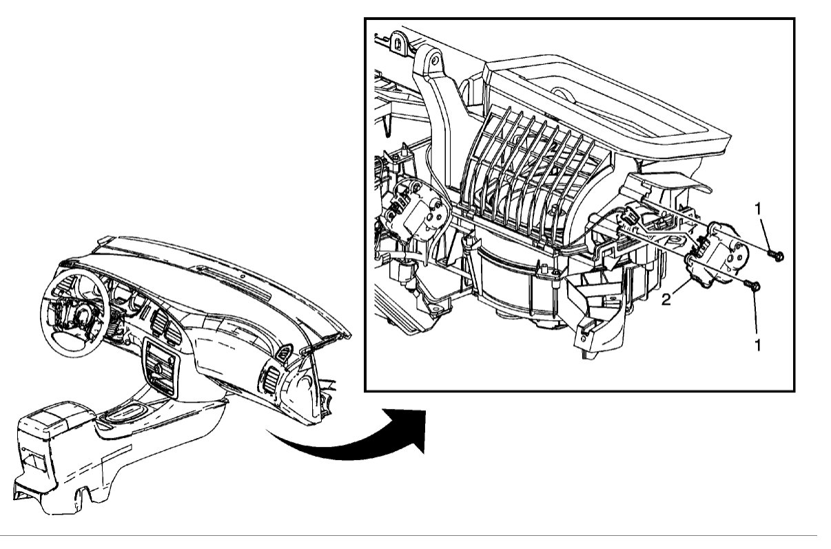

That knocking noise is probably a blend door actuator that has gone out and needs to be replaced. Here is a guide that will help you see what I am taking about with a diagram (below) that will show you what it like on your car.
Please let us know what happens, we are interested to see what it is.
