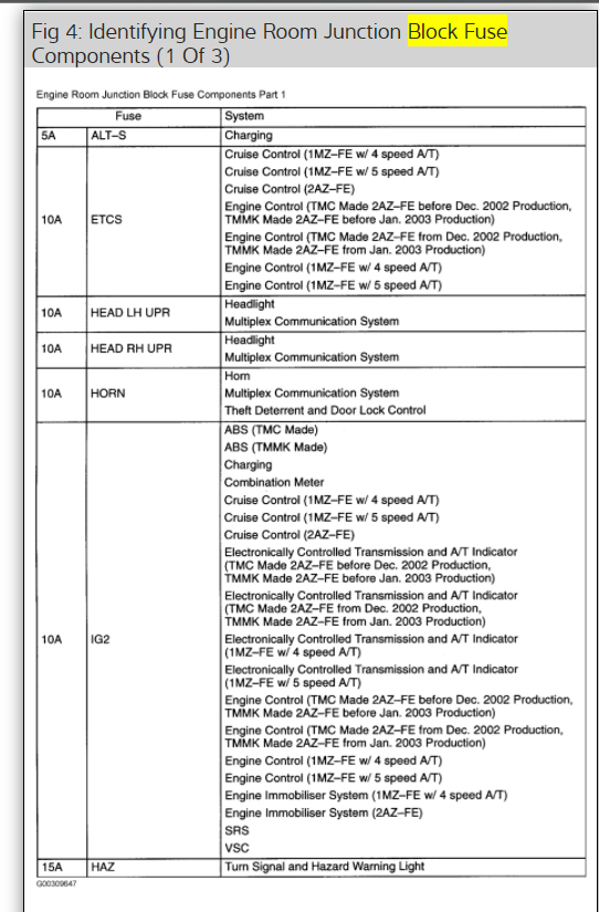

If I switch the ignition to on, all the dashboard lights is on except the battery light. When I start the car the engine is turning but does not want to start.
Tuesday, January 8th, 2019 AT 10:42 PM
KEN L
  • MASTER CERTIFIED MECHANIC
  • 48,313 POSTS

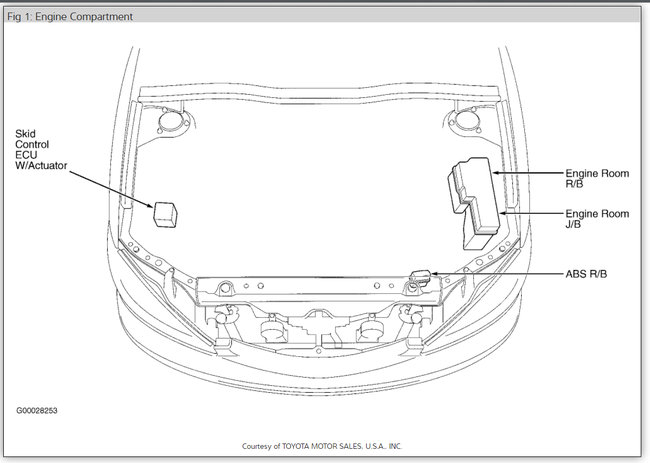

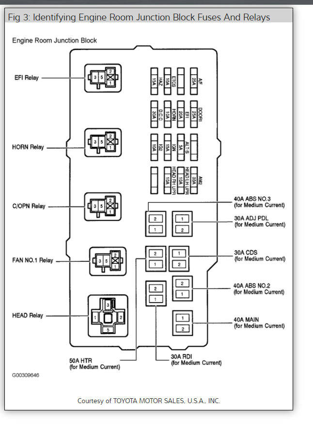

There is an IG2 fuse that needs to be checked. here is a guide to help check for power and the fuse location with this guide and the fuse location is below with the alternator wiring so you can see how it works:
