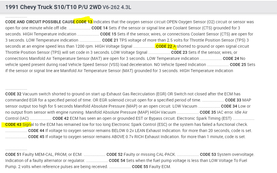

i bought the truck about 2 months ago and it does not want to idle when cold. Once it warms up it does fine but has a miss sometimes only at idle and the vacuum line from the throttle body to the PCV valve is hooked up. it won't idle well at all.

This could be a few things such as an EGR issue, an EFE valve, fuel mixture/pressure, and so on. Here is what I need you to do. We need to determine if there are diagnostic trouble codes stored in the computer.
This vehicle has an OBD1 system that doesn't require a scanner to retrieve codes. All you will need is a short jumper wire or even a paper clip.
Follow the directions in this link and let me know the results:

I got codes 13, 22 and 43.

The codes show a few different things. The two that have the most interest to me are the 13 and 22. This vehicle should have a throttle body injection, correct? If it does, the first thing to focus on is code 13. This indicates an open circuit with the oxygen sensor. Check to make sure nothing is damaged, the wiring is in good condition, and nothing has melted due to heat. If everything looks good, test the sensor.
Here is a link that explains how to check one:
https://www.2carpros.com/articles/how-to-test-an-oxygen-sensor-02-sensor
Also, I attached the descriptions below for each of the codes, so you have a reference.
See pic below.

Okay. So, I checked the wires to the TPS, and the 02 sensor and they all looked good and seemed to be working. So, I replaced both sensors and the truck will idle a little better but still smells rich and will shut off if you don't give it throttle for the first couple minutes after starting. And when you start driving it is a little sluggish for a few minutes then it's okay. I no longer have any codes when I check.
