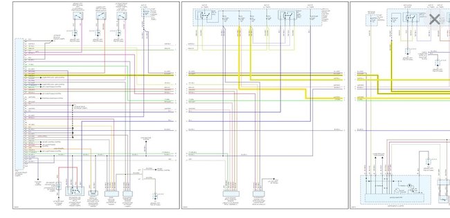

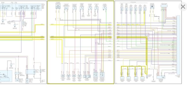

I parked my car and the next day wouldn’t start. so I check fuel pump and it working so I changed my plugs, my ignition coils and map sensor and cam shaft sensor and still will not start. I been breaking my head trying to figure out what going on with it. I’ve notice that when I crank it I only have fire going to my first coil the other three no fire going through. can anyone help me out maybe someone know what’s wrong?
Mar 18, 2019 at 9:54 AM

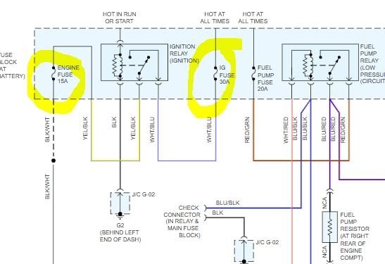

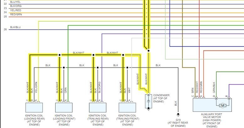

Good evening,
Check the fuses I circled in the diagram for power with the key.
I also highlighted the power wires to the coils. Verify power to all the coils.
Mar 18, 2019 at 11:28 AM

Thank you for the response I can’t really see diagrams to good they are blurry but I have checked all fuses. Okay, I have another question, is all ignition coils supposed to spark when I crank the engine? And I notice that my two trailing plugs have fuel on them and one of my leading has gas on it also the one that don’t is the one that sparks if that will help you any. I’m sorry to be a bother but I got a nice car that I can’t get running. thank you for your time.

Okay, do the coils have power as I showed in the diagrams I sent you?
Mar 19, 2019 at 10:08 AM
RICO210
  • 5 POSTS
I checked. no, they don’t. only one has fire going to coil.
Mar 19, 2019 at 10:52 AM
Okay, then you have a harness issue. They all are fed from the same wire to each coil. Somewhere in the harness, there is an issue.
