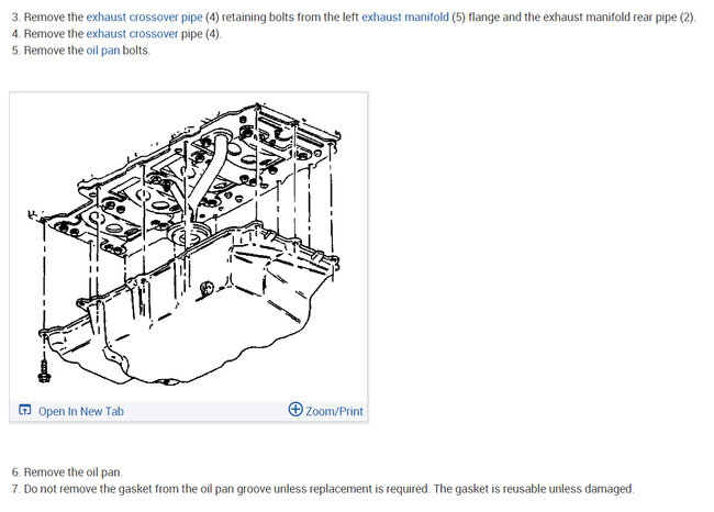

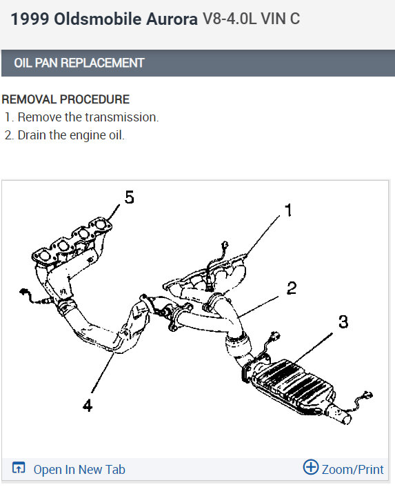

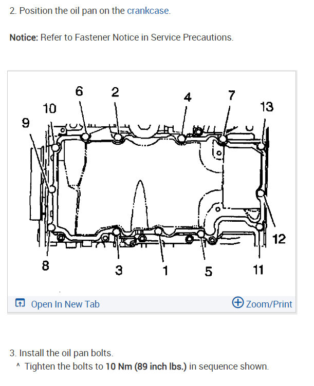

How to replace the oil pan?
1999 OLDSMOBILE AURORA
50,000 MILES • 4.0L • V8 • 2WD • AUTOMATIC
RUSSELLCORRADO
oil pan replacement.
Sep 12, 2024 at 12:56 AM
  • 55,394 POSTS
Here are the instructions on how to remove the oil pan which first you will need to remove part of the exhaust system so I would spray WD40 on the exhaust bolts before you begin and drain the engine oil. Check out the images (below). Let us know if you need anything else.
