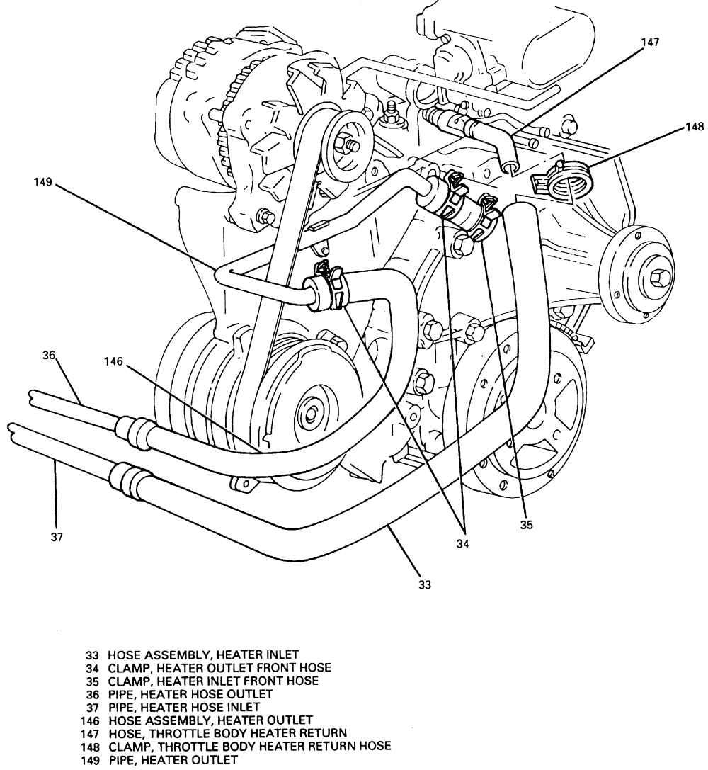

I need the name of this part
1995 CHEVROLET CAMARO
220,000 MILES • 3.4L • 6 CYL • 2WD • AUTOMATIC
JOSHUA COLLINS
The part that the heater hose connects to that connects to the intake has rusted out need replacing so I can reconnect hoses and refill with water and be on my way.
Jul 7, 2018 at 5:02 AM
  • 110,244 POSTS
I am not sure exactly which hose you are referring to, so I have attached a picture which shows all the heater core hoses and identifies the parts.
Let me know if this helps.
