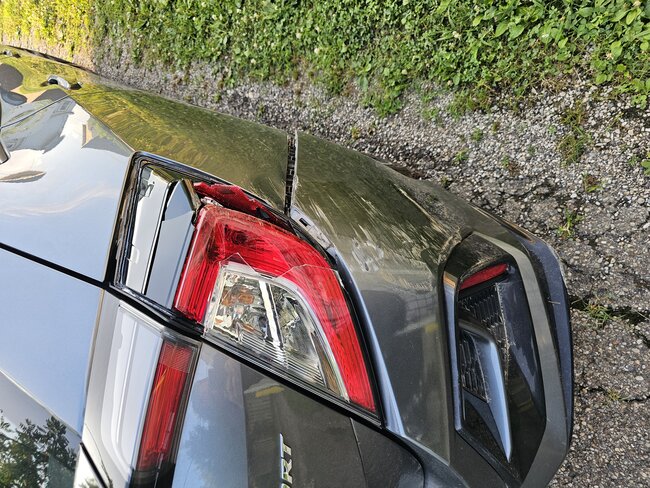

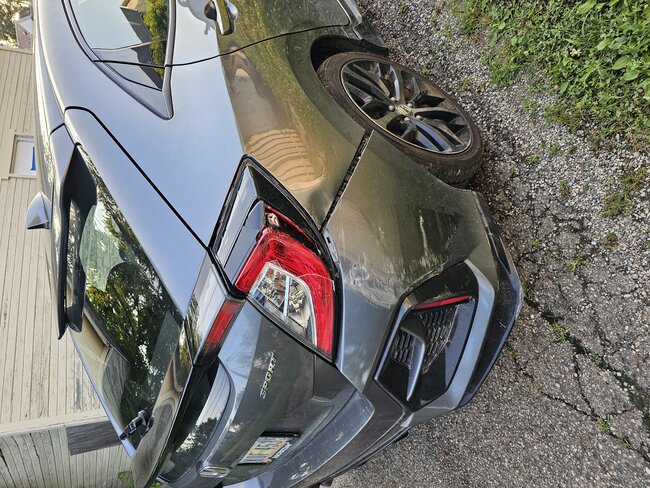

I backed into a telephone pole and busted the bumper cover and rear tail light and possibly something that Clips the bumper cover to the quarter panel I'm attaching pictures so somebody can help me identify specific part names of what I need to order to fix and maybe the cheapest place I can get it I'd hate to turn this into insurance and they jack up my monthly bill vin number SHHFK7H49MU227309 2021 honda civic hatchback sport

Yeah thats gonna need sanding shaping and paint to repair it properly gonna take a pro id say just get it done at a bodyshop .good luck

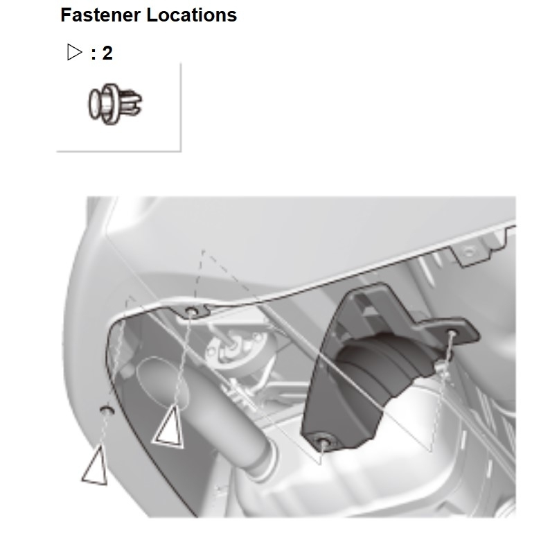

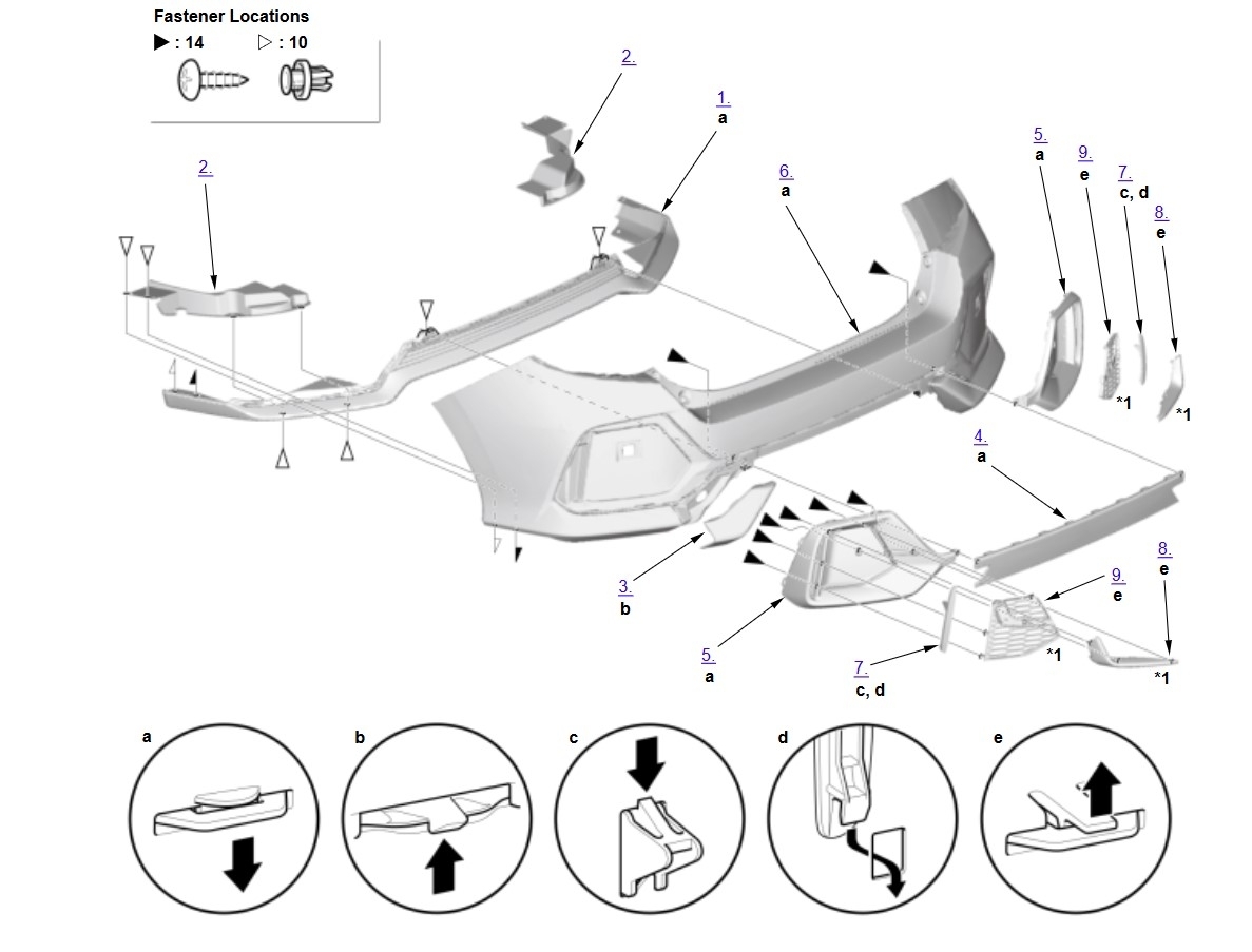

Unless you have the tools to repair the quarter panel and then paint and install the new bumper cover. Then calibrate the rear parking sensors, I would report it and have a pro do the work. Being it's a 21 it will need to have a pre and post scan done because of any damage as well. The attached shows the pieces involved with the BC itself. Removing the cover and replacing it isn't that hard, getting the paint to match though is the real trick.
