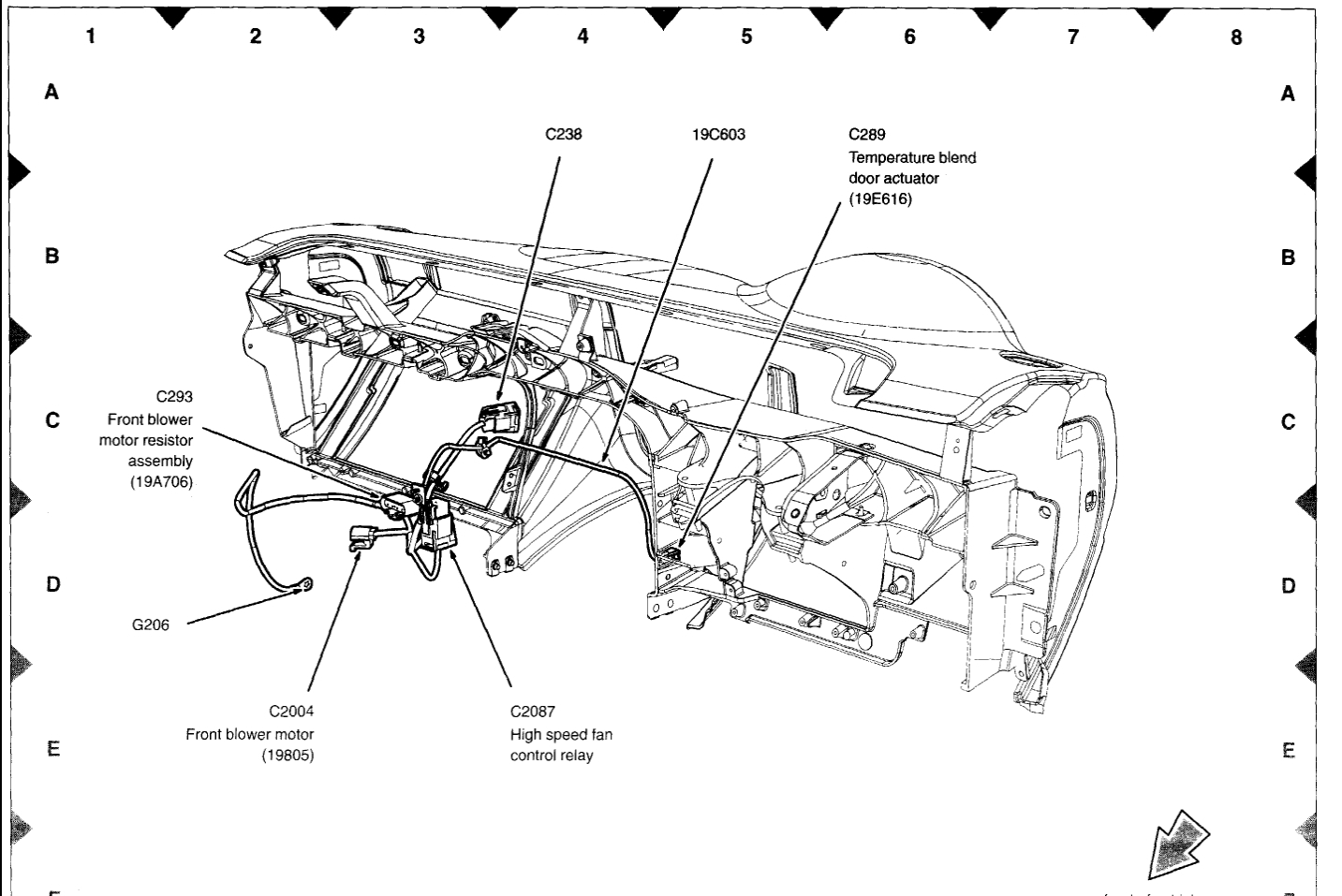

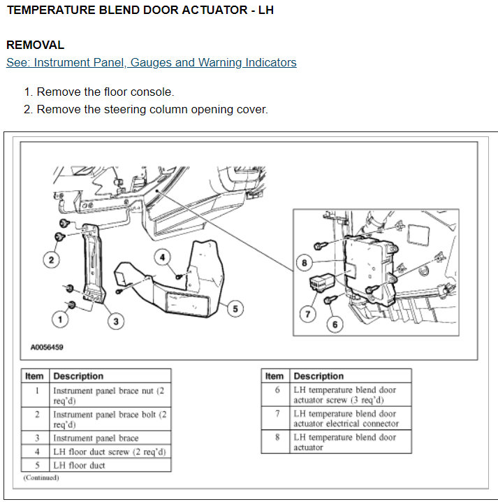

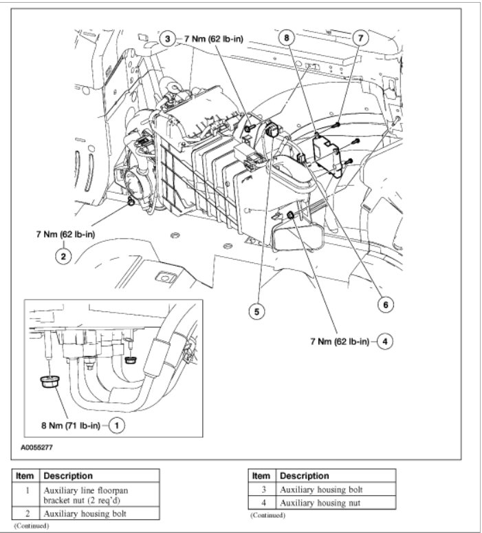

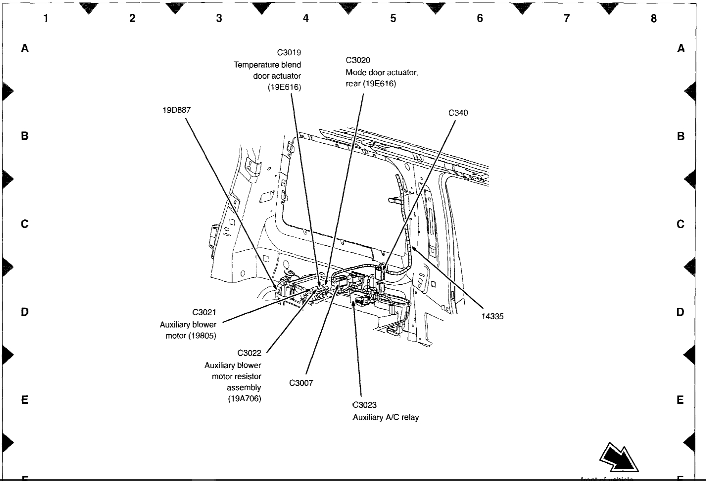

no air coming from my center console rear vents
2003 FORD EXPLORER
194,000 MILES • 4.0L • V6 • 2WD • AUTOMATIC
RANDON21
Air does come through the floor foot vents. There is a tapping sound coming from around the timing chain tensioner area it's very annoying. I don't know if it's the tensioner the timing chain or the front cassettes broken because sometimes the noise goes away for a few minutes.

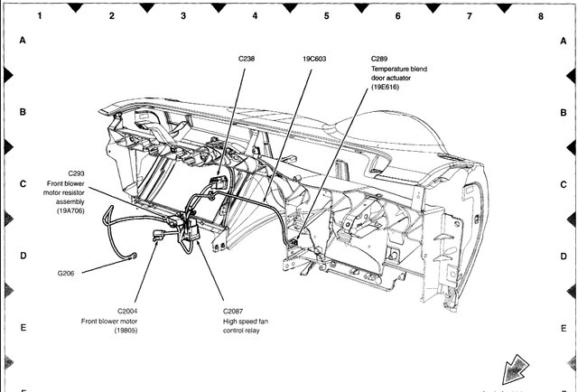

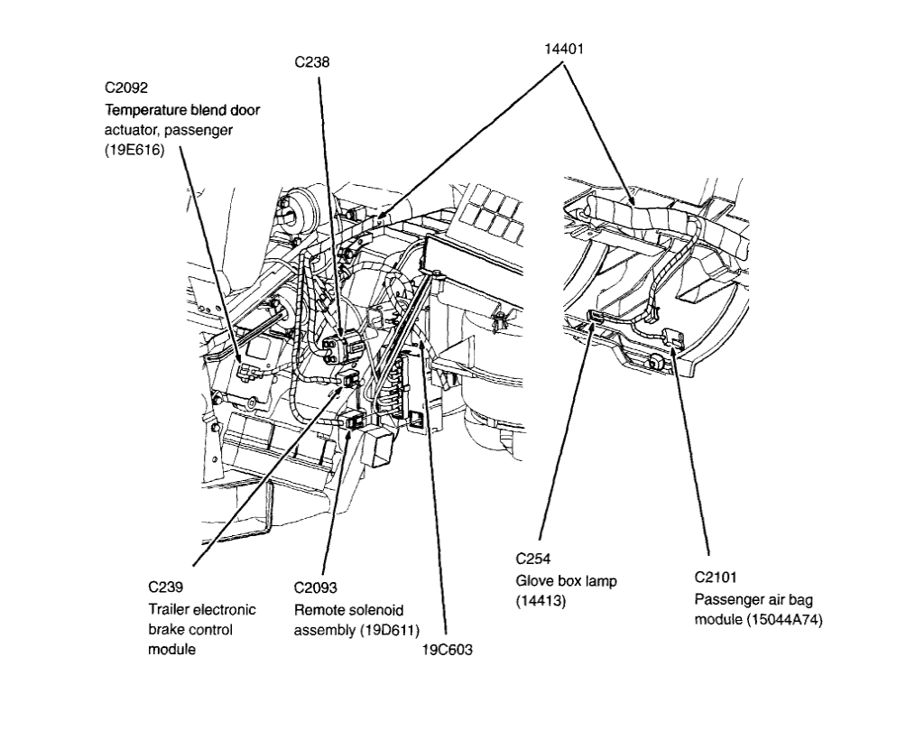

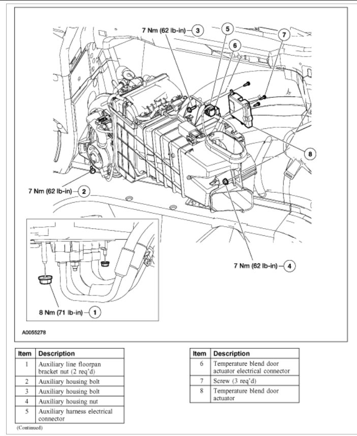

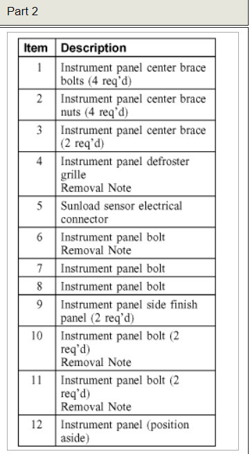

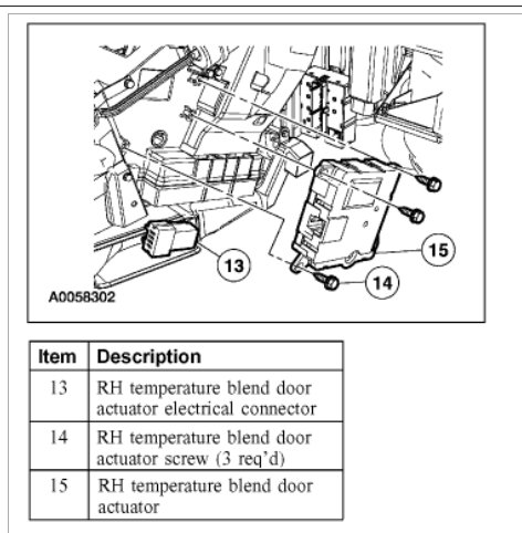

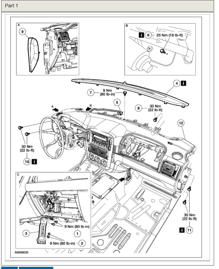

These are two different problems. we will handle the vent issue on this post you can repost. For the vent problem it sounds like the mode actuator is not working which is common. here is a guide to walk you through the steps and diagrams below to show you how on your car:
here are all the actuators so you can see how the system works. Check out the diagrams (below). Please let us know what you find. We are interested to see what it is.
