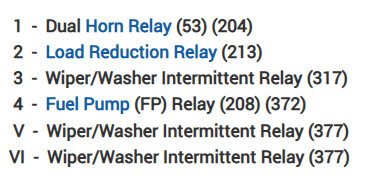

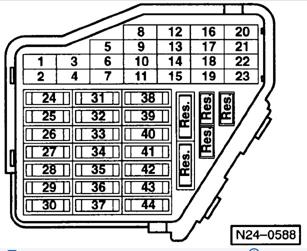

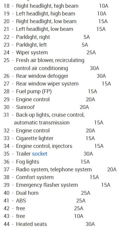

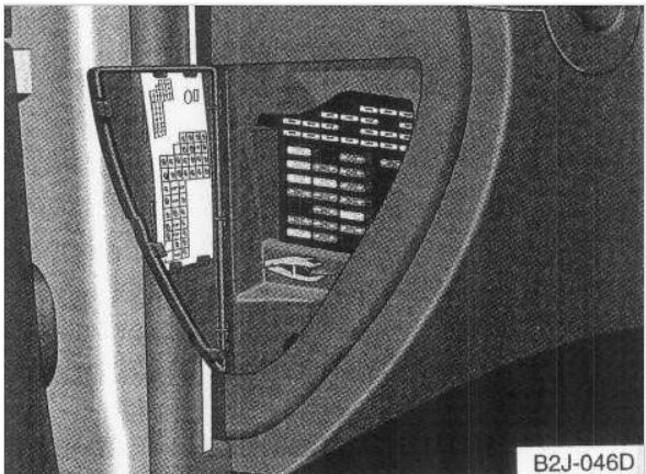

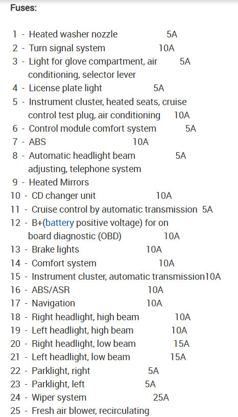

I have lost my owner's manual so i don't know what relays are what and i can't find a diagram for the relays so i know which ones are what or what fuses are what. please help me. thank you
Aug 5, 2025 at 1:47 AM
  • 55,770 POSTS
Which relays or fuses are you looking for? Here are the locations of some fuses and relays. Check out the images (below). Let us know how it goes.

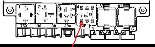

I'm looking for the relays under the dash i found one relay that was bad fuel pump relay. i think it was a gray fuse.
Aug 5, 2025 at 4:29 AM
JOSHMODE2
  • 14 POSTS
Gray relay
Aug 5, 2025 at 5:02 AM
  • 55,770 POSTS
The fuel pump relay is the fourth one from the left. Here is a diagram to help. Check out the images (below). Please let us know what happens.
