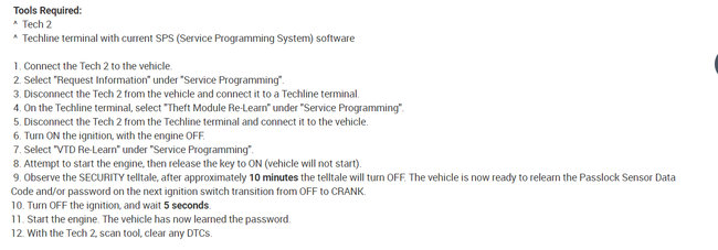

somebody drilled in my ignition out so I replaced it. now all my lights and stuff come on. I scare light stays on but it won't crank over. I tried jumping the solenoid it cranks it over but then shuts off. need help.
Jun 6, 2021 at 12:34 AM
Good morning,
This sounds like a security issue with the key.

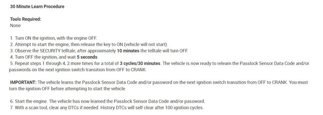

When you replace the ignition switch, you need to reset the password for the security system so it will crank and start. I attached a guide below for you to view on how to reset the system.
https://www.2carpros.com/articles/how-to-reset-a-security-system
There is a 10 minute relearn procedure that requires a scan tool. There is also a 30 minute that does not require a scan tool.
I attached both at the bottom for you to review.
