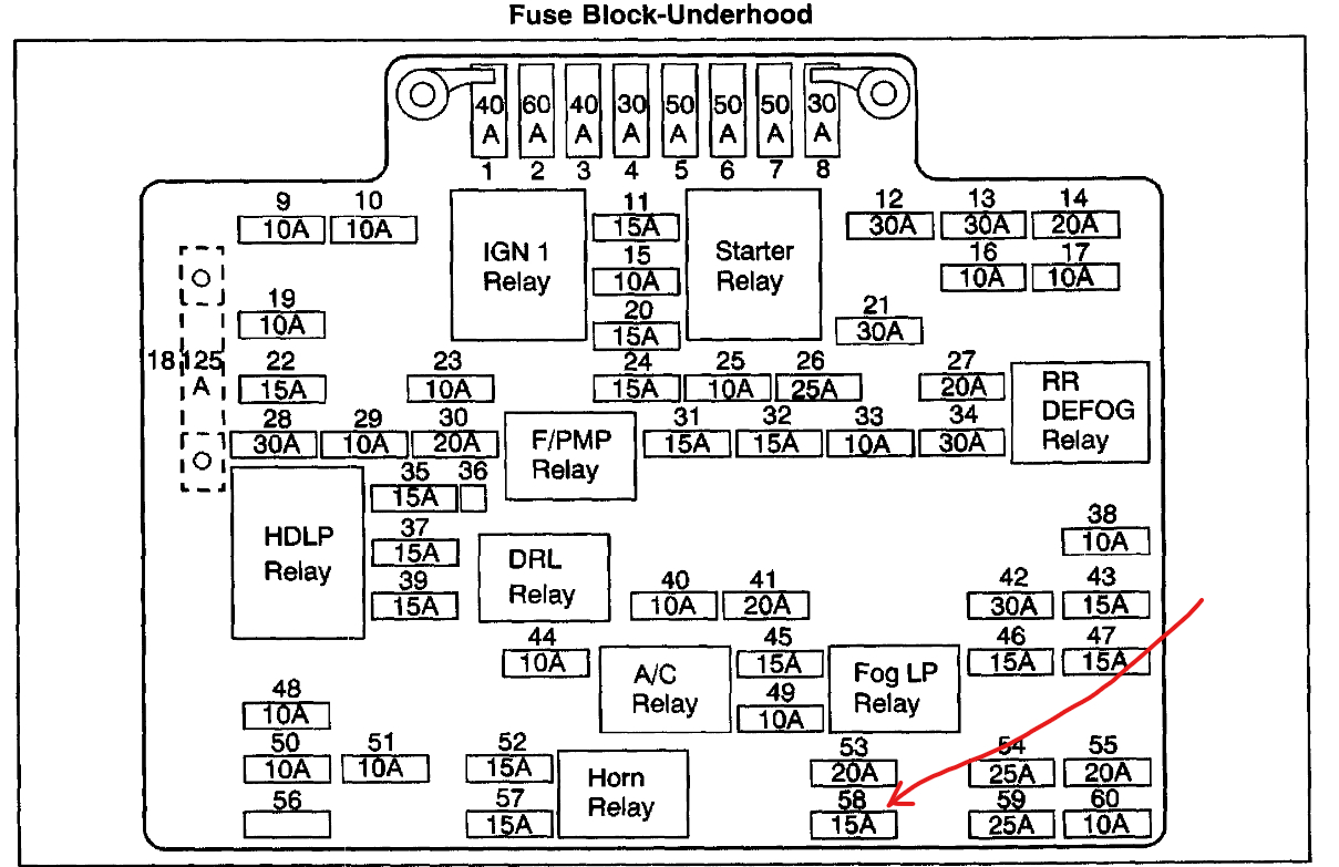

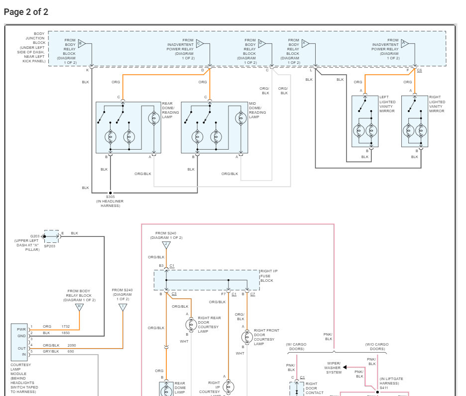

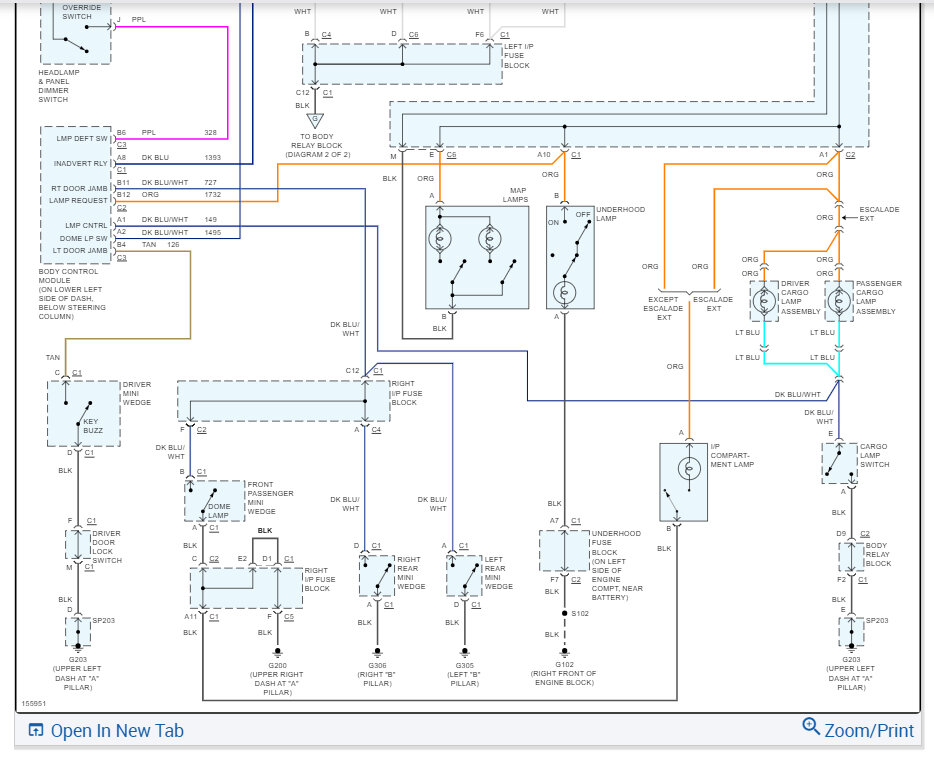

Got in my truck, opened doors and no dome lights came on. Checked the dome override switch and they still didn’t work. I tried pushing the map light buttons and they do not work either. Same issue for Borge front and middle map lights/domes.
Aug 28, 2023 at 7:36 PM
  • 55,433 POSTS
The first thing to do is check the CTSY LP fuse #58 in the engine bay fuse panel.
Here is a guide to help and the fuse locations as well:

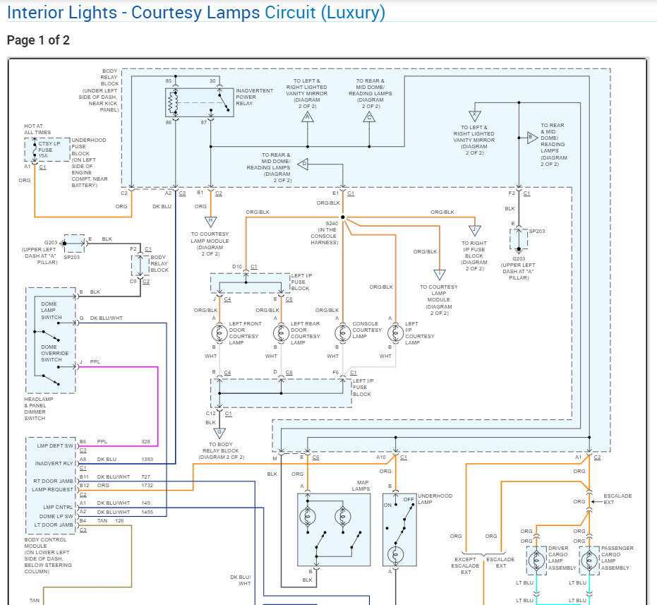

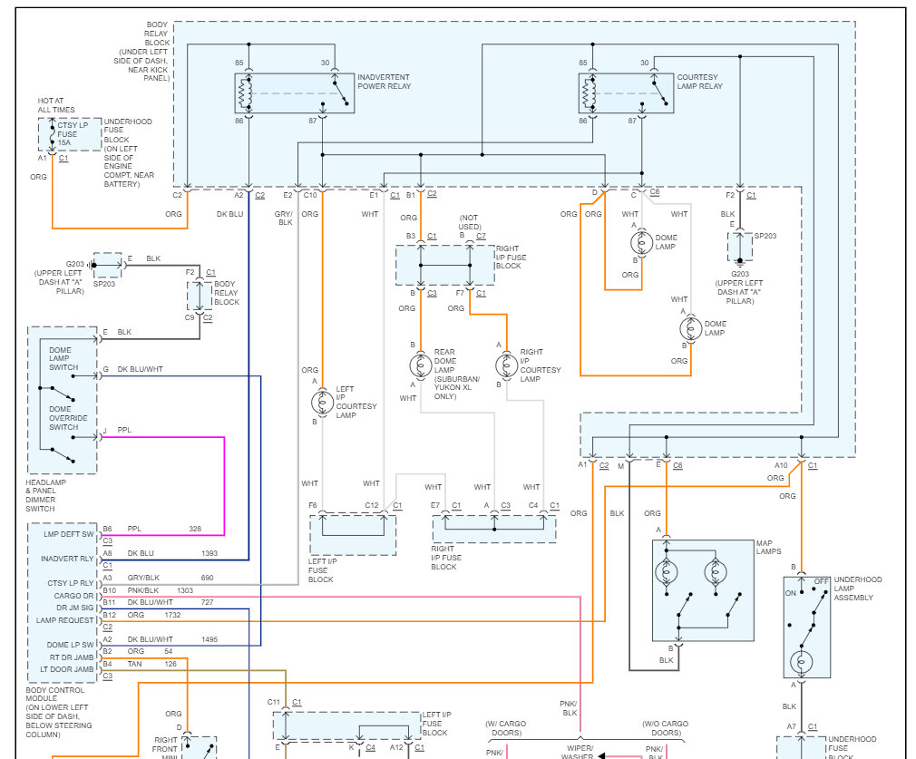

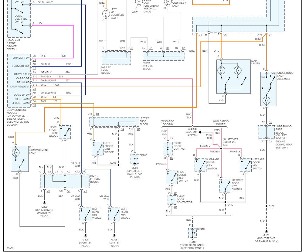

If the fuse is okay swap out the courtesy lamp relay i the left side fuse panel (BODY), this is for base models only. Here are the dome light wiring diagrams so you can see how the system works. Check out the images (below). Please let us know what happens.

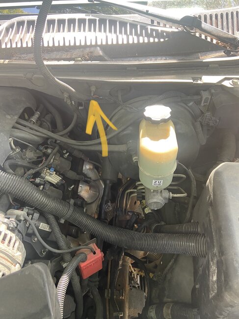

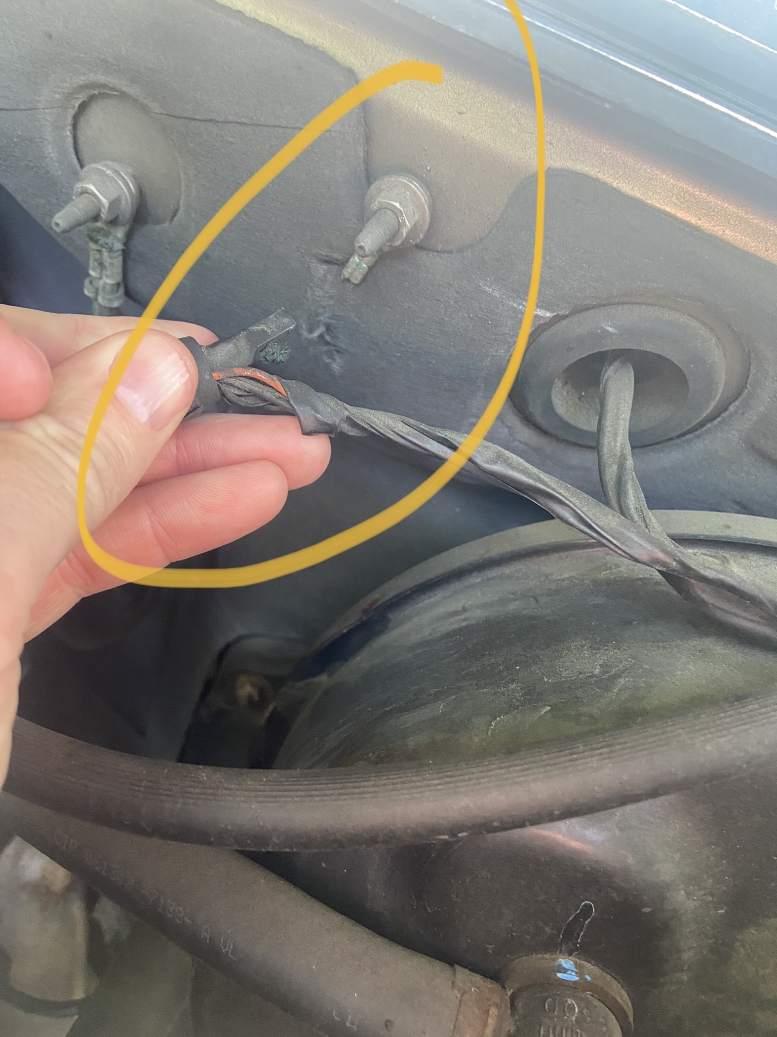

Ken. I didn’t check all the bulbs, but a ground wire looks like it snapped off from the connector. I am going to see if this fixes the problem. Any advice on this? The ground wire I question runs up to the hood light and into the firewall.
Sep 10, 2023 at 3:20 AM
  • 55,433 POSTS
Is that a wire that is broken? If not, this will not be the problem, you can try fixing it to see if the fuse blows, the under-hood light can cause the fuse to blow, can you check it to see if it was overheated?
