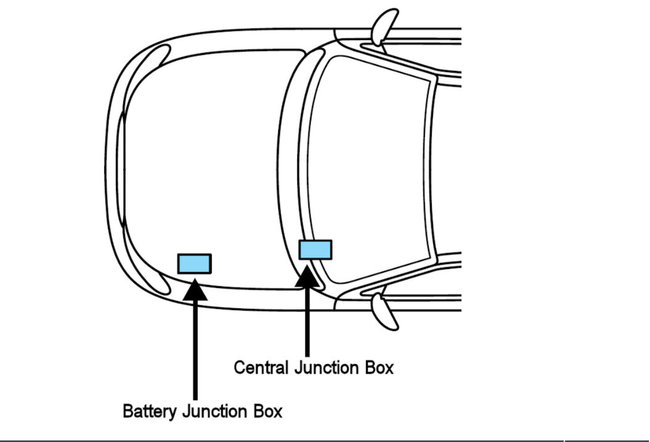

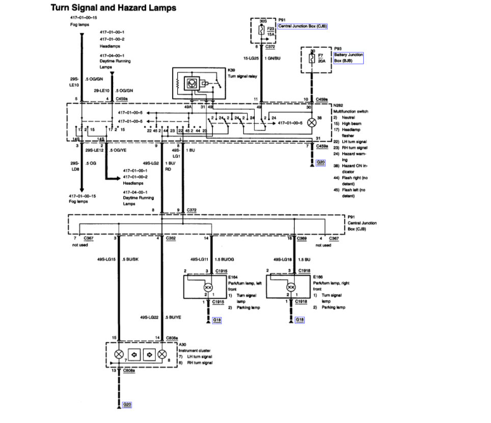

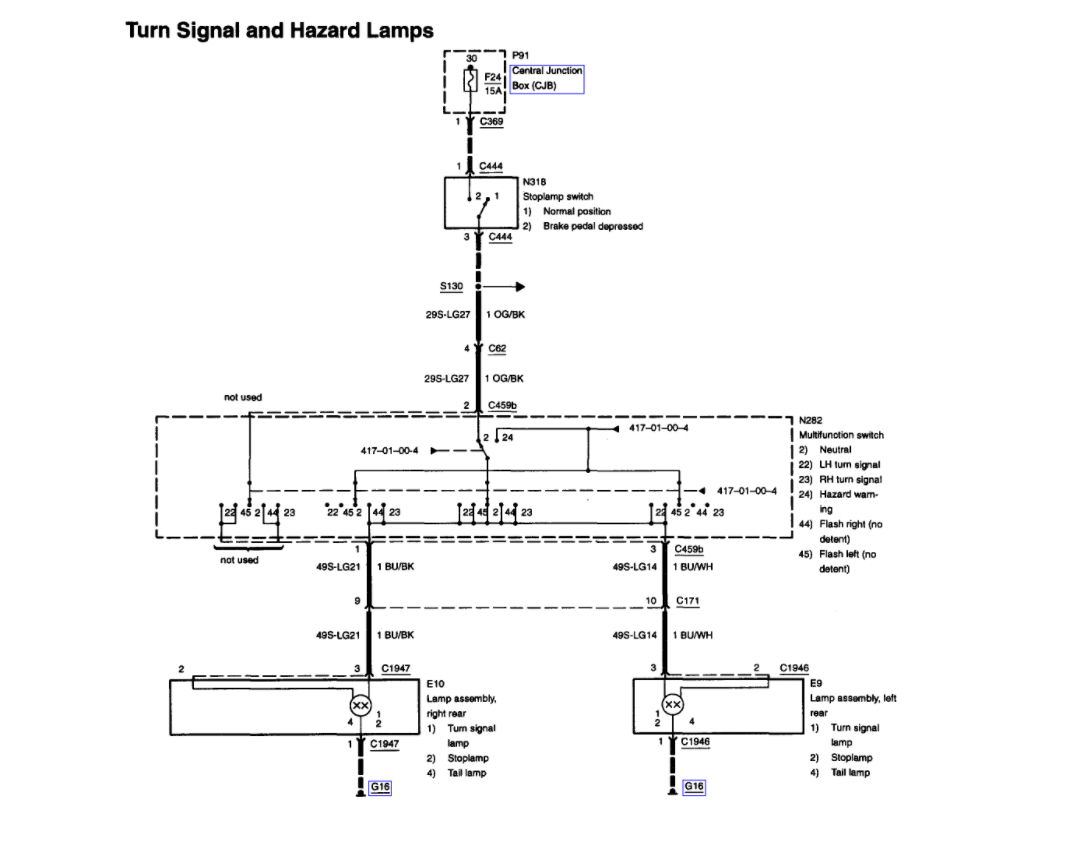

Light won't turn off.
Jan 26, 2020 at 12:29 PM
SCGRANTURISMO
  • 4,897 POSTS

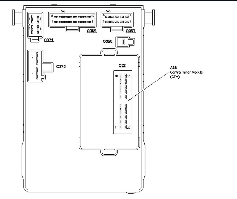

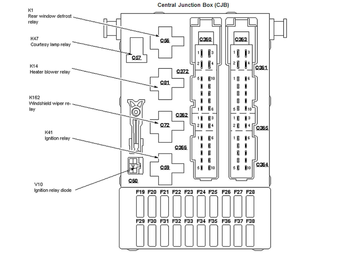

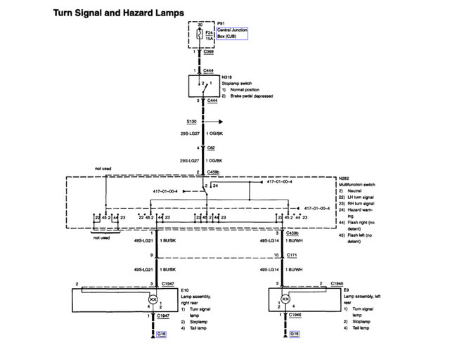

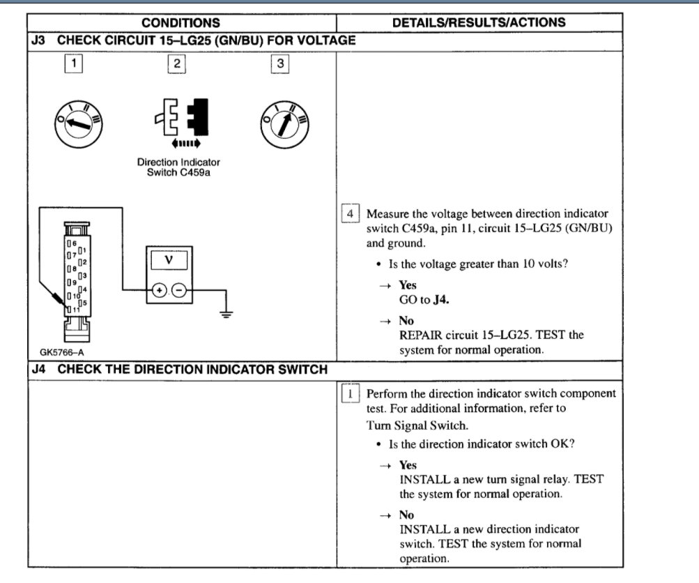

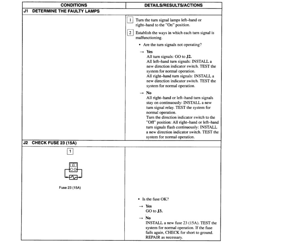

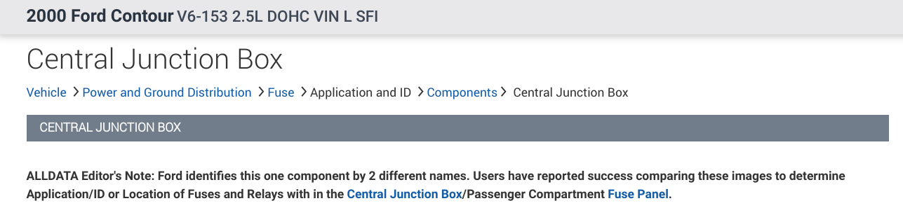

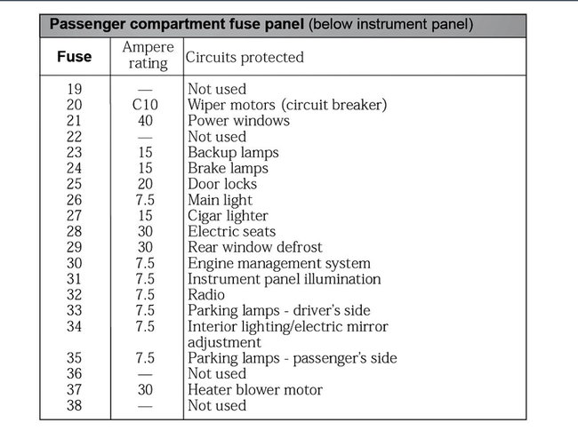

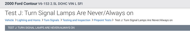

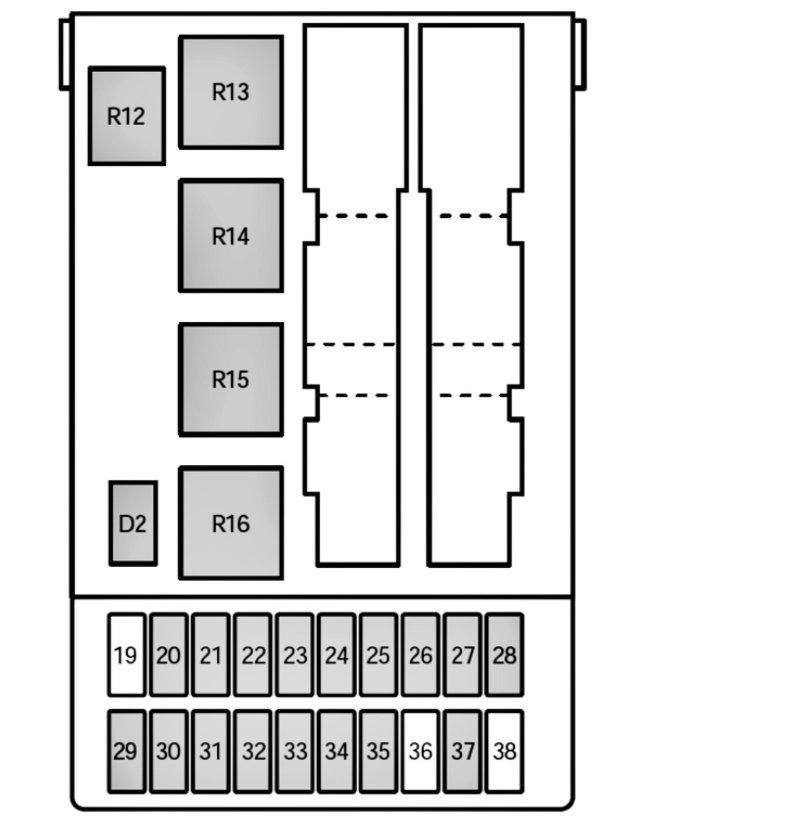

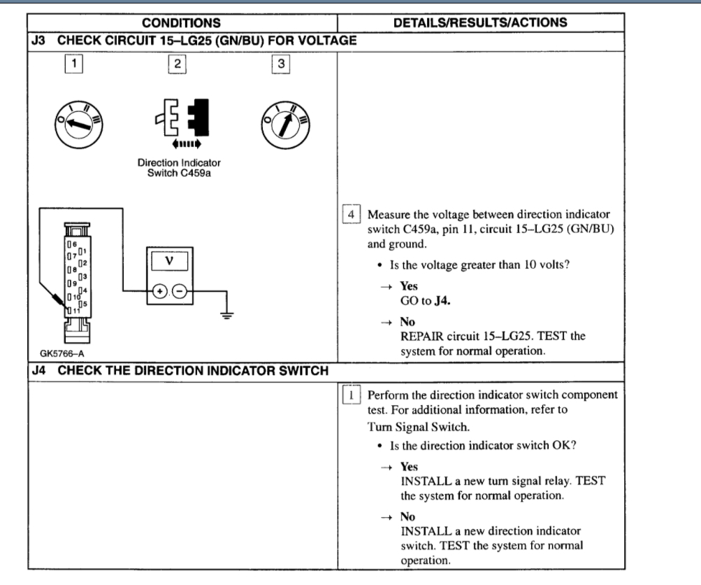

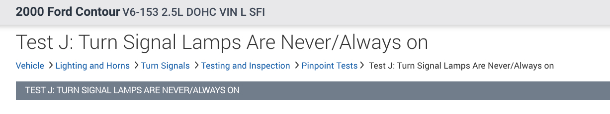

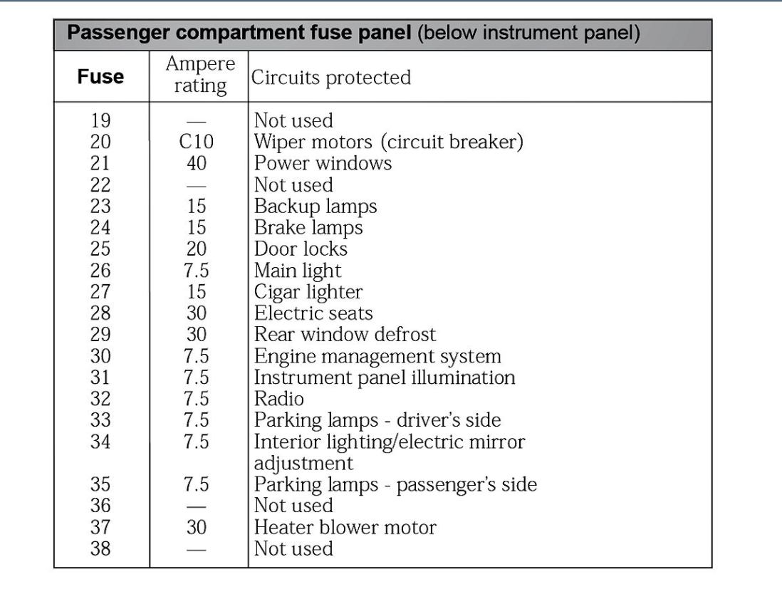

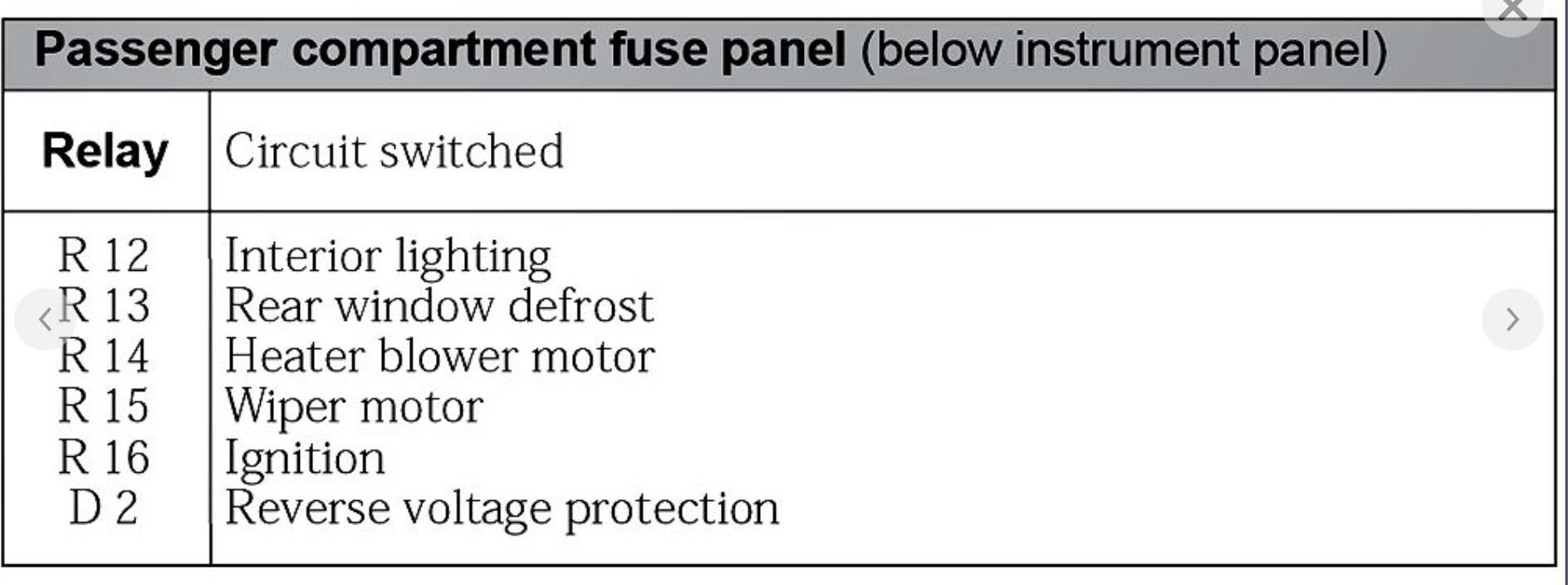

In the diagrams down below I have included the diagnostic trouble shooting guide for the turn signals not turning off, the diagrams for the location, layout and callout of the Central Junction Box, as well as the wiring diagram for the turn signal circuit. Please go through these guides and get back to us with what you find out.
