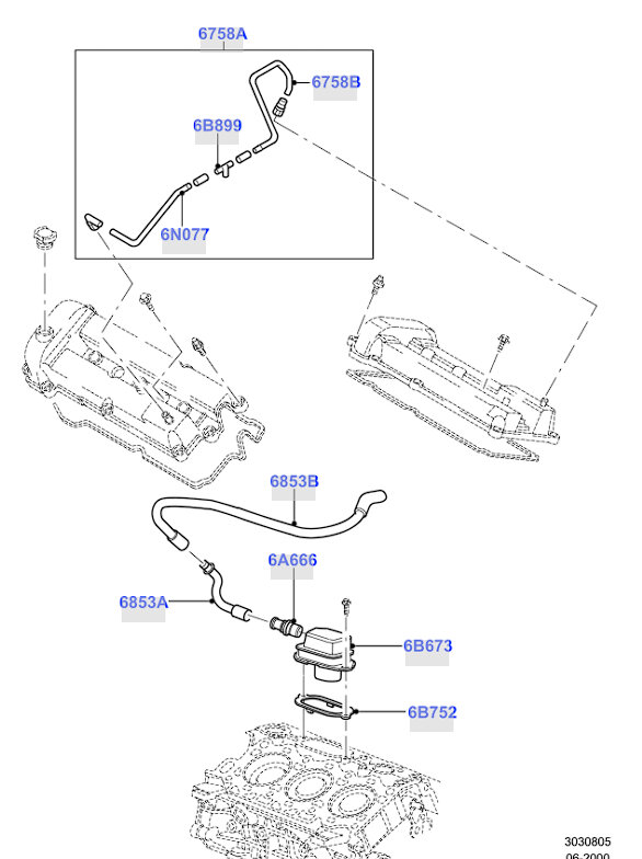

Have replaces spark plugs and coils, idle sensor, throttle position sensor, intake is new and put it back together and idles at 2,600 RPMs. I have reset the computer. Have done everything but take to junkyard. No codes now. No engine power, Replacing vacuum lines now, any suggestions?

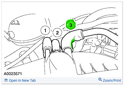

A vacuum leak would definitely cause a high idle and lack of power. The soft rubber connections on the PCV hoses can rot out over time due to oil contamination. Carefully inspect all of your vacuum lines, fittings and connections for damage. Please let me know what you find.
