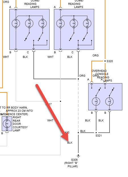

Does anyone know what color the ground wire is on my Escalade? Everytime I turn it on my driver side taillight stops working. If anyone knows I would be grateful

its ' black and connects to right B pillar, one between front and rear doors. see pic. it's same ground for all dome lights.

also check ground on lh side of dash as that is where the headlight switch grounds. However if those are ok then have it scanned as it may be a body module problem. auto parts cannot scan for this.
