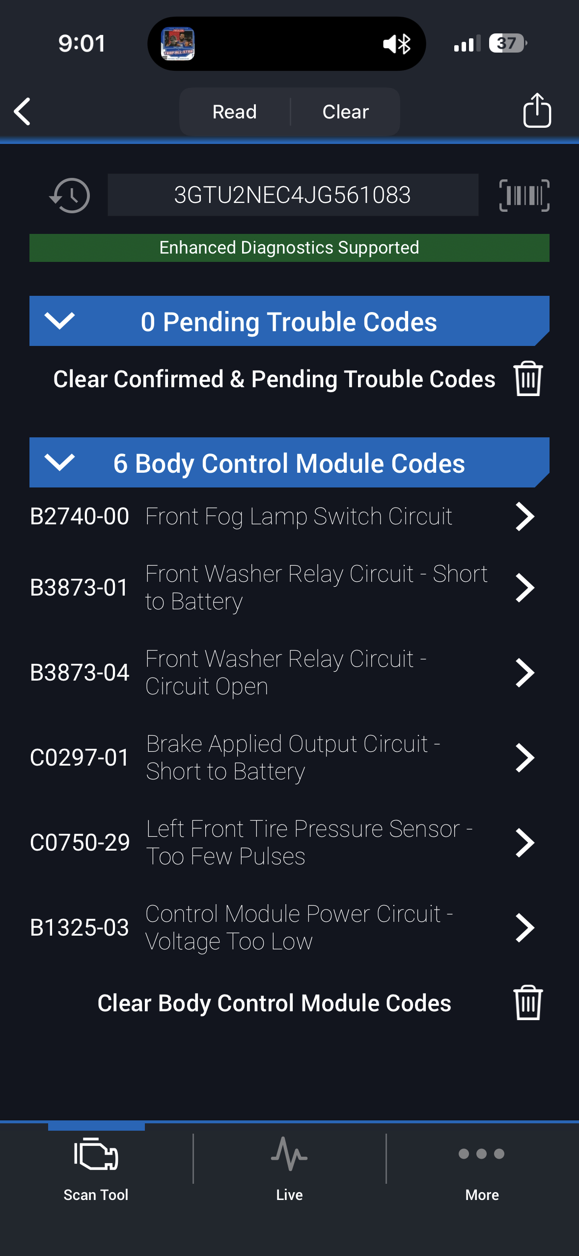

These are the codes I got. I’m clueless with gm electronics so I’m not sure what to do.
Jul 16, 2026 at 6:02 PM
  • 55,696 POSTS
Yep, that is a CAN scan, if the truck had no problems before it looks like a ground wire was left off. Did you remove any ground wires while doing the job?

hello, I was just curious, are you able to access the BCM's live data? see if there are any inputs that are staying On or look different than the other switches when the doors are closed, interior lamp switch off and it says off in the BCM's live data stream. This is important.
If you see it reading On, then you know which circuit to start checking. The first code B2740 is Front Fog lamp switch- Short to ground. But I think you will see something in the live data of the BCM. The module is going to sleep after the truck is off and the lamp turns out, but when its still awake its leaving the interior lamp on.
Which codes come back first when you just turn the key On, engine Off? The BCM will wake up with the key On.,

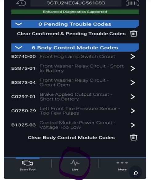

You were able to pull codes from the BCM, so with that access to the BCM (in most cases) you should be able to see the BCM live data PIDs.
What scanner do you have? Ill look up the specs on it. And do these codes come right back at key On? What is the "Live" option at the bottom of the screen there? I know it can be easy to miss special options things on scan tools, believe me, I do it all the time. Just need to dig into the scanner a bit more to find the hidden functions.
