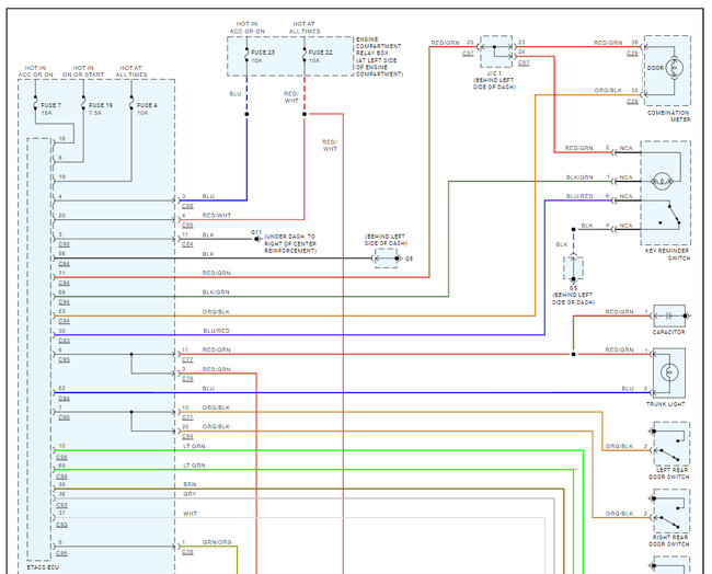

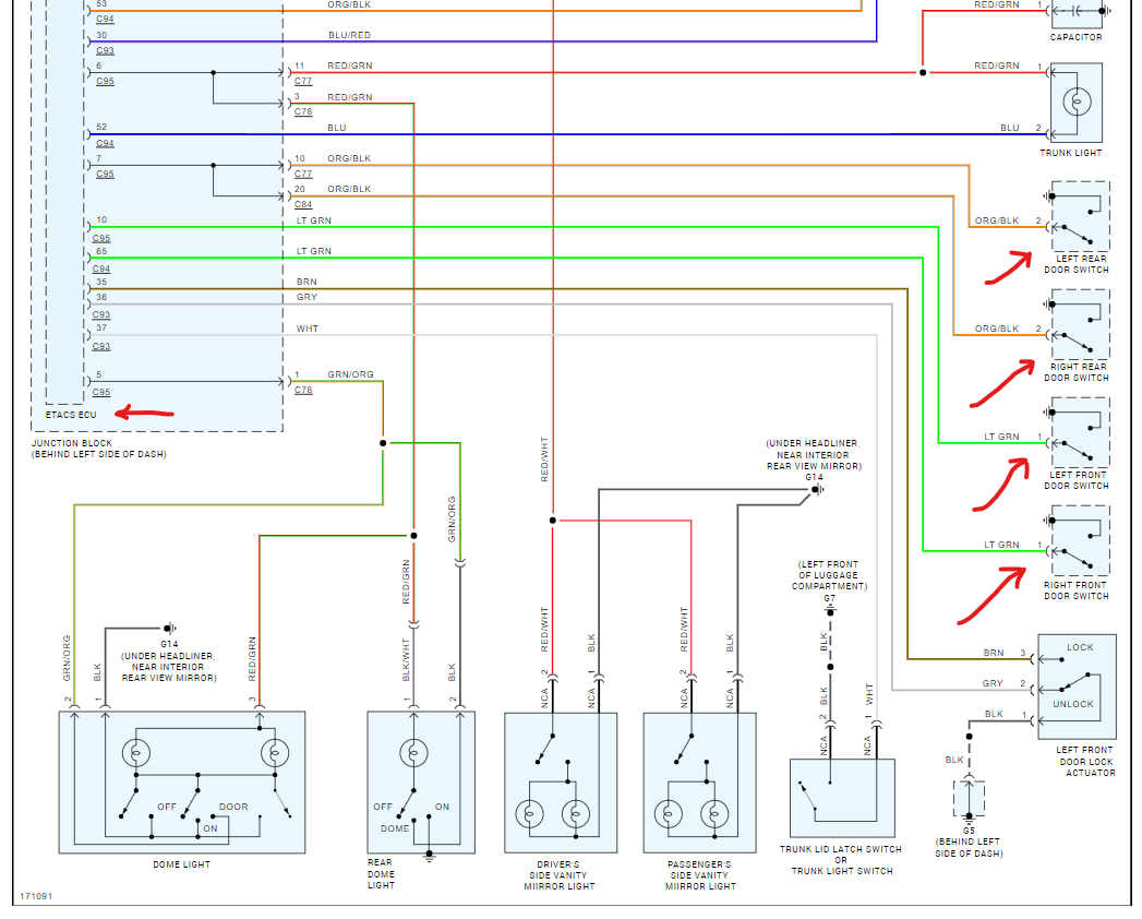

The dome light doesn't turn off like the switch doesn't work and is definitely draining the battery what needs to be replaced to fix the issue.

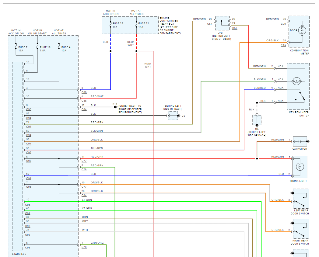

There are four dome light switches, one at each door, any of these can be bad and grounding the circuit causing the dome light to stay on. I would unplug them one at a time to see if the problem goes away. Also, the dome lights are controlled by an ETACS module that might be bad as well, but I think we should start with the door switched, here is a wiring diagram for the dome light so you can see how the system works. The switches are in the door jam. Check out the images (below). Please let us know what happens.
