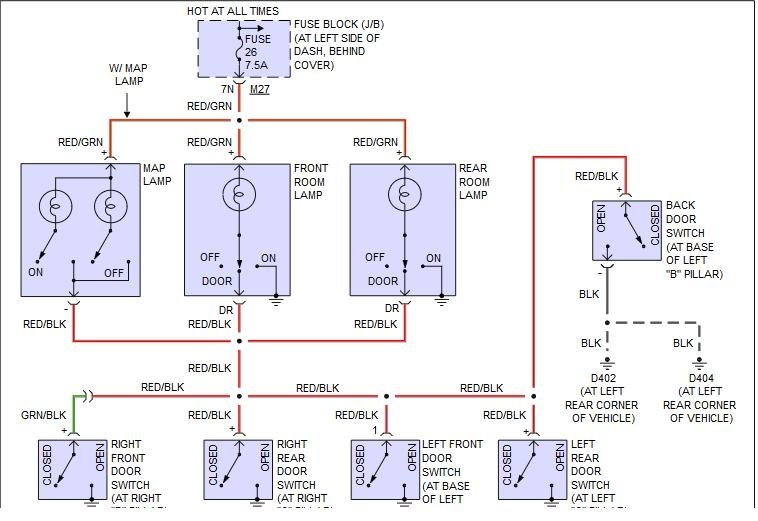

sparked when replacing a center dome light now some electrical is not working

while replacing a center dome light bulb, a spark occurred shutting off all power to all four dome lights.
dome lights do not function and car power door locks do not operate when the key is off.
power door locks will not lock any door with key off.
i have checked all the fuses and they are all intact and good to go. could there be another fuse box besides the one under the hood ?
please help, thank you in advance. Albert

See image for schematic and fuse location.
