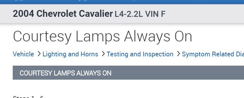

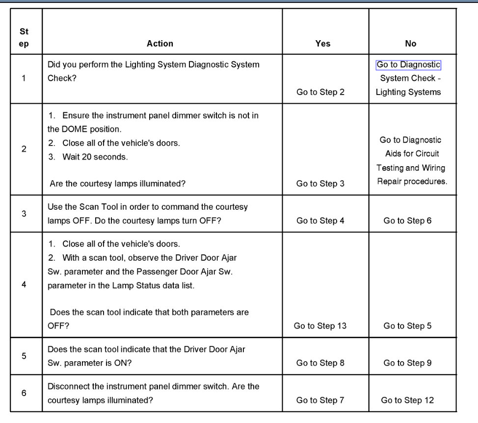

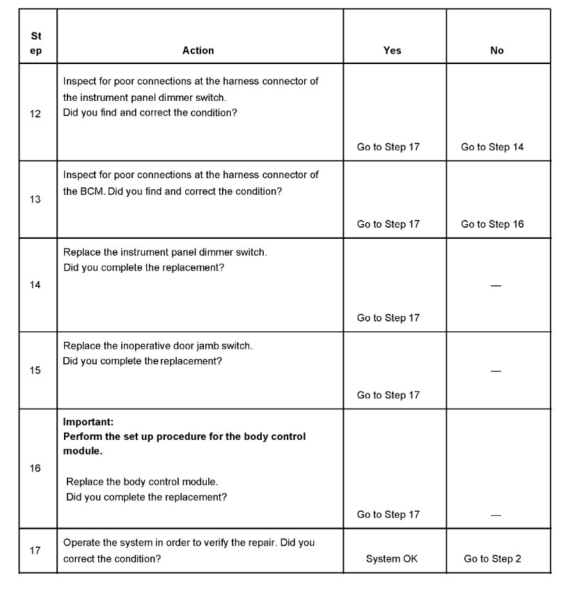

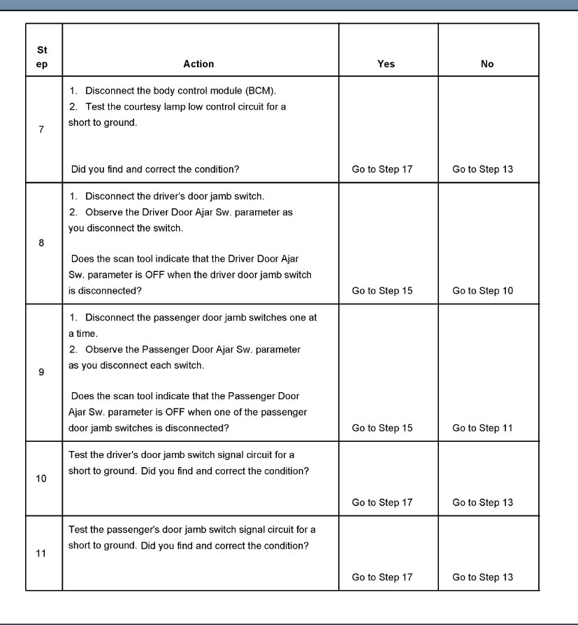

My dome/overhead light in my car will not shut. I checked fuses and door switches already and I can't seem to track down the issue.
Feb 21, 2019 at 8:42 AM
SCGRANTURISMO
  • 4,897 POSTS
I have included for you in the diagrams below a manufacturer troubleshooting flowchart for your vehicles problem. Please go through it and get back to us with what you find out.
