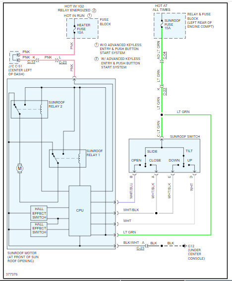

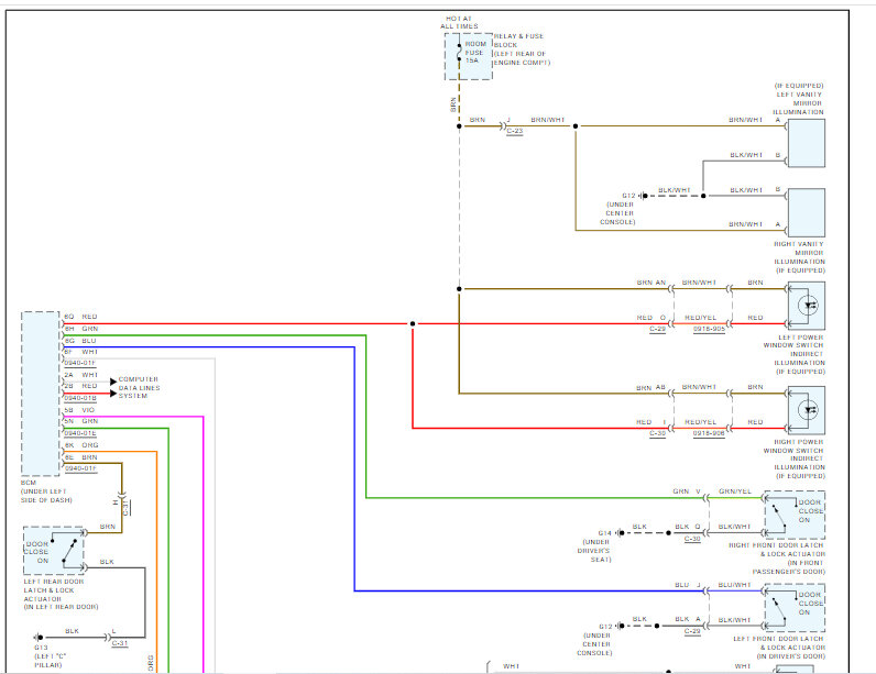

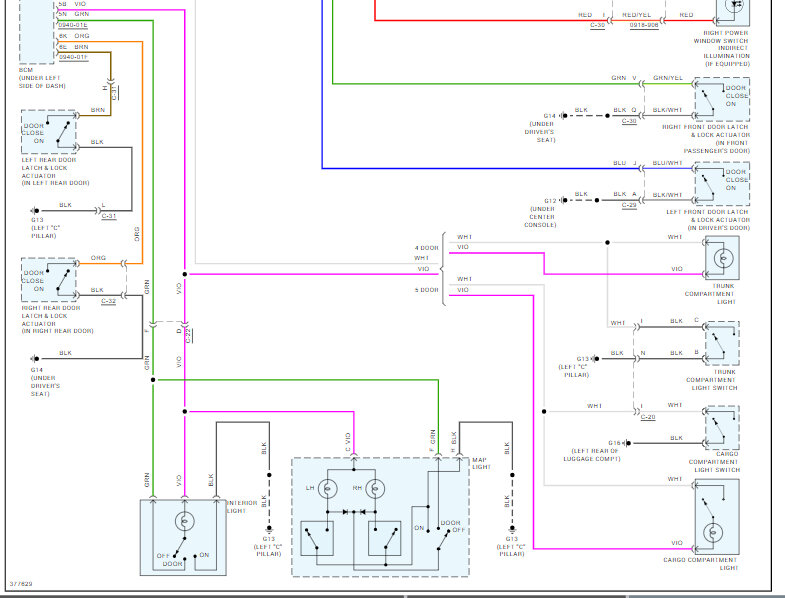

I want to install autodimming mirror.
So, I need a wiring diagram for dome light or sunroof.
Thanks
Jun 15, 2024 at 11:03 AM
  • 110,244 POSTS
I attached the wiring schematic for the interior courtesy light circuit. Let me know if this is what you wanted.
Also, I had to cut the pic in half to make it readable. I did overlap the two so you can follow from one to the next.
Let me know if this helps.
joe

Do you also have for sunroof window?
Jun 15, 2024 at 12:20 PM
  • 110,244 POSTS
Yes, I do. I should have attached both. Sorry about that. Take a look at the pic below and let me know if that is what you need.
See pic below.
