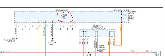

I was aware of the dome light and cargo light not working when i got the truck, however after adding power mirrors i noticed they didn't work as well. Radio works fine with no issues, however i did notice when i pulled the dome light down the connector looked a bit burnt. could this possibly be a ground issue?

As far as the connector, heat can cause them to look burnt. Is it possible for you to upload a picture of it so I can see it?

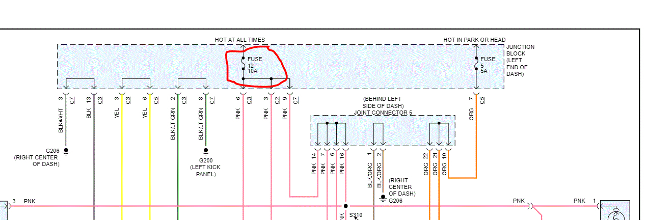

As far as the dome lights, have you checked the fuse? It is on the left side end of the dash. I attached a pic of the fuse responsible for the dome light. See pic 1

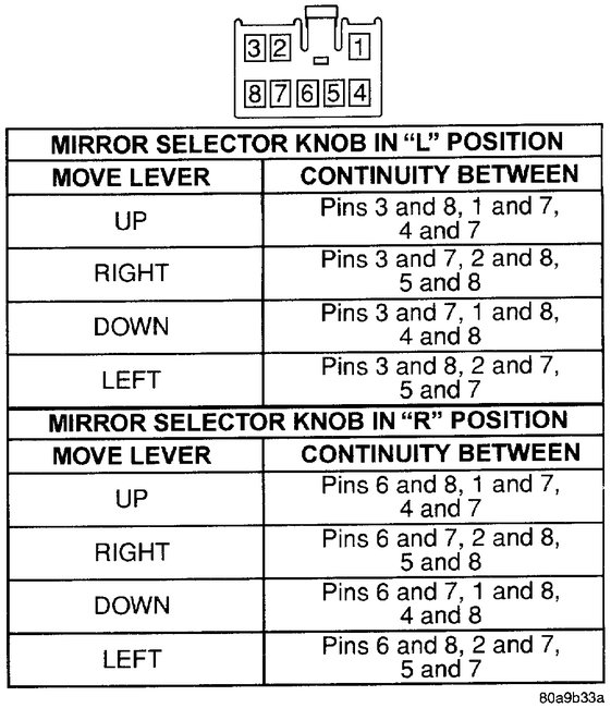

As far as the mirrors, did you install an OEM type mirror and wiring? If so, here are directions for trouble shooting. The remaining pics correlate with these directions.

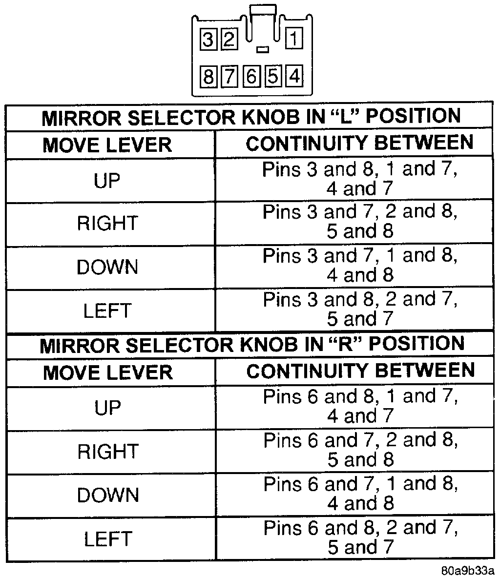

Power Mirror Switch Continuity
pic 2
5. Check the power mirror switch continuity. If OK, go to Step 6. If not OK, replace the faulty switch.

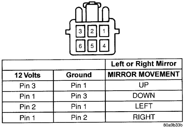

Power Mirror Test
pic 3
6. Unplug the wire harness connector at the inoperative power mirror. Use two jumper wires, one connected to a 12 volt battery feed, and the other connected to a good body ground. See the Power Mirror Test chart for the correct jumper wire connections to the power mirror half of the power mirror wire harness connector. If the power mirror(s) do not respond as indicated in the chart, replace the faulty power mirror assembly. If the power mirror(s) do respond as indicated in the chart, repair the circuits between the power mirror and the power mirror switch for a short or open as required.
