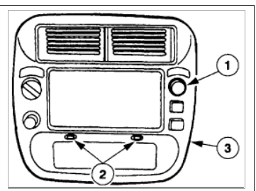

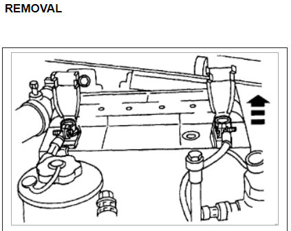

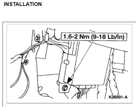

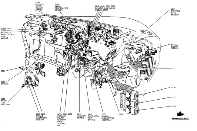

Dome lights stay on for over thirty minutes after closing the door, vehicle off.
Jan 3, 2018 at 2:15 AM
Experienced Mechanic
55,711 POSTS
This is a common problem with these trucks. It sounds like the GEM is out and needs to be replaced. Here is its location.
