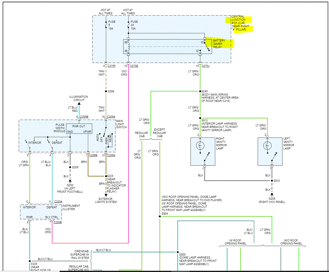

My symptoms are; when driving sometimes parked for hours and the dome lights and rear box lights come on, no door ajar light comes on. Last time driving it turned on and turned the switch on and off and light went off. Today a service guy came and said my dome lights were on. Looked hour later and they were off by them self. Question is, do you think it is the dimmer switch? I'm guessing it is. Thank you!
Nov 17, 2021 at 6:44 AM
  • 110,244 POSTS

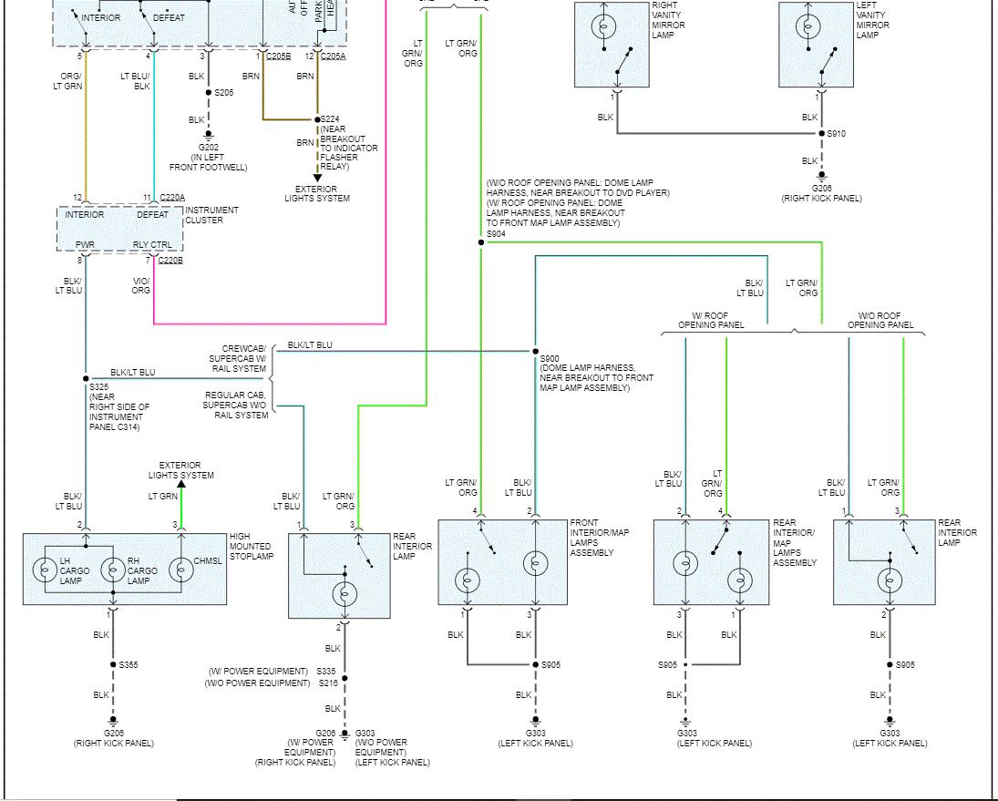

This could be the switch or the battery saver relay. I attached the wiring schematic below for your reference. I had to cut it in half to make it readable for you, but I did overlap them.
