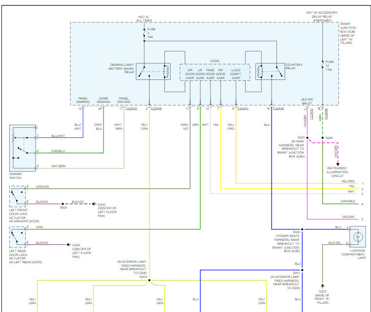

I need a wiring diagram and location of the wires for the dome light.

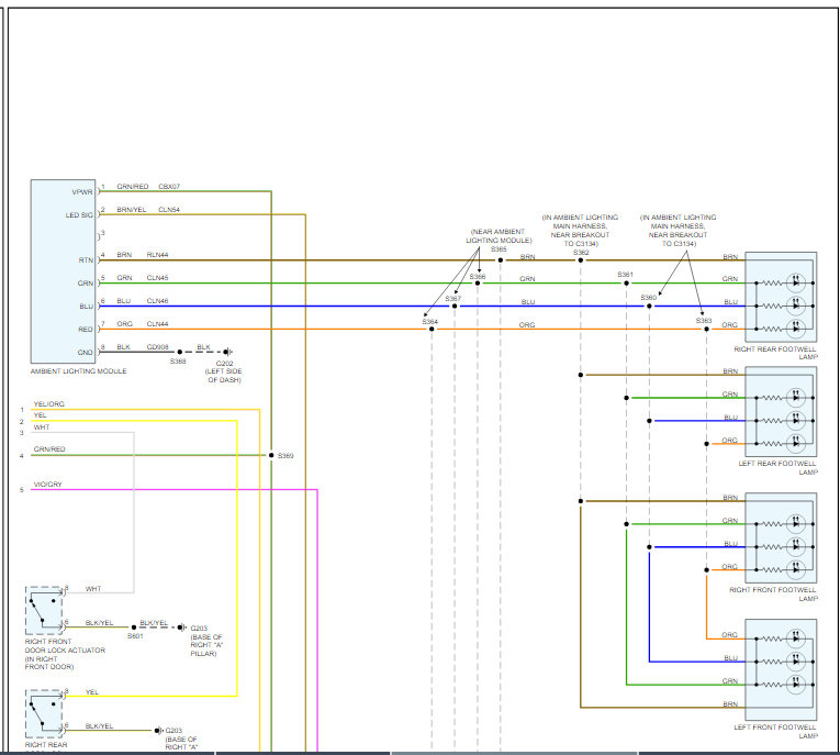

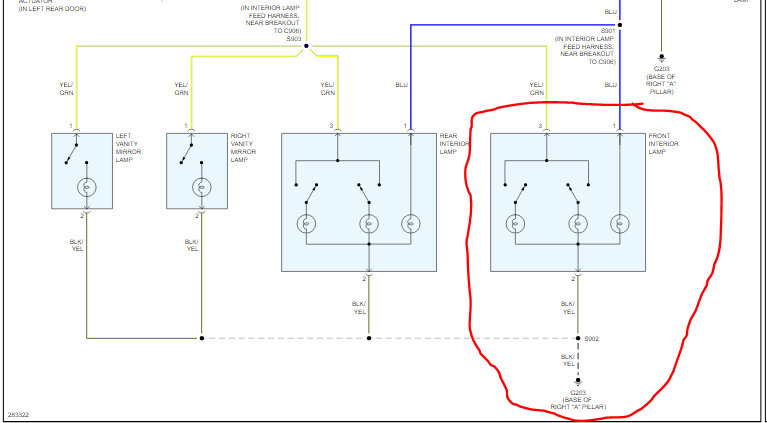

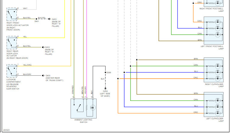

Here is the wiring diagram you've requested. I've cut both pictures in half so you can view larger. I've circled the dome light in red. Hope this helps and thanks for using 2CarPros.

Thank you so much it was perfect.
