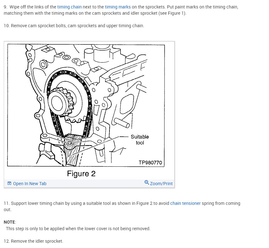

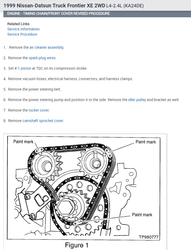

See attached for the timing chain marks and procedure.
Let me know of any questions.

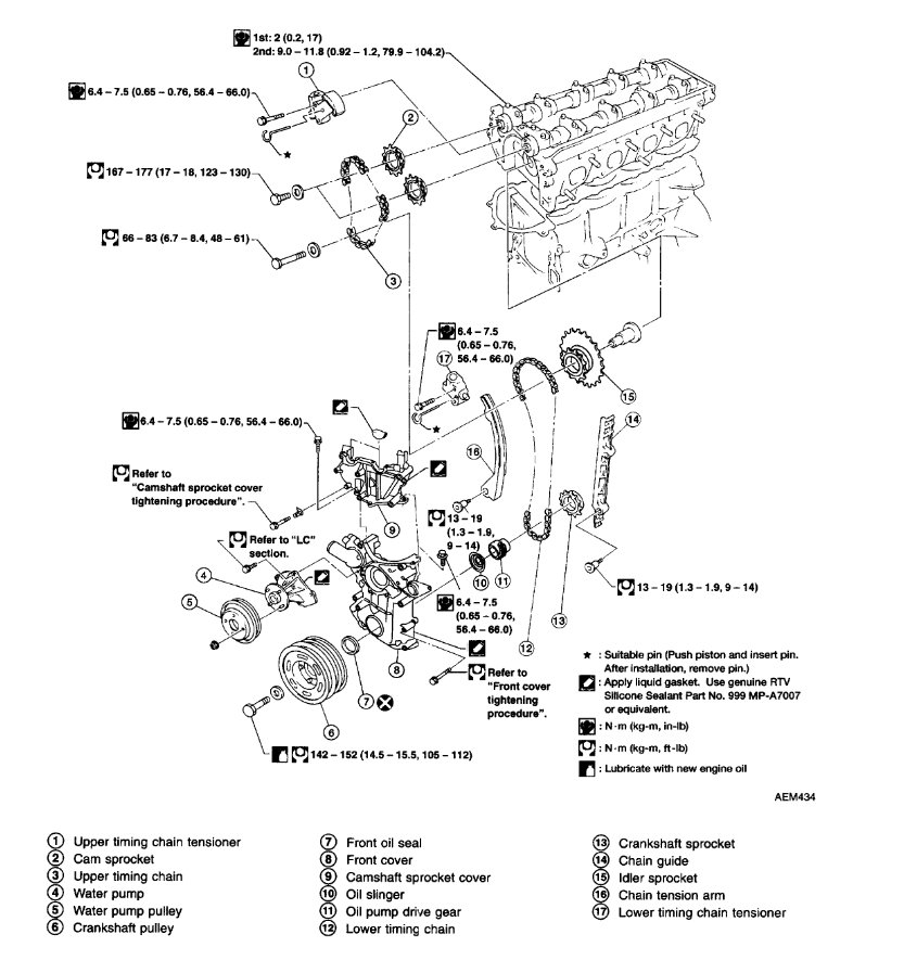

I pulled the cylinder head off for resurfacing and didn't think to make sure where the crank was for retiring. I just let the lower chain fall when I took it loose now how can I time it up?
Aug 6, 2022 at 1:23 PM
MARK SCHEIDER
The cam gears both have two marks on each gear. Which mark do I line up with the colored links?
Aug 7, 2022 at 1:23 AM
SQM
  • 6,383 POSTS

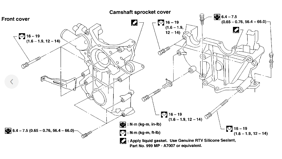

You will actually have to remove the front cover and line up the lower sprocket and the cam gears in a sync.
