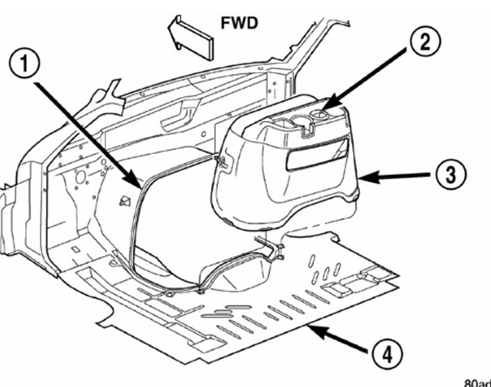

Do you have a doghouse removal procedure?

1. engine cover seal
2. ash receiver
3. engine cover
4. floor pan
1. remove screws attaching holddown brackets to floor pan.
2. Disengage latches from dash extension.
3. Remove engine cover from vehicle engine cover.
