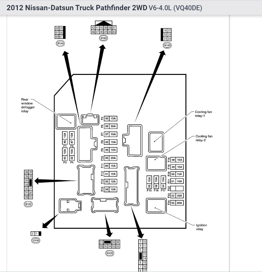

We were driving and the A/C was working fine until the dog hit the auto A/C button and dual passenger button at same time, and now A/C won't work. It's just blowing hot air. Check the ac button and it was still lit, tried turning on/off auto A/C, tried hitting dual button on/off, tried both at same time, changed modes and temps but nothing gets the cold air blowing again. A/C worked great before he hit the buttons. So, is there some way to reset the controls to fix this? Or any other ideas?

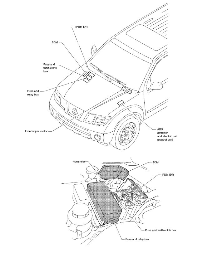

Let's check the fuses and if okay we need to do a CAN scan, these guides can help:
You can get a CAN scanner (Controller Area Network) from Amazon.
https://youtu.be/u-4syLc-ifQ
and
Here is one for about $99.00 if you need it:
https://amzn.to/3ZixY4v
Here are the fuse locations, in the images below. You might have an IPDM that is out. Please let us know what happens.
Mar 30, 2023 at 5:51 AM
DOGPROBLEMS
It was the fuse, thanks for the help!
