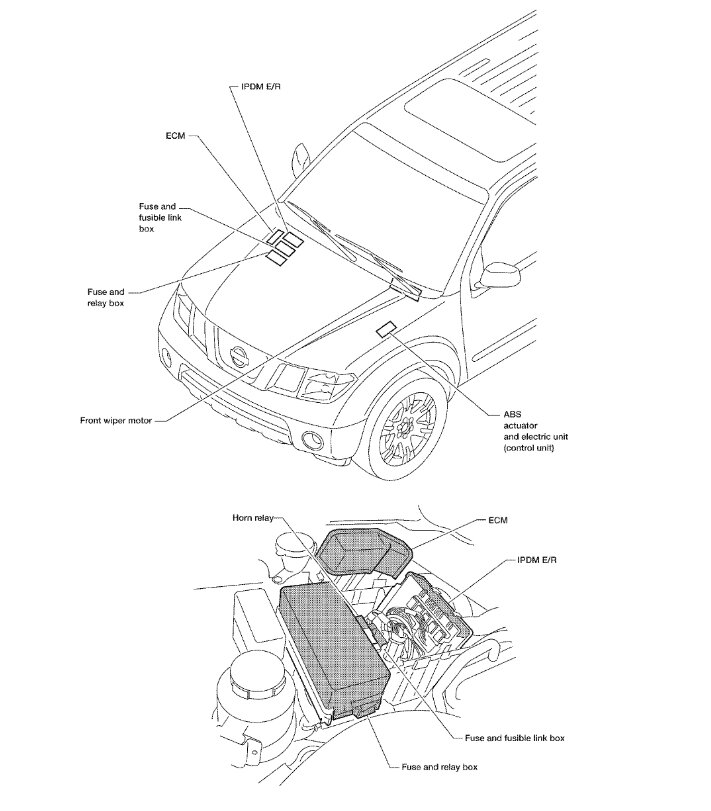

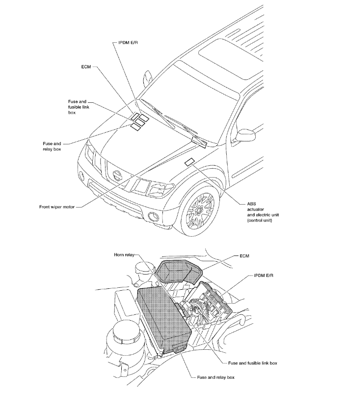

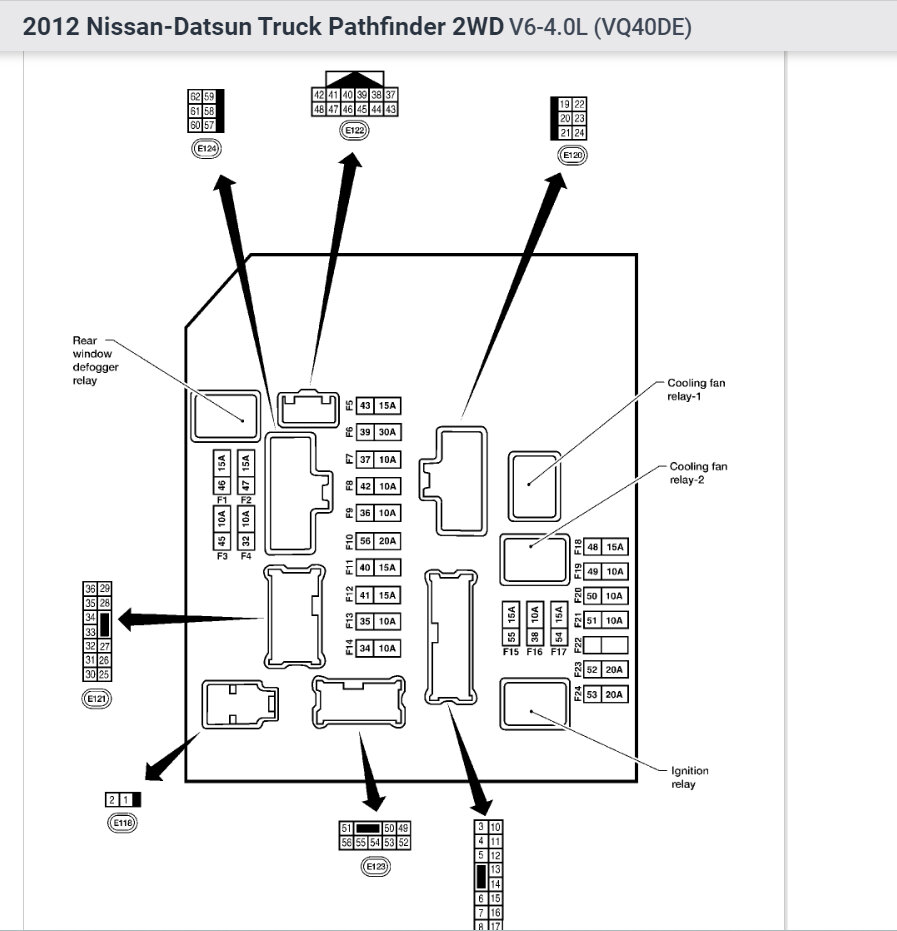

Let's check the fuses and if okay we need to do a CAN scan, these guides can help:
You can get a CAN scanner (Controller Area Network) from Amazon.
https://youtu.be/u-4syLc-ifQ
and
Here is one for about $99.00 if you need it:
https://amzn.to/3ZixY4v
Here are the fuse locations, in the images below. You might have an IPDM that is out. Please let us know what happens.
Mar 30, 2023 at 12:51 PM
DOGPROBLEMS
It was the fuse, thanks for the help!
