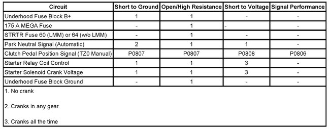

Now, if you are getting no nose from the starter / power to it, here is a flow chart for checking possible causes. Pic 1 correlates with the directions. It will require a scanner for some of the tests.
________________________
2008 Chevy Truck Silverado 3500 4WD V8-6.0L
Starter Solenoid Does Not Click
Vehicle Starting and Charging Testing and Inspection Symptom Related Diagnostic Procedures Starter Solenoid Does Not Click
STARTER SOLENOID DOES NOT CLICK
Diagnostic Instructions
* Perform the Diagnostic System Check - Vehicle prior to using this diagnostic procedure. See: Vehicle > Initial Inspection and Diagnostic Overview
* Review Strategy Based Diagnosis for an overview of the diagnostic approach.
* Diagnostic Procedure Instructions provides an overview of each diagnostic category.
Diagnostic Fault Information
pic 1
Circuit/System Description
The engine control module (ECM) controls engine cranking based on a power mode input and the status of the park/neutral position (PNP) switch or clutch pedal position sensor. With the transmission in Park/Neutral, voltage at the ECM PNP switch signal circuit is low. This indicates to the ECM that conditions are acceptable for cranking. When a power mode crank request is seen, the ECM applies voltage to the starter relay coil control circuit. This energizes the coil side of the relay, which pulls the switch side of the relay closed, applying voltage to the starter X2-S terminal and engaging the starter solenoid.
Diagnostic Aids
* Inspect the STRTR Fuse 60 (LMM) or 64 (w/o LMM), and the 175 A MEGA Fuse for an open.
* A misadjusted PNP switch (M30 4L60E, M70 4L70E) or range selector lever cable (automatic) may result in a starter solenoid does not click condition.
Circuit/System Verification
1. Ignition ON, transmission in Park or Neutral. Observe the PNP Switch parameter with a scan tool, in Engine Control Module, Data Display, Engine Data. Verify that the scan tool PNP Switch parameter is Park/Neutral (automatic only).
If the scan tool PNP Switch parameter is not Park/Neutral, refer to Circuit/System Testing: PNP Switch Circuit Malfunction.
2. Command the Starter Relay ON with the scan tool, or turn the ignition switch to the START position. The starter solenoid should engage and the engine should crank.
If the solenoid does not engage, refer to Circuit/System Testing: STRTR Relay Circuit Malfunction.
If the solenoid engages but the engine does not crank, refer to Starter Solenoid Clicks, Engine Does Not Crank. See: Starting and Charging > Symptom Related Diagnostic Procedures > Starter Solenoid Clicks, Engine Does Not Crank

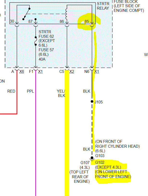

I can use a jumper wire 30 to 87 and the engine cranks but wont run....spray starting fluid in and engine runs but then stops after the starting fluid is gone....still wont crank turning key to start position.....fuel pressure is at 60 psi.
Mar 3, 2020 at 6:33 AM
  • 110,241 POSTS
Okay, by jumping those two pins, you are sending power direct to the solenoid. That leaves two things. Check to see if pin 85 has continuity to ground. If it does, then we may have an issue with the ECM or ignition switch. See pic 1 for ground. See other pics for ignition to ECM .

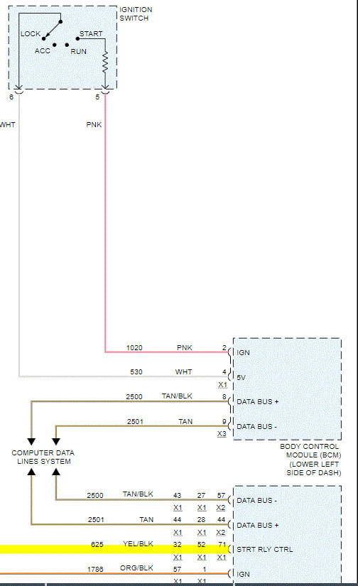

When i hooked up the continuity light in pin 85 the light lit up. so how can i tell if it is the ECM or ignition? I have voltage from ignition to BCM.
Mar 5, 2020 at 4:33 AM
REDBONE
  • 105 POSTS

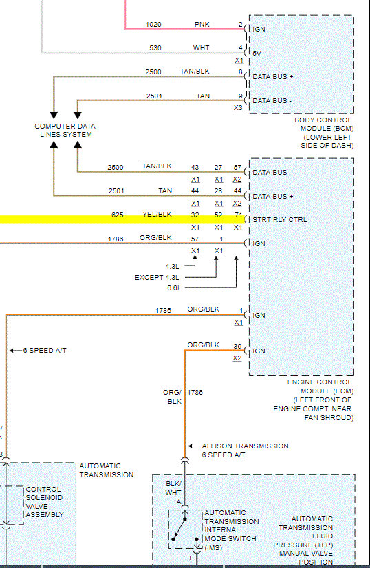

I am getting no voltage from the pink wire going into ECM,but i am getting voltage from red/white wire going to ECM. also, i am not getting 5v reference from the grey wire on map sensor and no 5v reference from tan/black on MAF sensor.The MAP ref. is 1.5v and the MAF ref. is 2.5v.
Mar 5, 2020 at 5:51 AM
  • 110,241 POSTS
The pink wire should only have power with the key in the start position. Is that how you checked it?
Pin 85 goes to ground. Confirm there is a good ground. When using a test light you most likely created your own ground location.
If you checked the relay and know it is good, it there is no power from the switch to the BCM (pink wire) it sounds like the switch is the problem.
