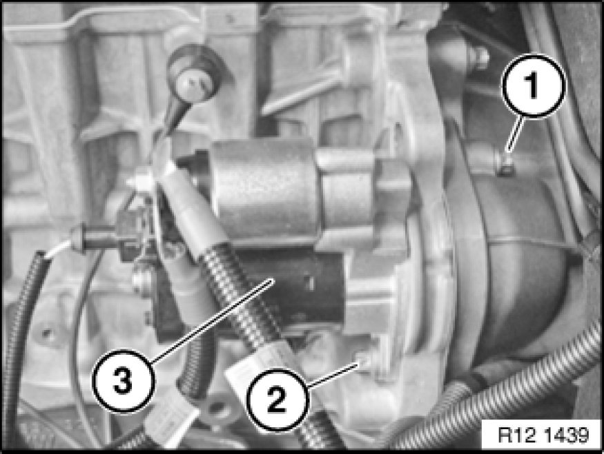

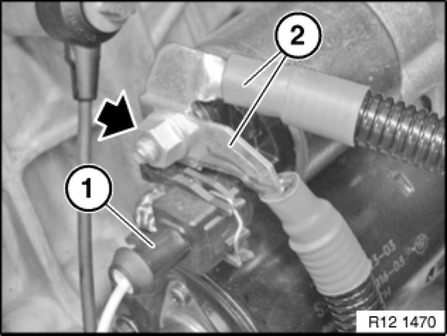

I don't know if you want or need these, but here is a general link and the directions specific to your vehicle for removal and replacement of the starter. I realize it's a bit late for the removal, but the install is here. The attached pictures correlate with the directions.
REMOVING AND INSTALLING/REPLACING STARTER (N52/N52K/N51/N53/N54)
12 41 020 - Removing and installing/replacing starter (N52/N52K/N51/N53/N54)

picture 3
Unlock plug (1) and remove.
Unfasten nut.
Tightening torque 12 41 3AZ .
Remove battery positive lead (2).
picture 4
Release screw (1).
Installation Note:
Replace aluminium screws.
Tightening torque 12 41 1AZ .
Release screws (2).
Installation Note:
Tightening torque 12 41 2AZ .
Remove starter motor (3).
picture 5
Installation Note:
Check starter pinion and ring gear for damage. Replace starter if necessary.
