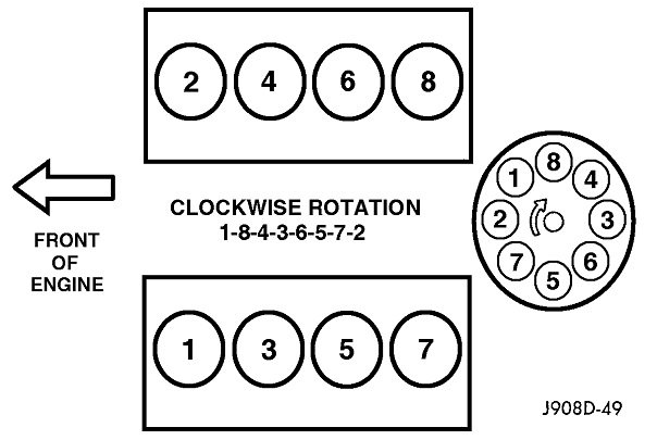

i'm simply looking for the firing order on a 1990 Dodge Ram b350 5.9 liter. fuel pump replaced, fuel filter replaced, fuel lines replaced, spark plugs replaced, wires replaced, distributor cap replaced, rotor replaced. still no run.

1-8-4-3-6-5-7-2
The distributor can only be dropped into place in one of two ways because the end of the shaft looks like the end of a flat-blade screwdriver. It used to be customary to drop in the camshaft's distributor drive gear such that when the distributor was dropped in on top of that gear, the rotor was pointing to cylinder # 1 when that piston was at top dead center on the compression stroke, then that spark plug wire was inserted into the cap right above the tip of the rotor.
To say that a different way, it was normal to find spark plug wire # 1 where this drawing shows wire # 7, then the rest still go in order around the cap. That was more important on older vehicles because the distributors had a vacuum advance unit hanging on the side, and if the drive gear was off by more than a few teeth, that advance unit could bump up against the firewall. You don't have that advance assembly to worry about, so the drive gear can be installed in any orientation. You would still bring piston # 1 up to top dead center on the compression stroke, look where the tip of the rotor is, then install the distributor cap and plug in wire # 1 right over it.
