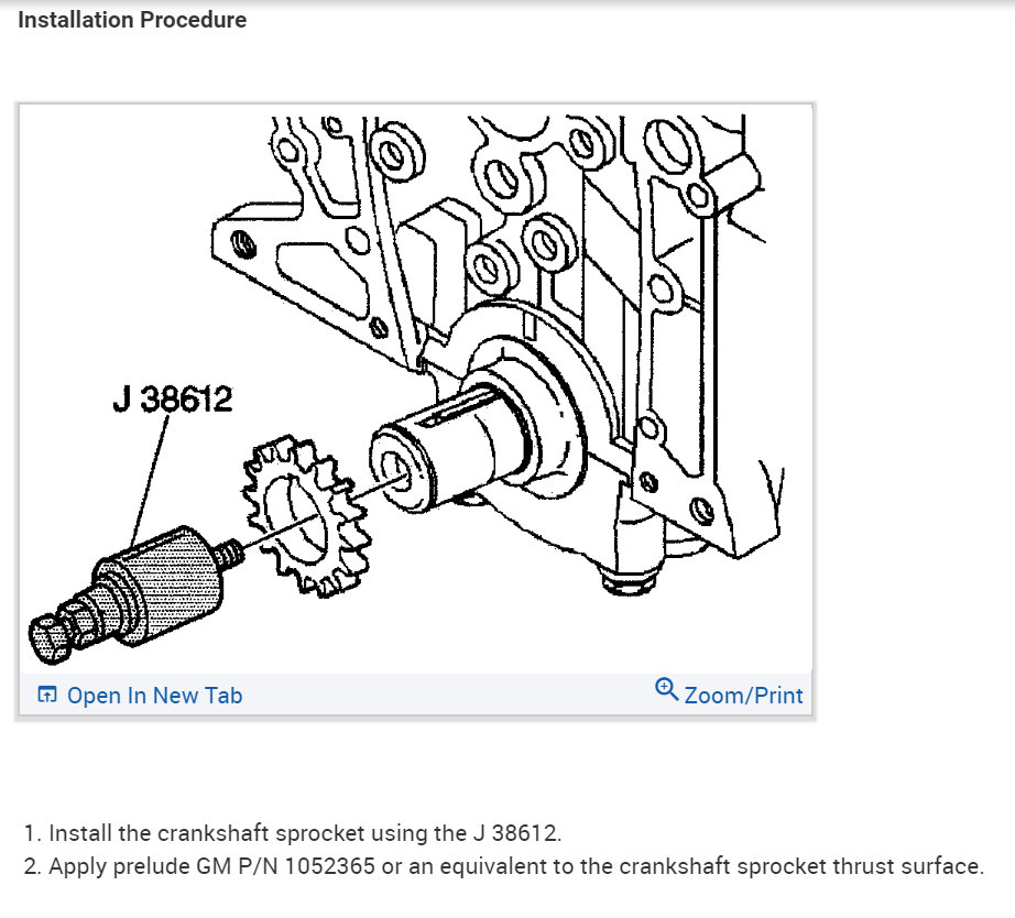

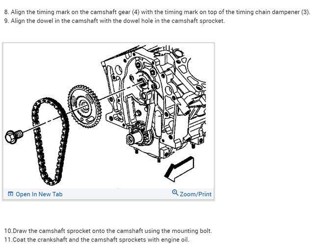

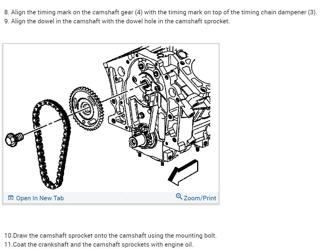

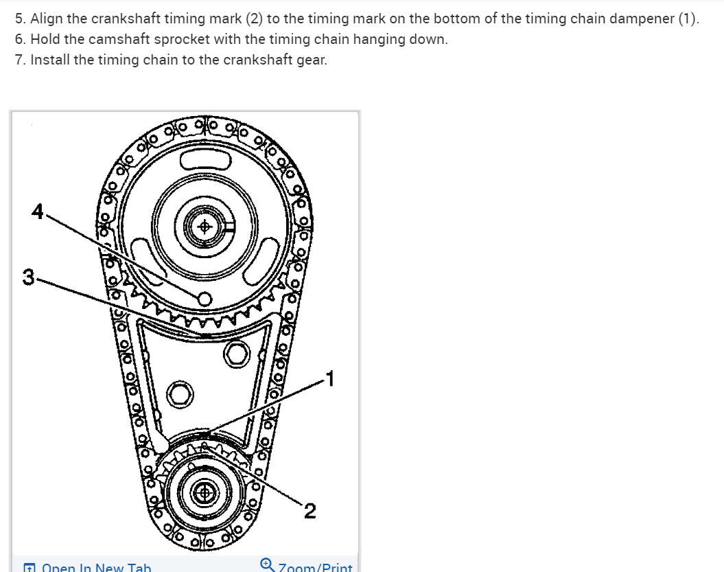

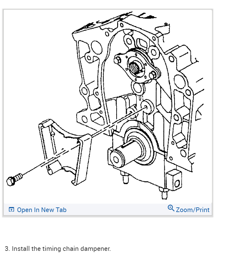

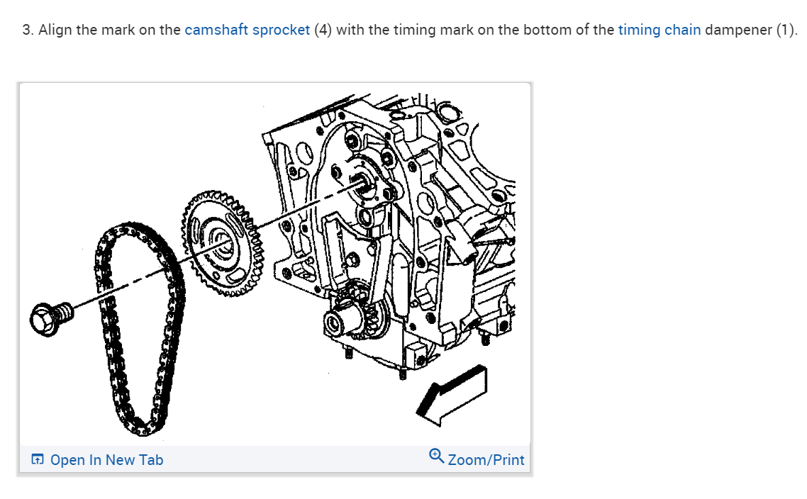

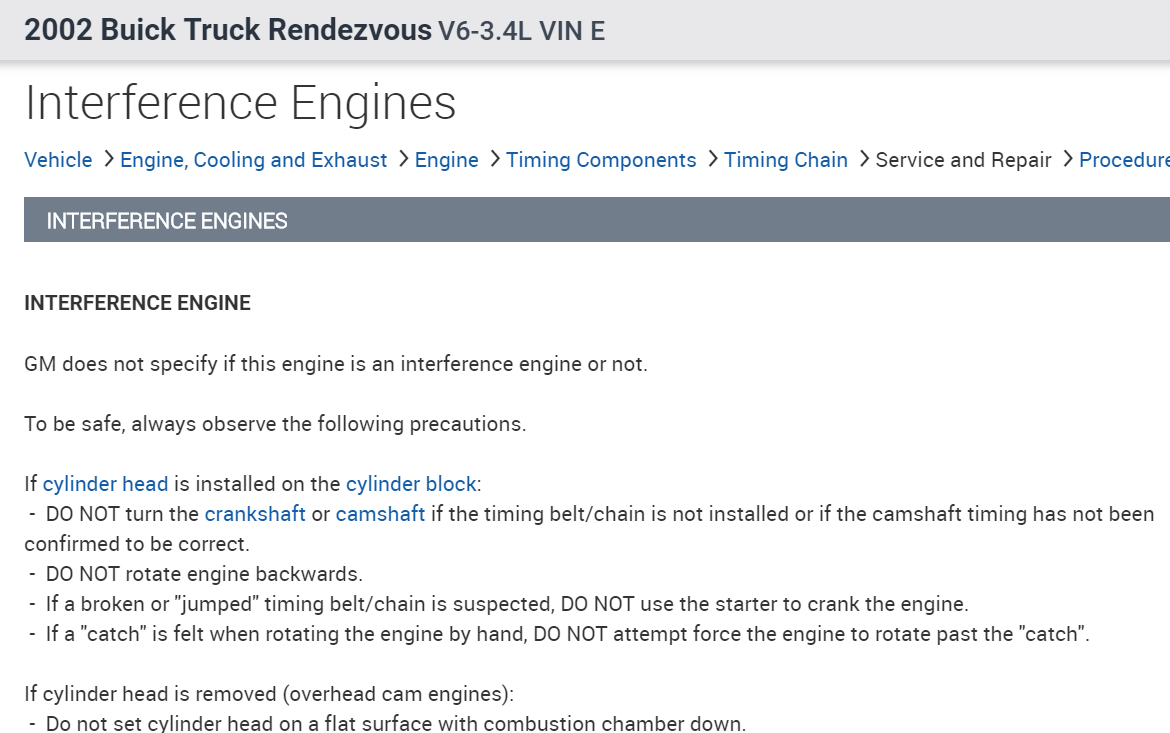

Will not start, backfires every time I try to start it
135,000 MILES • 3.4L • 6 CYL • 2WD • AUTOMATIC
RMARIN
Does this vehicle have a timing belt or timing chain? How do you replace it?
Feb 16, 2019 at 6:28 AM
SCGRANTURISMO
  • 4,897 POSTS

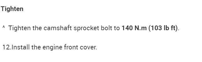

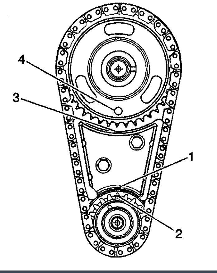

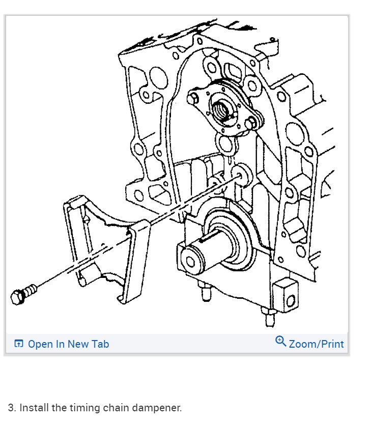

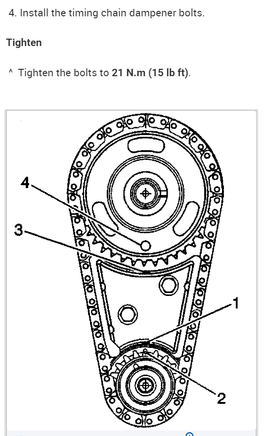

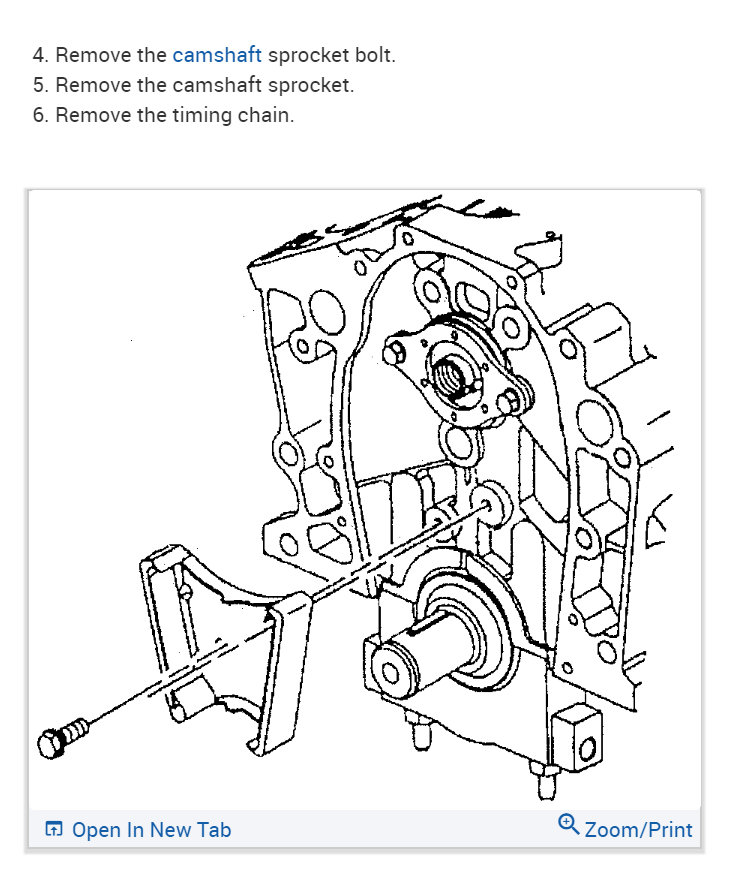

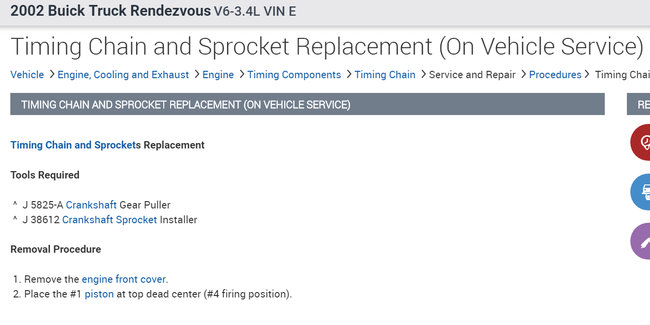

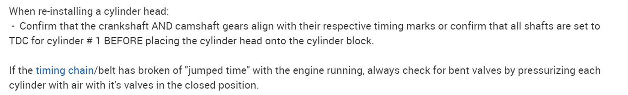

This could be a timing issue. I have included for you the information that you requested in the diagrams below. It is step by step instructions on how to remove and install a new timing chain and tensioners.
