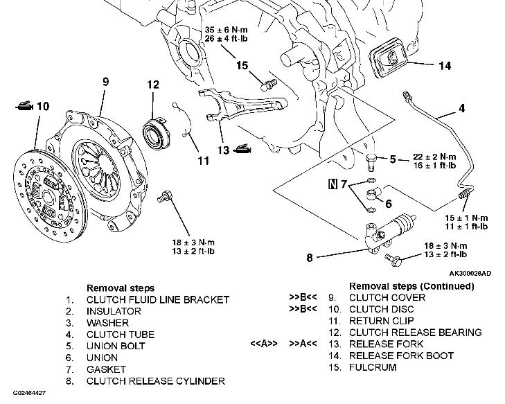

Trying to replace the clutch in my lancer oz rally. does it come out the top or do you drop it out the bottom. thanks in advance

the trans goes out he side and engine has tobe supported. it is to lengthy for us to put on here so either buy a manul or you can rent one for 7 days on here and print instructions out.
