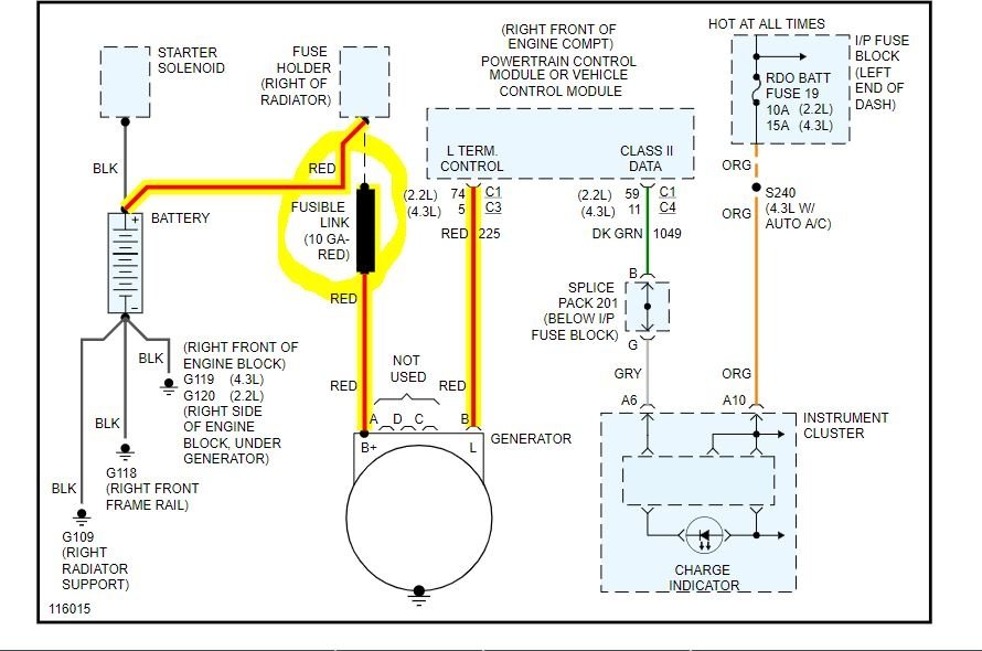

Alternator will not charge battery
1999 GMC SONOMA
175,000 MILES • 2.2L • 4 CYL • MANUAL
JBET98
Does the positive battery cable attach to your alternator or starter?
Jun 24, 2019 at 5:13 AM
Good afternoon,
Yes, there is a battery wire from the battery to the back of the alternator.
I will attach a wiring diagram for you to view. Check the alternator for power on any other wires.
